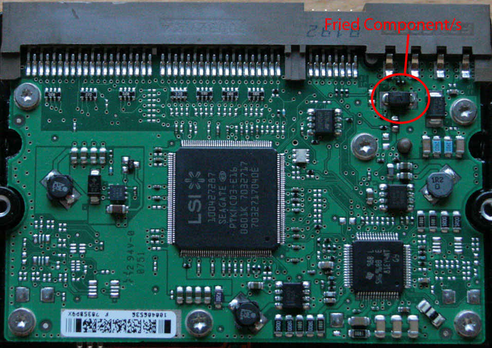

Hi Guru's,
I have a Seagate Barracuda with what I suspect is a failed TVS. I have searched both this forum and the web extensively for disassembly instructions for the PCB on this drive and can't find any. I am an experienced service level tech but am concerned about connector types and procedures to reduce risk of damage to PCB or connectors.
Can someone please provide me with instructions/information on PCB removal for this drive type. Also can someone confirm that the fried component indicated is the (I geuss 5v as it is smaller) TVS for this drive and if so recommend a suitable replacement component.
After searching the web and this forum extensively it appears my diagnostic process should be as follows, please inform me if this is correct:-
1. Remove PCB from drive and de-solder/remove one leg of the fried TVS.
2. Re-install and test
3. Works - Great recover data
4. Doesn't work - :o( try replacing PCB [have sourced a replacement on e-bay] and cross fingers

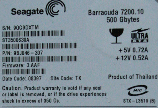

The drive spec and pics are as follows:-
500 GB 7200.10 ST3500630A 9BJ046-307 3.AAF TK 08397

Just remove the TVS and the drive should work. If it doesn't, there is further damage to the PCB which will require replacing with a suitable donor.

TKS for the quick response CK,
I take it from your response that the fried component is the TVS. Can I just cut the legs without removing the PCB???

If you feel physically able, then sure. Or desolder to avoid potential damage to the PCB.
Also I would not recommend reattaching the HD to the same power supply as it was before.
