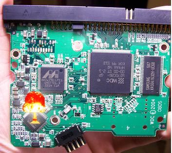

for your case:
If you want to save the pcb too, use one 0.5A fuse for the 5V line and simple replace the pcb and try to get the data, and drop the drive away.
if the fuse is blown, the preamp is gone, sure.
If the fuse still good, but the drive don't want to init, only clicks, than only a pro can help you.

1. you can't do a reasonable test without really expensive tool. The FUSE technique is good enough for you to protect the pcb, but not the data!
The bad/damaged preamp can destroy the data inside the drive.
2. the SMART is NOT in the PCB, this is stored INSIDE the HDA!
3. Read BlackSt's answer. :D

1.SMART - last thing, inside - got it.
2.Head preamp will burn data if its malfunctioning on read attempt, MBR ? for example or worse. - got it.
3.Just to show what have bee scorched, attaching photo of exact same model WD1600JB-00GVC0 with mushroom.
4.How much should i bargain for, what your expertise on that rescue mission. London based.
Thank You.
S.
File comment: WD1600JB-00GVC0 PCM
