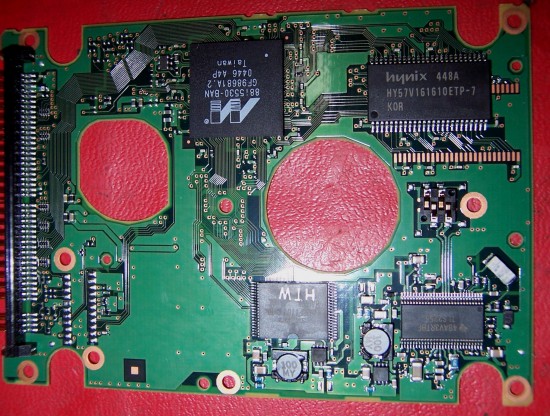

I have swapped board from the good 60 gb drive and I now hear motor running,, the original board has a problem,, suspect power surge ,, If I can swap the correct chip I can likely recover the data but I need to know which chip..
here is an image of the board,, I can not see any 20 pin chips..
Skybill
File comment: here is the board layout

I said TSOP 40 ;)
anyway, google is your friend finding datasheets. Some of the ICs U won't find the datasheet, but for the ROM, surely.

Sorry Pepe,, Guess I should use my reading glasses,
I WILL be using them to replace the IC...
There is only one 40 pin chip on the board,,
that should simplify things,
I will have a go at replacing it..
as stated,, this is a learning experience
Skybill
