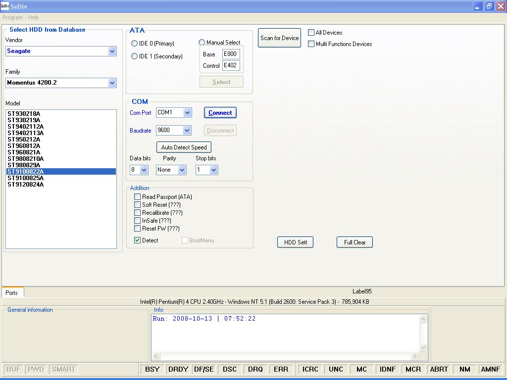

I believe the password is stored on the platters, not on the PCB.
The solution provided in this thread entails reading the Vendor Track. You can use SeDiv to do this.
SeDiv Seagate Terminal:
http://sediv2008.narod.ru/Easy1014.rar
English documentation:
http://sediv2008.narod.ru/HelpEn.rar
See this thread:
sediv-hdd-seagate-terminal-for-windows-t11980.html
In order to get SeDiv to run, you may need to wind back your system date to the date stamp of sediv.exe.
You will need to access the drive via its TTL RS232 port. To do this, you can use an adapter such as the ones described in this thread:
http://forums.seagate.com/t5/ATA-and-Se ... 036#M19464

SeDiv 2008 , not support this hd :( :oops:
I would take a second look if I were you :shock: Roll on Ray :lol:

HELLO PEOPLE! one more time ! sediv not support st3250312cs,and st3250310cs.
help pls , and can i use the cable rs232_to _ttl .or a a CA-42 cell phone cable ?? help pls, and the dku-5 , (noka) , can i use this work ?
