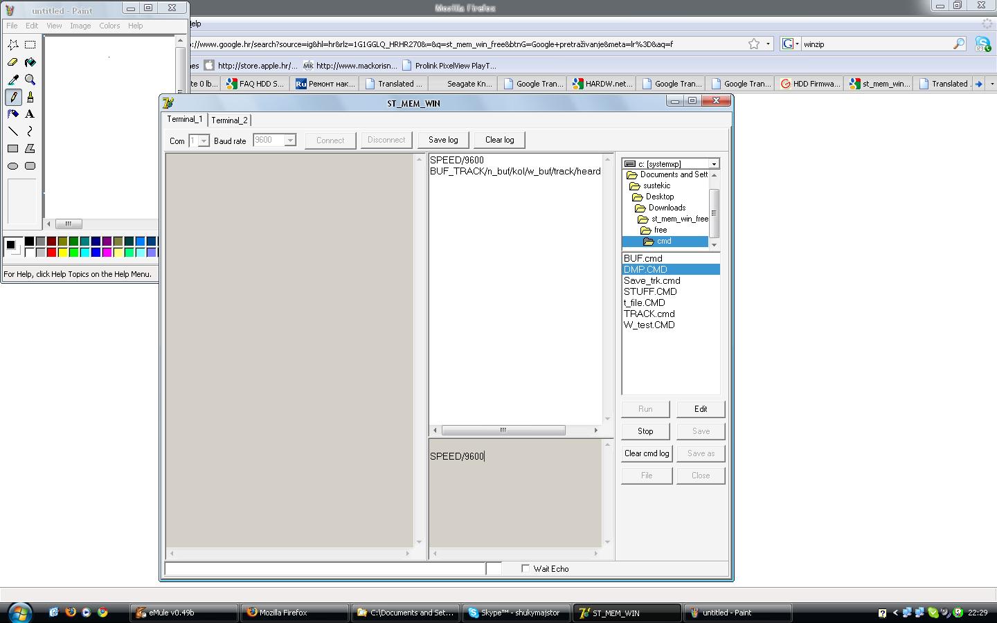

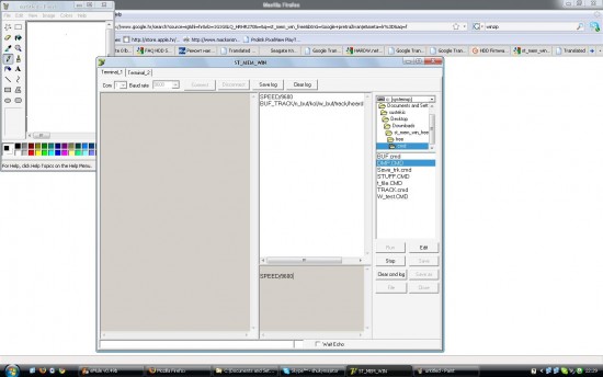

Shuky wrote:
Yeah, for about 3 years ago, when hdd shows first signs of failure, i put them to the freezer ,then i connect him to motheboard,and start coping the data to another hdd...:=)
PCB, must be same firmware? 3.04?
I try to work with this program, i connect to com1, but when i select script adn hit "run" nothing happend!!
why..?
with hyper terminal i get status from hdd and everything is ok...

Ok, i bend PCB and it is recognize, but it seems that is Locked, HIGH, a dont remember that i put password on it..

is this it?
T>Pgm=00 Trk=0EDD7(0EE57).0(0).240(000) Zn=9 Err=00 ErCt=0000 Hlth=0018 CHlth=0000 Ready LBA=00000000
how to i read this track to obtain my password?
