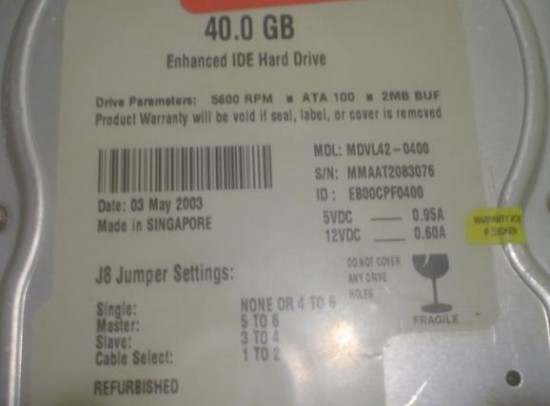

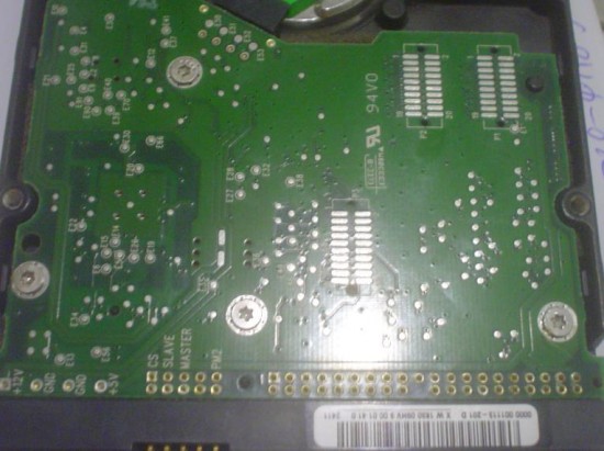

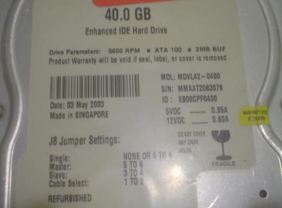

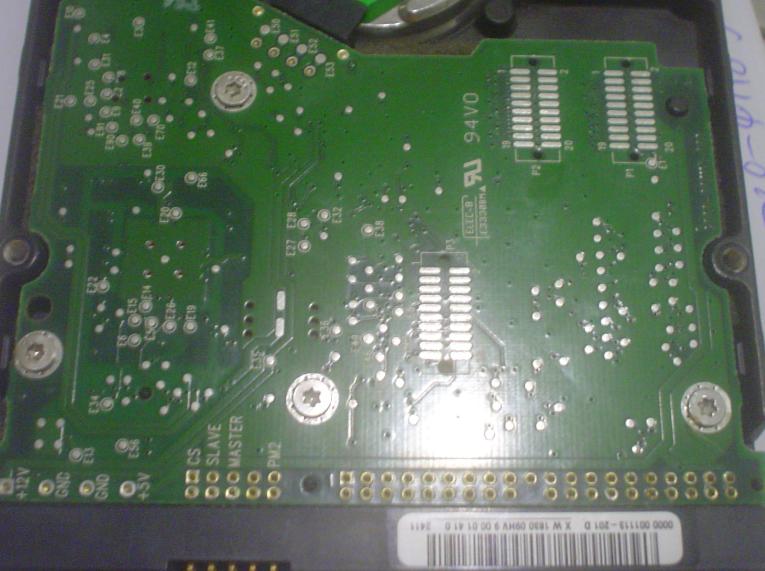

Hi to all!
Head 0 god
Head 1 bad
How I make to know which donor with heads compatible?

those letters are the most important 00CPF0 look for the last 4
