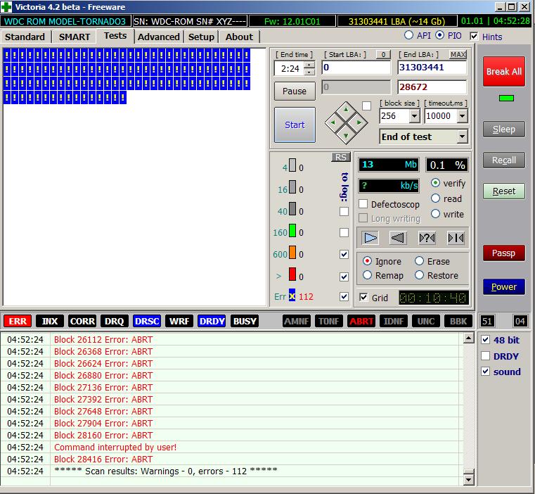

 Post subject: WD5000AAJS - capacity 15GB, detected as TORNADO3....
PostPosted: August 11th, 2009, 15:58
Joined: February 4th, 2009, 8:21
Posts: 18
Location: Poland, Lodz

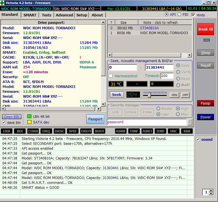

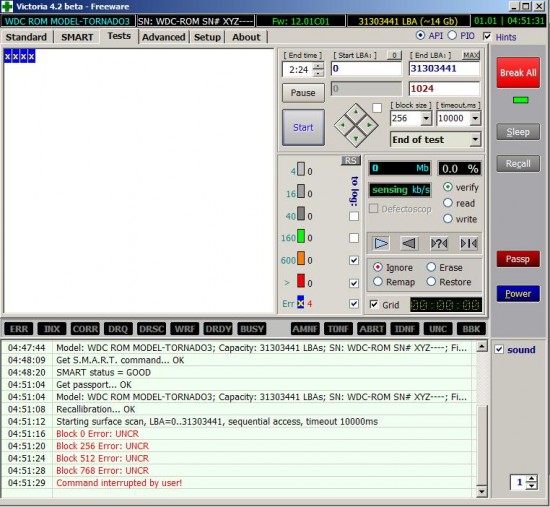

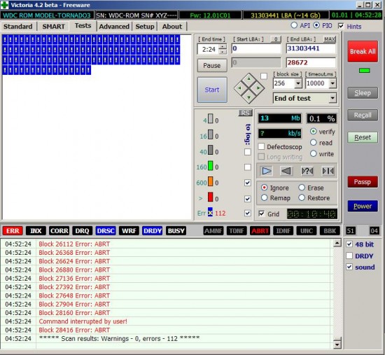

No access to data. Windows is starting very slowly with presence of disk. Disk detected as WDC ROM MODEL-TORNADO3. Trying scan with MHDD (see all "!") and trying to set HPA but no effect. Attached screens of Victoria.
On top cover is written:
WD5000AAJS - 22TKA0
DCM: DHNCNV2AHB
LBA: 976773168
Disk detected at Windows Device Manager after "Scan for nwe devices...". Recognized LBA by Victoria is wrong. How to set good capacity?
Is it translator modules damaged...?

 Post subject: Re: WD5000AAJS - capacity 15GB, detected as TORNADO3....
PostPosted: August 11th, 2009, 16:27
Posts: 1493
firmware is bad or single head failure. beyond your capabilities.
PostPosted: August 12th, 2009, 0:49
Joined: June 8th, 2006, 19:44
Posts: 3144
Location: Atlanta, GA
Could also be PCB failure, which can mimic bad heads.
PostPosted: August 12th, 2009, 4:08
Banned User
Joined: January 28th, 2009, 5:50
Posts: 84
Location: united kingdom
PCB.
PostPosted: August 16th, 2009, 0:00
Joined: April 10th, 2007, 9:53
Posts: 335
I think I've seen more of these come in clicking that ended up being the board than I have the heads being bad, especially the AAJS drives.
