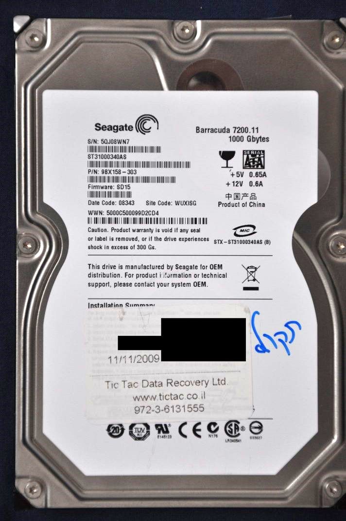

i have the following hard drive:
- Seagate barracuda 7200.11 1tb
- ST31000340AS
- Firmware: sd15
- Series: 7200.11
- P/N: 9bx158-303
- Site code: wuxisg

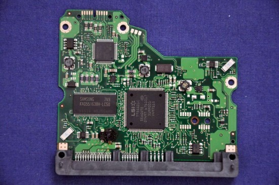

i'm quite sure i had a short circuit on the PCB after (in my stupidity) i plugged in the hard drive to the computer while it was on!
i then heard some noise and smelled some burned smell.
after that - the computer refused to boot at all while the Hard drive was plugged in.
i then plugged out the hard drive and it boooted succesfuly
i guess the motherboard or the power supply do not respond when the PCB on the hard drive is short circuited
i took the hard drive to a DR company - and they gave me an extremely high quote which i cannot pay :(
i'm trying to deal with it on the old way - maybe swapping the PCB would fix this issue.
i have tried to search google about swapping PCB's - but there are so many opinions so i need to know for sure some things:
1. would swaping the PCB in my case might solve this issue - and saving my data?
2. if so - what exactly should i be looking for when searching for a matched PCB?
for example: should i be looking for a matched site code, P/N firmware? are they important for the match to be successfull?
3. can you point me to a decent place where i can buy these spare parts?
thanks in advance
roy

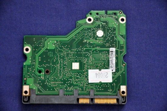

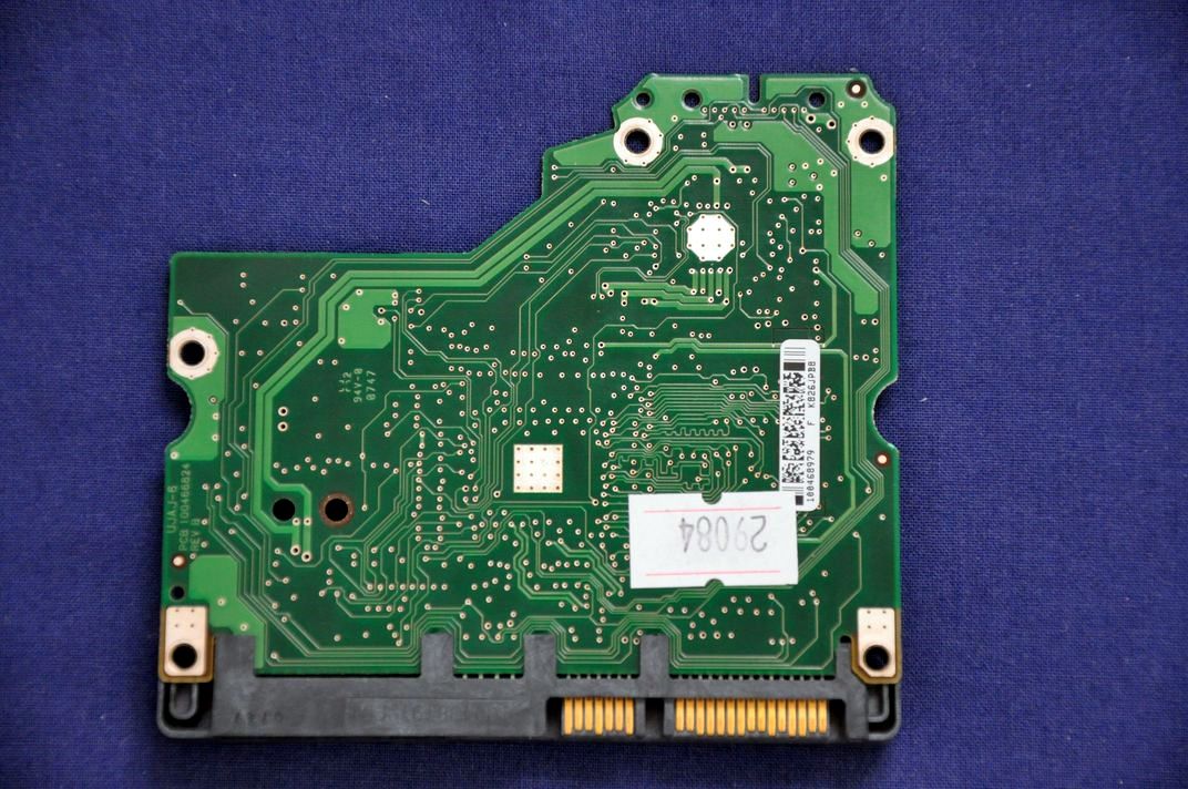

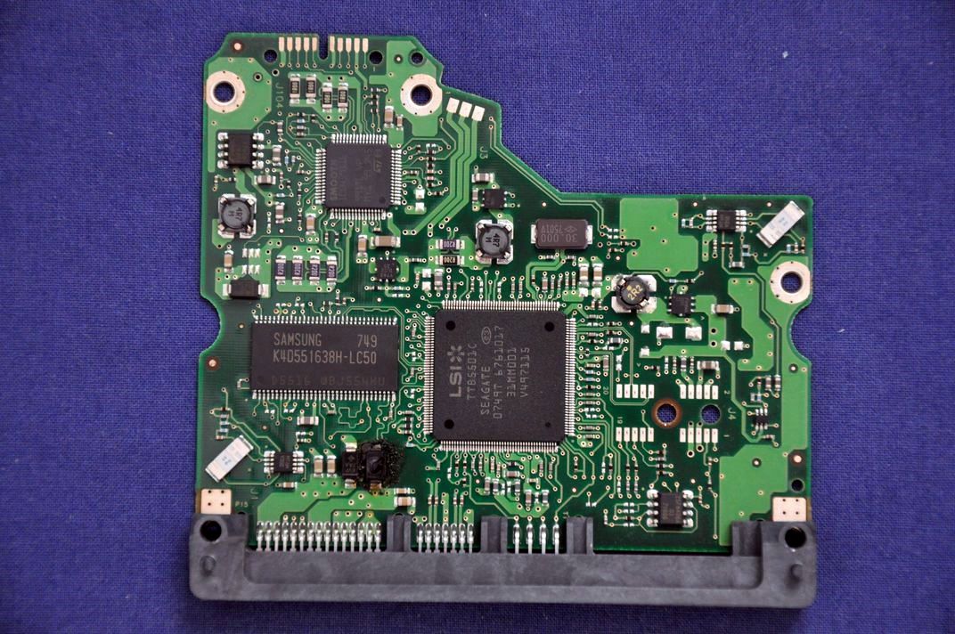

Hi, Search the forum for 'TVS' so you understand what their function is and why they might fail. I can see one of yours is 'smoked'.
If you are very very lucky you will soon have easy access to your data.
Don't attempt to remedy the situation if your soldering skills are poor but find a competent techie to do it for you.

A direct PCB swap on Barracuda 7200.11 series is not possible. The ROM chip has adaptive information on it which must be transferred to the donor drive. Unless you are good a soldering I do not suggest you do this yourself as if you damage the ROM chip all your data will be inaccessible.

Before spending money on a new PCB that may not work for you due to the adaptive info, research TVS on this forum!!! You might get lucky and that could be the only damage on your PCB...
Otherwise, you may have to contact a data recovery firm (not the local computer repair shop) in order to get your data back.
 Post subject: Re: Would PCB swap for my dead Seagate 1tb 7200.11 work?
PostPosted: July 21st, 2009, 13:55
Worth a shot to remove or replace those two damaged TVS.
But attach only to a known GOOD QUALITY power supply, as the protection provided by the TVS's will be gone.

pcimage is right!
problem is solved by removing completely one of the TVS's
so clean & simple.
thank you pcimage you have just saved me 500$

Hi ,
Good ,Please Replace a New TVS In That Drive ,Might Be Next Time you Plug it directly It Just Blows The Circuit :mrgreen:

Hi, can someone please point out exactly which chip is the rom chip that needs to be transplanted? I can see 2 small 8 pin chips, one smaller than the other, I know it is one of these two, just don't know which...
Digital Don
PostPosted: August 10th, 2009, 10:54
Posts: 1493
I think its the top right. Chip usually has ST written on it. Why are you swapping the rom? whats seems to be the failure? make sure you diagnose it before attempting anything! And dont lose than ROM!
