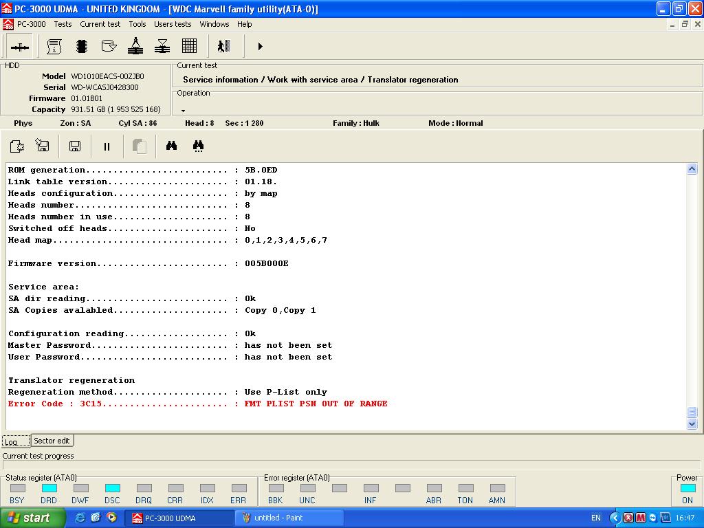

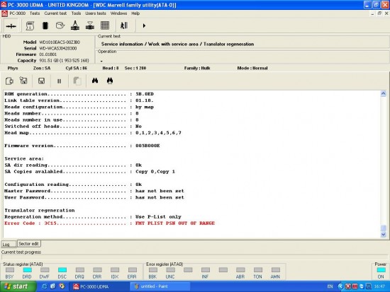

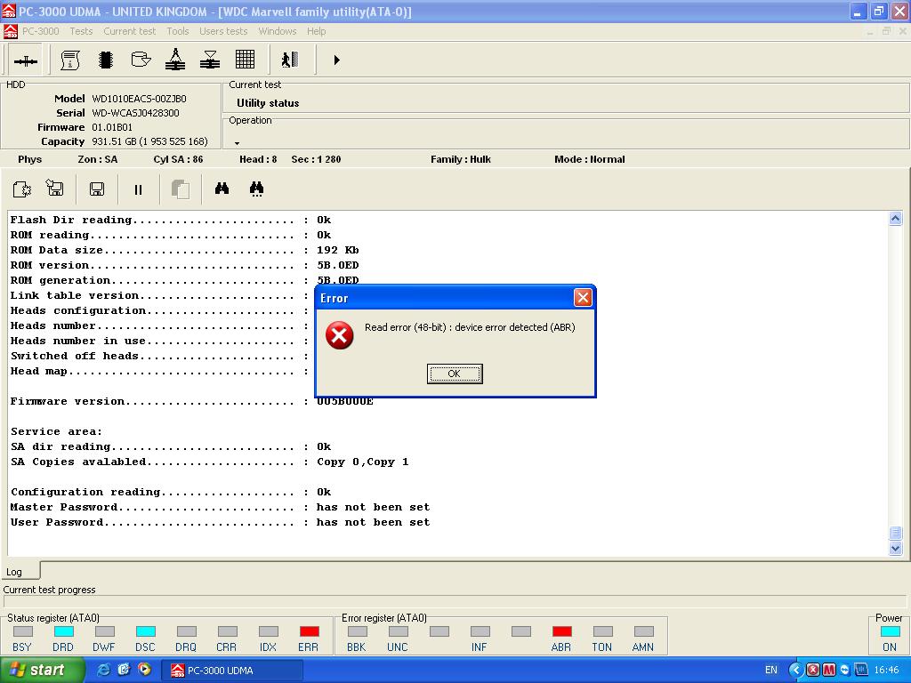

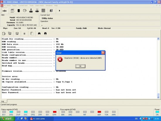

i got problems with wd drives.... not one drive..... not two ......
drives ID OK
all modules readable OK
tracks OK
Problem is coming when im trying to reach user area. (ABORT ERROR)
PLS SEE ATTACHMENT PICTURE.
cant read any sectors.
normally when drives user area is not readable it mean there is an issue with SA, translator.
what to do when all SA checks are correct?
when i tried to regenerate translator i had message- P LIST OUT OF RANGE.
PLS SEE PICTURE.

I would guess that one of the heads has failed preventing translator loading. test heads.

whats interesting heads test is saying that all are ok.
