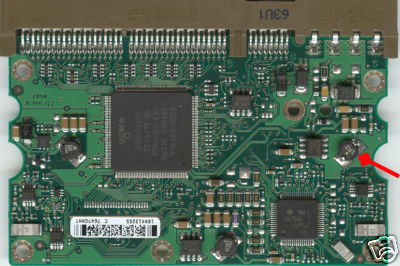

 Post subject: Re: Seagate Barracuda 7200.10 PCB
PostPosted: November 24th, 2008, 6:49
Joined: November 23rd, 2008, 18:44
Posts: 8
here an image of the pcb, I am not really sure if that round thing is the TVS. ....thought those are the rectangle ones.
this part (red arrow) is completely fried, all others seem/appear ok.
I just got a disk with the same specs, except for the type of main controller IC. Otherwise the number of the board, FW, PN are the same.
Would this work, or would it not work at all. Disk is still sealed, so, in case there is not a relistic chance to revive my fried HDD, I would not break the seal.
thanks
PostPosted: November 24th, 2008, 6:54
Posts: 2984
the TVS is the black square component an inch or two above the part you have highlighted, just to the left of the top right screw hole.
PostPosted: November 24th, 2008, 6:55
Posts: 8
but what is that round part that is fried....guess this board itself cannot be repaired???
Posts: 2984
Your fried PCB has a code of 100404195, what is the code of this new PCB?
Also, do you have the equipment required for soldering the 8 pin ROM chip over to the donor PCB?
PostPosted: November 24th, 2008, 9:28
Posts: 8
fried PCB No: 100406534 (barcode)
controller chip on this pcb: 100404195
new PCB board No:100406534 (barcode)
controller chip on this pcb: 100408287
do I need to replace the ROM? the FW s identical on both boards!!!
PostPosted: November 24th, 2008, 10:18
Posts: 2984
Just swap PCB, you may be pleasantly surprised 8)
post your results here

I exchanged the PCB and the HDD is still not working. It is spinning up, but is not recognized at all.
Here the data again>
HDD:
Modell: ST3320620A
Firmware (FW) 3.AAE
Productnumber (PN) 9BJ04G-305
DateCode: 07155
Site Code TK
Thailand
fried PCB No:
100406534 (barcode)
controller chip on this pcb: 100404195 (ST)
new PCB that also does not work:
100406534 (barcode)
controller chip on this pcb: 100404195 (agere)
taken from HDD with following parameters:
Modell: ST3320620A
Firmware (FW) 3.AAE
DateCode: 08355
Site Code TK
Thailand
Can anybody please help me. I am desperate, really need the data. Do I still get the wrong PCB. Or what would be the next step. I onlz need the data. Once I got the data, I don't care about the HDD.
Thanks in advance......please help.....
tae
PostPosted: December 13th, 2008, 20:04
Joined: June 28th, 2008, 0:37
Posts: 225
Location: San Francisco Bay Area www.harddiskcrashed.com
Potentially a wrong controller chip as in ST vs. Agere.
Your new PCB is from a drive that is significantly newer, based on its datecode.
Matching PCBs can be a pain.
Then again, you may have the right PCB, as the disk spins up, but you may have other damage. Wrong ROM, damaged firmware, damaged preamp/heads. Those are listed in order from bad to worse in terms of costs to recover and require specialized software and knowledge to correct.
