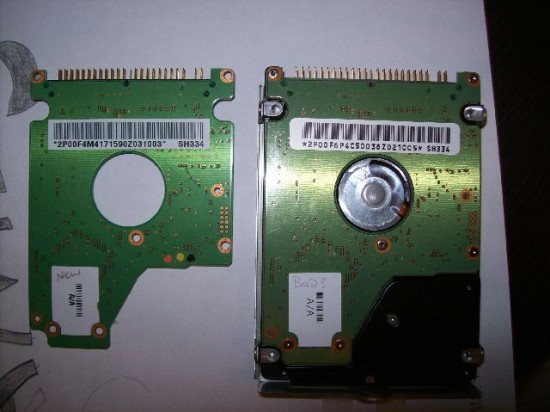

UPDATE:
Ok. I ordered a PCB from Eric and it arrived today. I very carefully did the swap (cold). Unfortunately, all i got was the click of death. Which seems like good news and bad news. Bad obviously in that I wasn't able to just spin up the drive and get my data. But it was good in that at least the drive was spinning, which is way more than it did with the old pcb.
With the old board the drive never even attempted to spin up, so it seems reasonable to assume that the pcb is actually my problem? I suppose it's possible that the replacement pcb is not correct?
I would sure appreciate any suggestions or ideas. Should I just keep looking for another replacement PCB?

Do the white stickers on the PCBs match exactly or not?

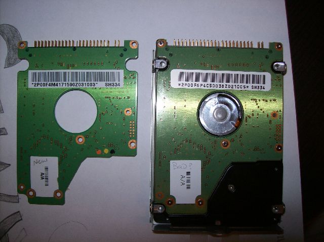

Nope. Original, then replacement... :(
*2P00F6P4C50038ZD21005* SH334
*2P00F4M4171590Z031003* SH334
I even took a photo of the PCB that I was replacing. I guess I needed to be more specific with my posting in the "Buy / Sell / Trade" forum.
If anyone has a PCB they would be willing to part with for a reasonable $, please let me know.
Thanks,
Chris Hackett
File comment: The original (bad) PCB is on the drive, the new (incorrect?) PCB is on the right.

The sticker that needs to match is the one marked A/A. You are matched there.
Also check the sticker on the front of the drive. Underneath the model number there should be a code like: A/A0A0 A/A. These should also match, IIRC.
IC5 on the PCB contains the firmware code.
If everything matches and you still have clicking, I'd conclude that whatever killed the PCB also killed the preamp.

Thanks! The A/A as you mention definitely matches as you pointed out. I guess since I only got the PCB, and not a whole donor drive, there's no corresponding sticker on the PCB to correspond with the A/A0A0 which is printed on the front of the drive casing.
It's also interesting that the replacement PCB has "MC60" stamped onto IC5, where you mention the firmware is loaded, and on the failed drive it's stamped "MC62"
I guess we're onto trying to locate a donor drive so I can do a head swap. Any Donors?

Well, the heads may be good. You've got a firmware mismatch. Need to find a PCB with MC62 on that IC, or else swap the MPU (hoping that it is good, because a bad one will cause the drive not to spin, too) or figure out the original problem with the original PCB.

A retired, former service tech used to say, "look under the streetlight," i.e. go for what is visible first.
I don't see many of these drives, but I think they have SMT fusible links to protect the PCBs, and I'd locate and check those with a VOM first.
A SMT fuse may have a tiny 2 on the front. That stands for 2 amps, not 2 ohms.
If they have little 0's printed on them, they should measure shorted.
You'll need to find someone in the ATL area with SMT gear if a MPU swap is indicated. Norman's Electronics?? Don't forget . . . a bad MPU will cause your symptoms, too.

On the FA series, adaptive data is stored it the MPU. With some other Hitachis (AA, BA, etc) the adaptive info is stored on the platters.
Your best bet at this point would be to try swapping the MPU and hoping it's not shot.
