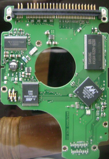

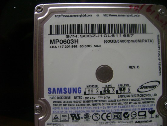

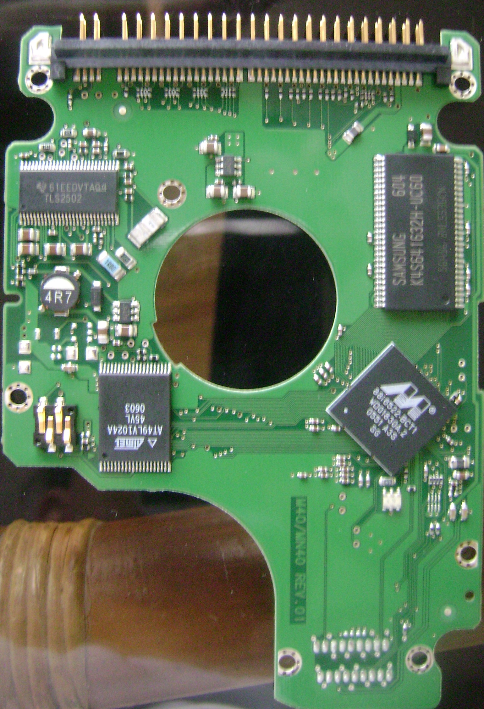

When i connect the disc in PC-3000 not spin up. TVS problem? See pictures... where are the tvs in this picture?
thank,
Carlos

The problem is "elsewhere"... Check what really happens in terminal (if happens) or registers................

I've seen a few motor IC failures with Samsung drives. Heads may also be on platters.
