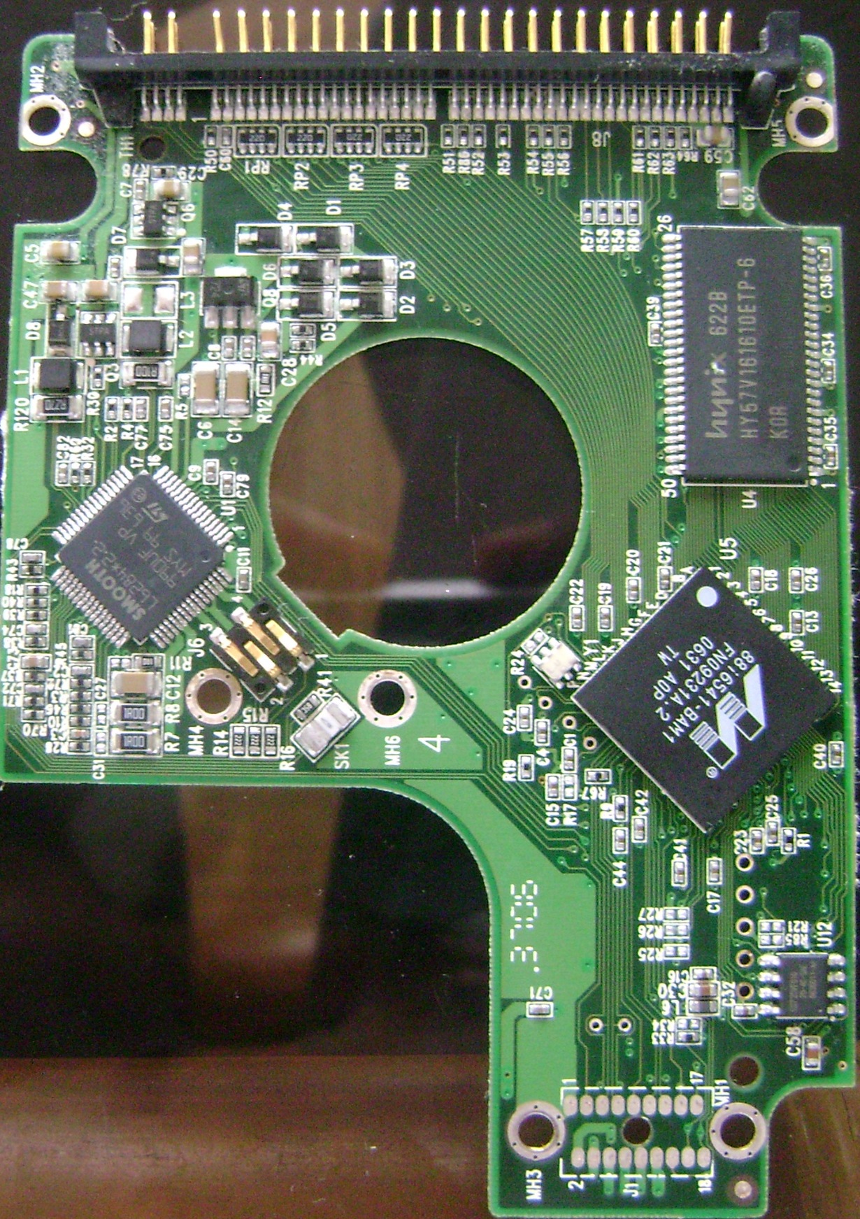

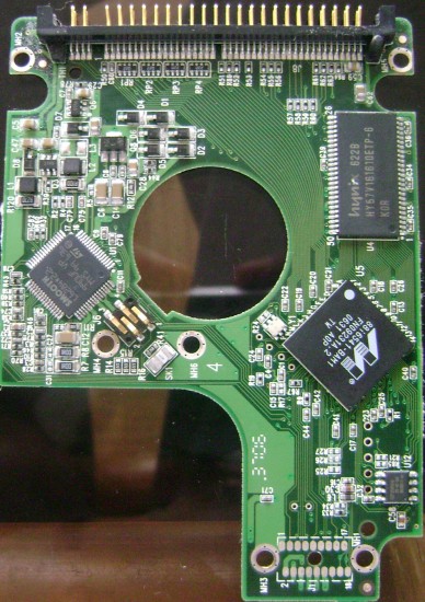

When i connect the disc in PC-3000 not spin up. TVS problem? See pictures... where are the tvs in this picture?
thank,
Carlos

More likely:
1. Heads stuck on platter or in ramp;
2. Smooth IC bad
3. Fuse open

Test diodes D3, D4 with Digital Multimeter

Diodes D3=1.3 (200 k) D4=1.3 (over 200 k)

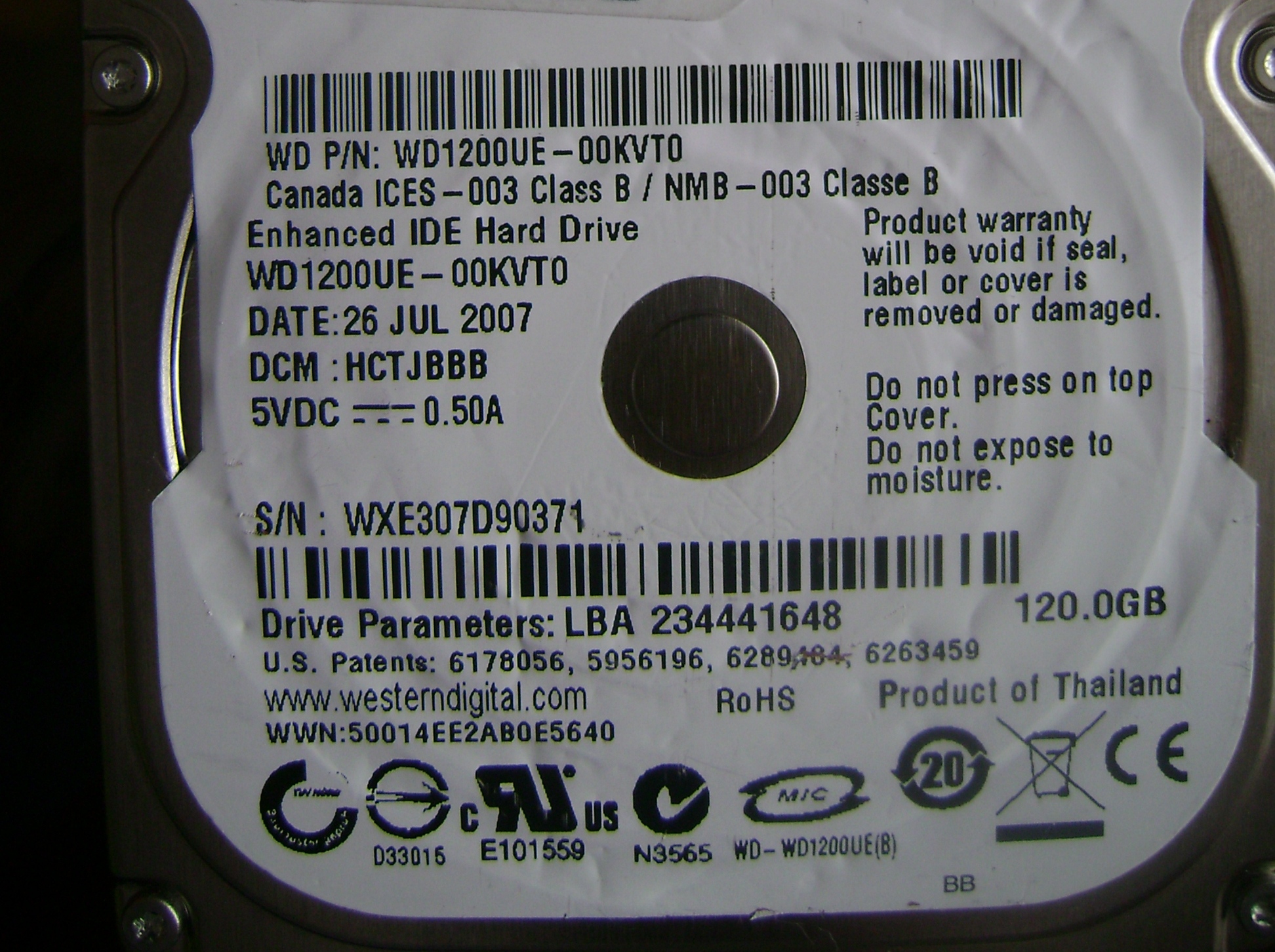

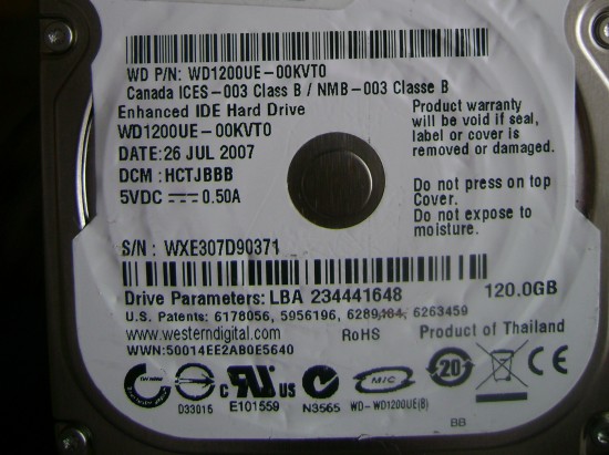

Something looks very wrong to me.
The manufacturing date on the label is 26 July 2007.
However, the date code on the PCB suggests week 37 of 2006 (3706).
The MCU's date code is week 31 of 2006 (0631).
The RAM is 622B and the motor controller is 636.
