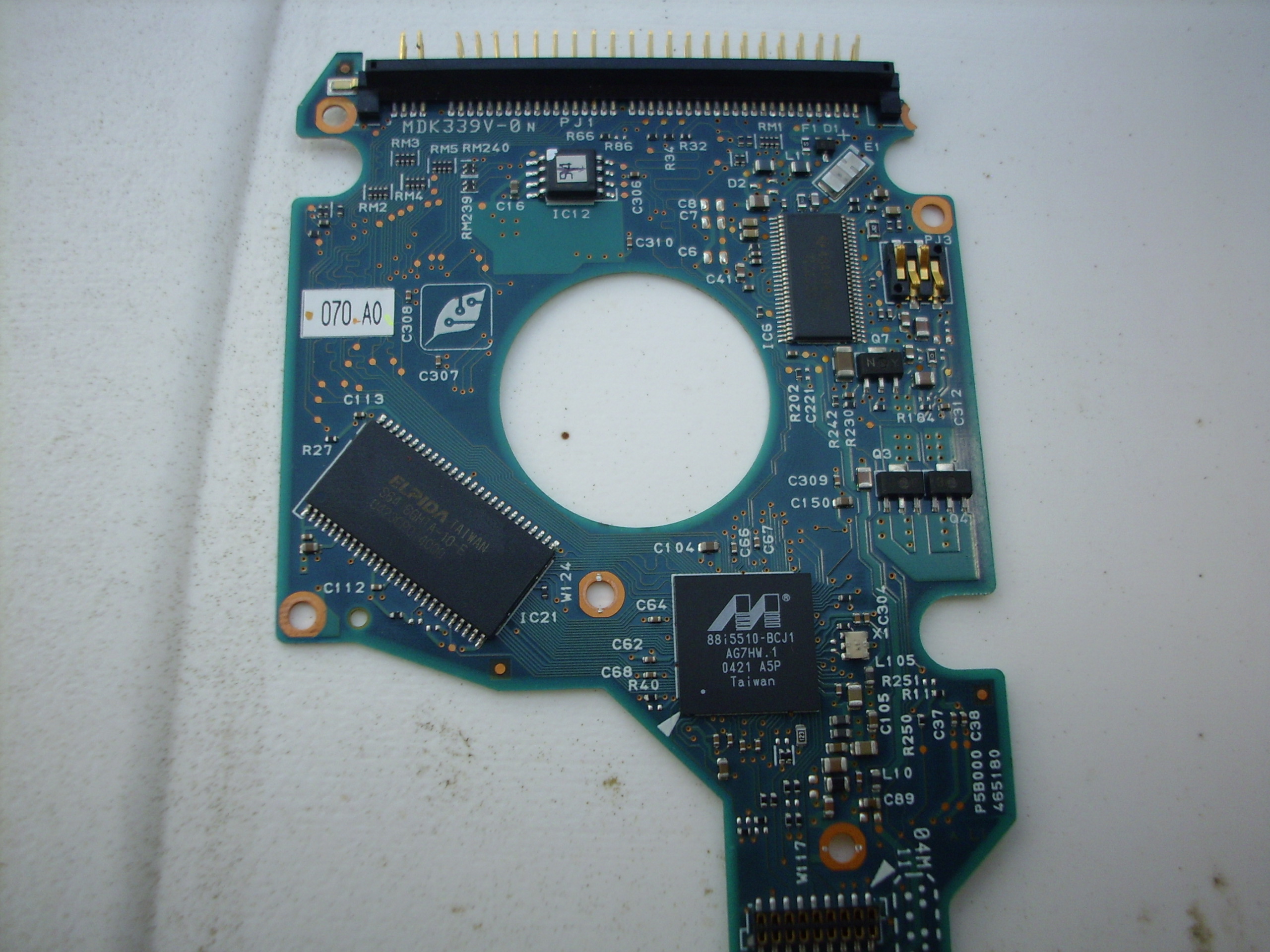

As stated, I am trying to revive a Toshiba HD 2188 hard drive. It is a MK8025GAS B ZE01 T. ( This is my friend's hard drive, he can't afford a data recovery place, so I am doing my best here) Here is the story. The laptop got some water on it, and then all it would do is a continuous booting cycle. I Have his identical laptop, so i tried his hard drive in mine, and it pretty much did the same thing. I tried to run checkdisk, and it said " it has one or more unrecoverable errors" The hard drive would not spin on startup. I located a PCB, with the same model and firmware number that I stated, the only difference being the the controller chip. My controller chip is 88i5510-BCJ1, the controller chip in the new board is 88i5510-BCJ. I installed the new board, and pu it in the laptop. The laptop would not recognize a hard drive being installed ( it did with the old board) but the hard drive spun up and ran without a problem ( which it did not do with the old board) This is where I am now. I am trying to locate a board with the same controller chip now. Given what I have done so far, could I possibly recover the info on the disk?

Jono is right about this one, I haven't looked at one of those PCB's for a while. If you want to be 100%, post a pic of the PCB

Here is a picture of the board....

Ok, if all I need to do now is change out IC12, do I still need to get another PCB with the same controller chip? The original board is 88i5510-BCJ1. The one on the new board is 88i5510-BCJ. Both boards are MK8025GAS B ZE01 T, same firmware. If the eeprom is switched over, does the controller chip matter?

I've read a few other post here and on another forum where swapping the IC12 chip to the new board has been successful, so I will try this. I just need to know if that controler chip needs to be the same # as well. If so, I need another board. if not, the donor board I have now should work. That is where I am sitting as of right now.
