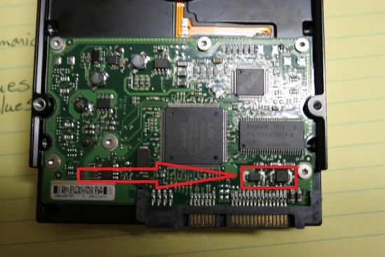

I accidentally plugged me Toshiba laptop into my removable drive. I pulled the drive from the case and tried to access it from an apridcorn adapter with no luck. I plugged another drive to the case and it worked fine.
I found this site and it appears to be either my pcb board or TVS. Can anyone help me locate the TVS? None of the chips seem to be fried visually. I don't have the equipment to test it.
Can someone tell me which chips are the TVS?

The two black rectangles bottom right. They should NOT be short.

hi Doug,
here you are.
