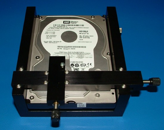

I'm working on a prototype tool for helping to realign opened WD drives. It's still in the testing phase. See below.

Why "tools" ? :mrgreen:
