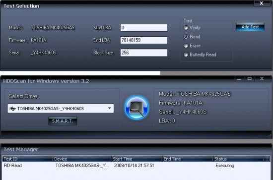

Can I update the spindle driver of the PBC? It is recognised by hddscan in a usb port?
 Post subject: Re: Toshiba MK 4025 GAS
PostPosted: October 14th, 2009, 16:07
Posts: 1466
Location: Europe, Hungary
:mrgreen: :lol:
Spindle driver is a hardware chip. :mrgreen:
Additionally, you can't update nothing through USB, except the user area datas.
Janos
PostPosted: October 14th, 2009, 18:06
Posts: 489
Indeed, spindle driver is not a driver as in graphics card drivers, etc. It is a chip on the pcb, that overheats/dies when put under too much stress (from the spindle being stuck, unable to move ,etc)
sometimes it can work the other way around, where the spindle driver dies and this is why the spindle does not spin, but not in this case.
