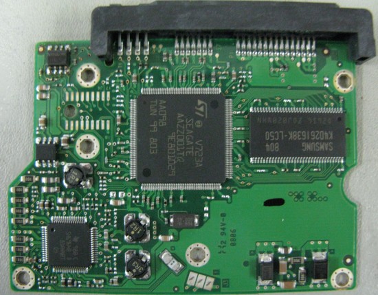

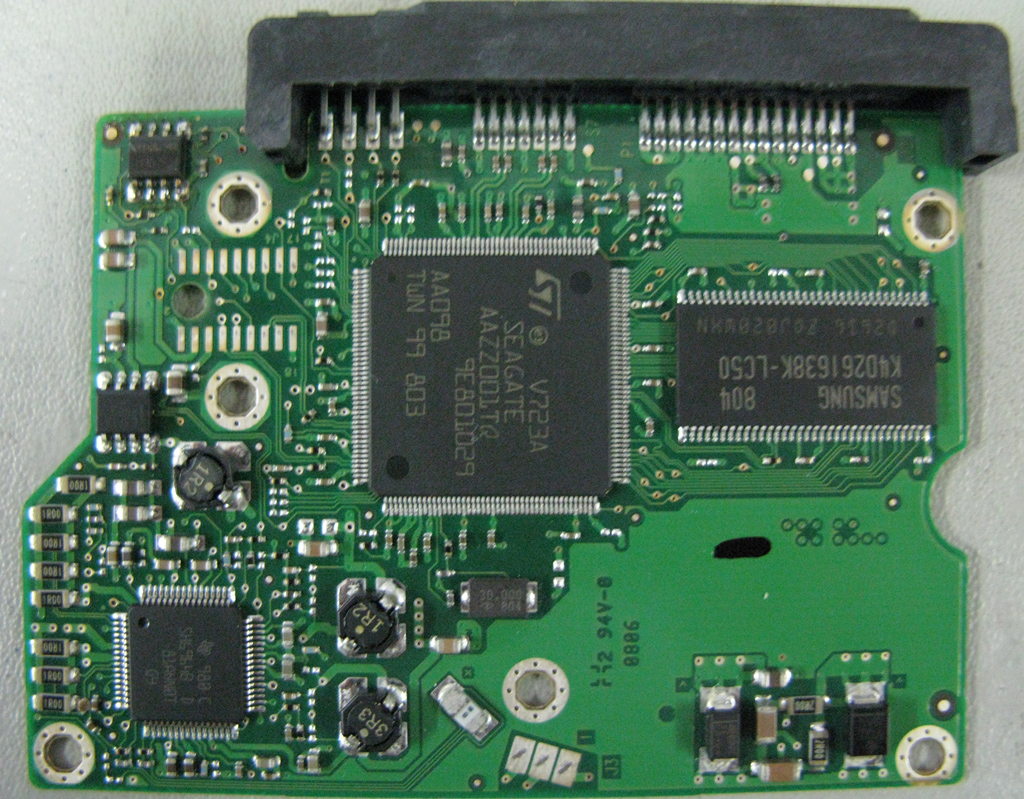

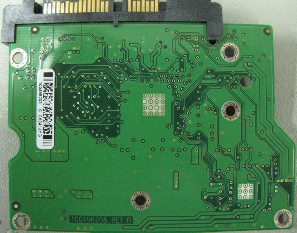

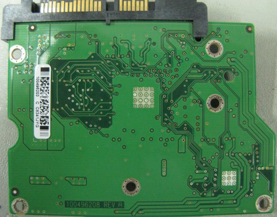

Anyone got ST3320613AS PCB for sale ?
PCB must be exactly as shown, there are 2 different kinds, the newer ST3320613AS uses LSI, the old one has ST.
Thanks, PM me.

Can anyone confirm that different MCU has the compatible ROM? Patient MCU has ST chip, donor has LSI chip.
Donor PCB with Patient ROM = no power
Patient PCB with Donor ROM = no Power
Donor PCB with native ROM = power on
thanks guys
