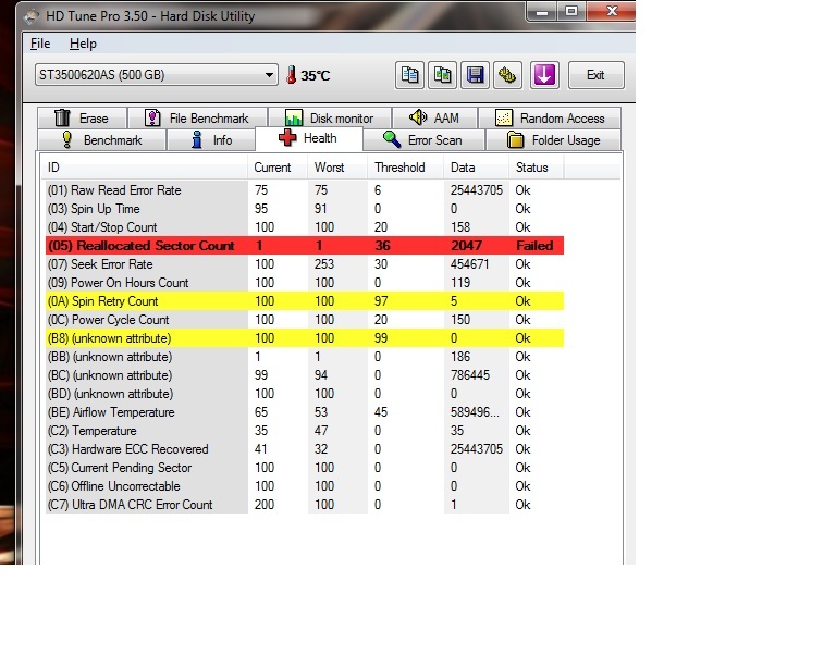

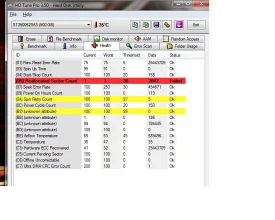

 Post subject: Re: Seagate ST3500620AS firmware mess
PostPosted: October 14th, 2009, 18:58
Joined: September 26th, 2009, 6:32
Posts: 9
Location: macedonia
Russwinters wrote:
I have a hunch that SMART was tripped because of reallocations.
:( And i think i saw that in some SMART report, i'll look for it and upload :(
Any idea on what to do ?
p.s. It was a "dead man's switch".... it had to go off at some point.
PostPosted: October 14th, 2009, 20:08
Posts: 17107
You have 2047 bad sectors which have been successfully reallocated. They are the reason for your SMART failure. You should backup your data and replace the drive.
Attribute 0xBB is indicating 186 "Reported Uncorrectable Errors".
Attribute 0xBC is indicating 13 Command Timeouts.
The latter's decimal value is 786445, or 0x000c000d in hex. I believe Command Timeouts is a multibyte attribute, and that the actual number of timeouts is 0x000d (=13).
BTW, it appears that HD Tune's author examines only the lower 32 bits of each 48-bit attribute. Perhaps s/he is not aware of the existence of the upper 16 bits.
The meanings of each attribute are discussed in the following article:
http://en.wikipedia.org/wiki/S.M.A.R.T. ... attributes
