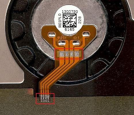

Hi to all,
I Have a case that i have 2 disks that have burned the PCB because of the water.
I Have donor PCB, but the motor "stick" it have been degraded by the water.
What can i do here in this connectors, if someone happen this before can share with me please.
I think this model for platter swap they are not so good.

You can solder 4 wire to the spindle's solder points and to the pcb directly.
This will work, it that is all the problem.

are u sure the drive internals are free from the water?
 Post subject: Re: HITACHI HDS725050 KLA 360
PostPosted: October 17th, 2009, 7:39
Posts: 1421
Location: EUROPE
I can not guaranty 100% that the water enter the drive, the one place that i see is the filter place.
When the water had contact with the PCB it should have a SC and the PCB have burned in some chips.
Is possible that when the PCB get burned or SC the pre-amp get damaged or the motor get damaged also ?
When i open one disk and i see 10 HEADS 5 plattes ....... wow ..... anyone haved change heads or plattes in this model with sucess ?
ZeBong
" Россия еще раз"
PostPosted: October 17th, 2009, 14:22
Posts: 1466
Location: Europe, Hungary
1, check the water entered or not!
It is important, before start.
2, preamp is more than safe than not safe fortunately.
3, heads changing, it is not a problem.
But platters.... uhm... :D
Janos
PostPosted: October 19th, 2009, 8:09
Posts: 1421
Location: EUROPE
Hi Janos,
I check the drive and the only way to enter some water it was by the filter in the cover.
But inside the disk and the filter is clean so i think the water as not there.
ZeBong
" Россия еще раз"
PostPosted: October 19th, 2009, 13:08
Posts: 1466
Yes, i think too.
Now you can replace the pcb and move the NVRAM, solder the spindle, and get the data. ;)
Janos

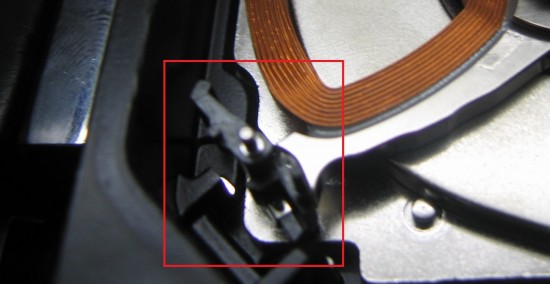

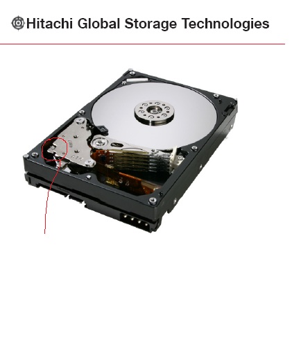

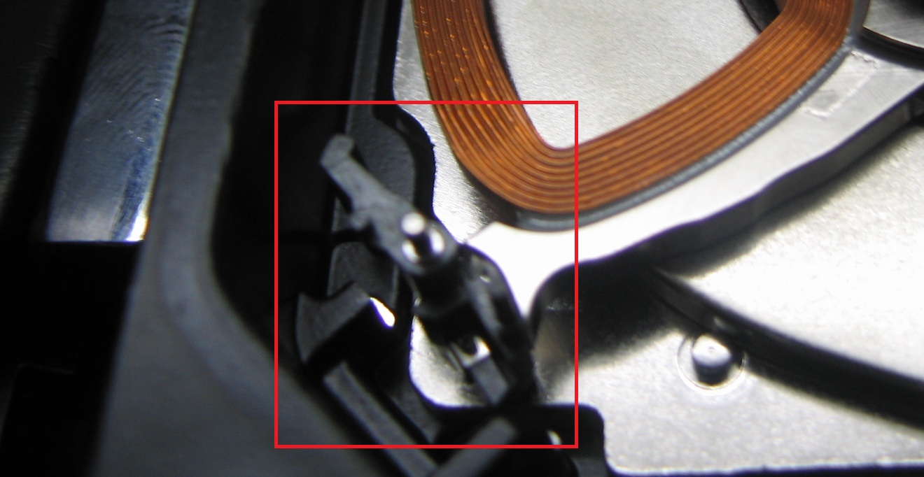

Open the disk and notice this plastic thing :
Is this really necessary for this disks working ? :x :x :x
ZeBong
" Россия еще раз"
PostPosted: October 24th, 2009, 8:12
Posts: 1466
did you broke it? :)
This is a limiter and protector as well if i am right.
You have more disks, so i think the best if you replace it before start...
Janos
