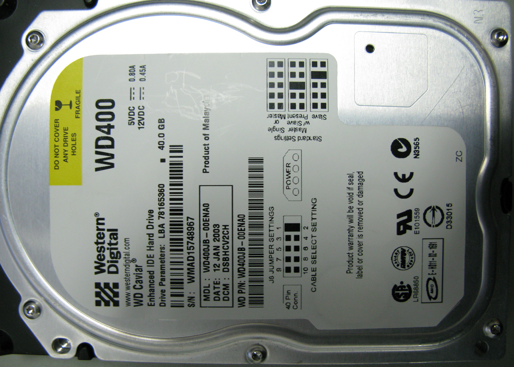

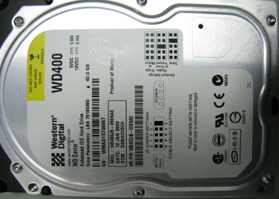

Hi guys
I have WD400JB-00ENA0 where the preamp is damaged. I tried head exchange but unsuccessful, is this type of drive has alignment issues? If yes , why when i put the donor back it works fine, i tried this with 4 donors same problem.
Both patient and donor matched headpmap 0 1, however some donor have "default headmap" and some "from map"
Patient platter (single platter) seems to be fine, no scratches.
Could this be incompatible preamp or something else?
Thank's guys.

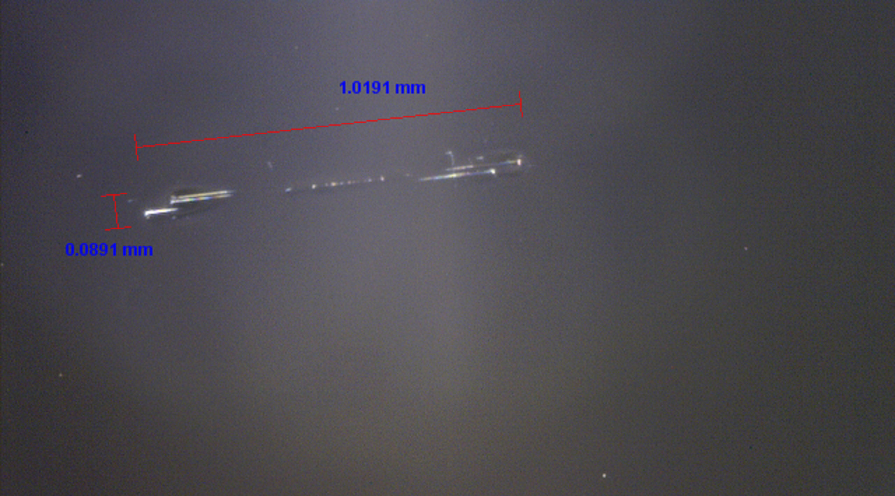

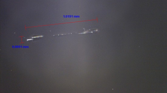

I found a tiny scratch on the platter. It is located on the outer edge of the platter, any hope?

As far as i know, usually, no drive have double errors.
You sad, your drive have preamp problem.
How can this scratch be? :)
Btw not looks like critical, but harder than without this. (+ money, if not you was who made it)
Janos

I forgot to mention, this drive was initially brought into a computer shop, top cover was removed.
Ahaa.
This is the point. :)
This little "mark" shows the heads was removed.
In this case, yon can't be sure, the patter is the original at all...
In this case i would give a big invoice for the client BEFORE i do anything, and if i get any of the data back, the another big invoice. :mrgreen:
Janos
