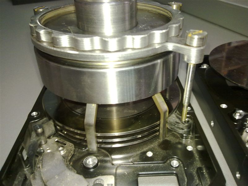

first pictures

Looks nice Nikola, can you tell us a bit more about the functionality of the device? It looks like there is a twisting motion that will lock the arms around the platters before lifting them out?
If it's anything near the quality of the head combs, I look forward to having one :D

yes You are right.
There are some things needed to be done for it to be safe to use. ( limiting positions etc)
The centar cylinder is there for metal ring spacers. In all comercial tools rings can slide if You do not lift tool apsolutly vertical. Our tool should prevent spacers between heads to tuch the platter while moving.
To recap it should cover all that is nessesery for easy and safe platter swap with no space for error.
We are still testing it....
thanks for nice word btw

helpdisc wrote:
first pictures
Hi Nikola,
I can see you are going to have the same problems with the finger width as we are currently trying to overcome with P.Ex.
I can't see from your photo, but P.Ex is mounted on a sturdy worktop and is not hand-held; you can't really do precision work if you are holding the device - movement (placement, platter clamp, dampener clamp, lift) needs to be controlled by machinery.
You still have some way to go - but good luck!
Duncan
Retrodata

Sorry i do not understand finger width?
it is made so it will be hend heald, the central cylinder is srewed to the motor and the rest of the tool slides
over it, so there is not a 1/100 od a mm error.
Dont worry we are almoust there, but still thanks

Odiferous wrote:
helpdisc wrote:
first pictures
Hi Nikola,
Duncan
Retrodata
You are talking rubbish. How come my lab and many other labs are able to swap platters using only our hands.
It's nice to see some pictures of a real tool. I am sure this tool will be the best available on the market.

this is a picture from our work shop, nice ones will come in few days :D
thanks for support
