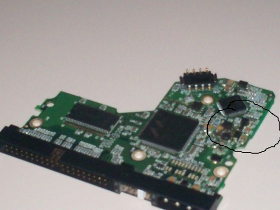

Hi, I have been reading some past posts and I want to get your guys impression on this. Meaning would it work right out of the box. I hope it will.
PCB burned on my Western Digital WD1600JB-00REA0
DCM: DSBHCTJCA
PRODUCT OF MALAYSLA
S/N: WMANM2732109
DEAD PCB:
foxconn
chip: 88i6540-lfh1
Part Number?:2060-701292-001 REV A
Now will the part below ( ebay link ) work with this hard drive?
Item: http://cgi.ebay.com/WD-WD1600JB-00REA0-DCM-HBCHNTJAHN-HDD-PCB-Logic-Board_W0QQitemZ220471966160QQcmdZViewItemQQptZPCC_Drives_Storage_Internal?hash=item33552739d0
Thank you for your help! Question, please ask, I will do my best to answer them.

Can we see a photo of the burnt component(s)?

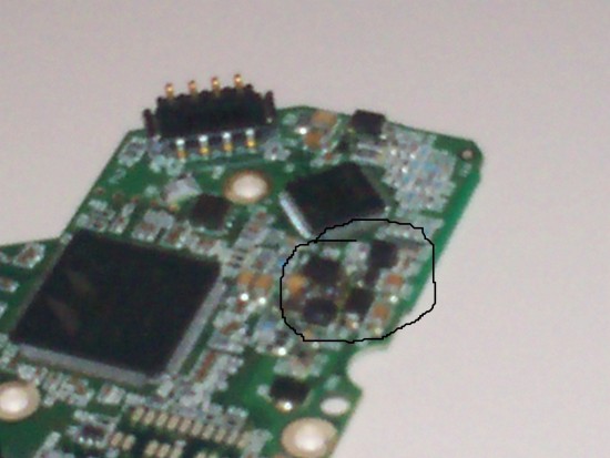

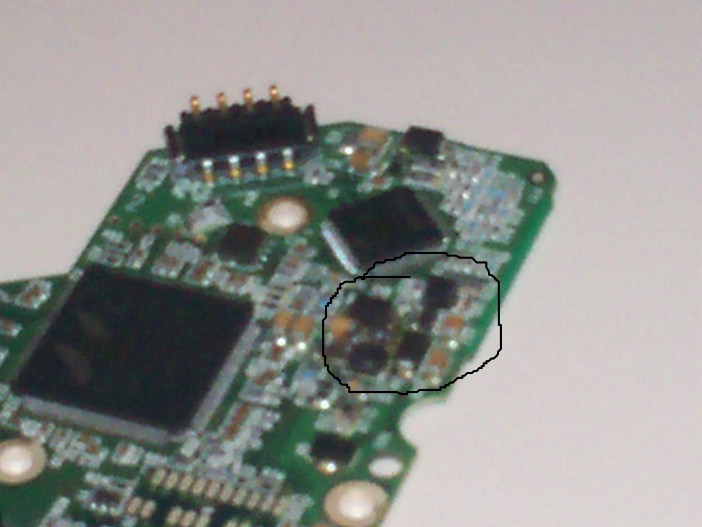

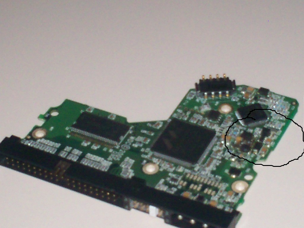

Photos attached!
I know from one post- Name: "Western Digital PCB Swap Rule" - Rameez stated: "For swapping pcbs, DCM don't care" He goes on to say: "DCM is matched when a donor for head is needed. If you hdd is clicking then check if pcb is compatible or not, u can also try changing ROM to or new PCB. "
I have a second wd1600 not jb. The PCB is different.. Different style and chip. Different setup 100%. I tried it... Probably dumb and it kicked the motor on. And then it clicked once and I unplugged it. This same post it states that clicking is a sign of pcb not being compatible. After: Rameez states again: "Did ur pcb burn out, if yes then preamp would be damaged as wel. Again I tell u no need to match DCM for matching PCB.
I keep seeing the term U12 come up. But rameez never states that. I'm kind of confused. I get one story from some one about switching and moving the u12? which I guess is the rom chip? and then another stating you just have to get the right model and chip, DCM doesn't matter.
Any one?
Kyle
File comment: Picture one. Sorry for the picture... Cam was having issues...

Assuming the preamp is OK, then you need a PCB on the same P/N (i.e. 2060-01292-001) and move the 8-pin ROM at U12.
Simples. Assuming your soldering skills are up to the job :-)
