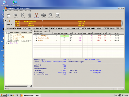

I have a 250GB HDD, with an OS installed on it (XP Embedded). Here's how the situation looks like:
First partition is used by some Korean disk cloning software (or an image of the system) - Clonix. Second one is assigned to Win XPE OS, the other two are irrelevant. I wanted to make a live CD out of them, using Clonezilla Live. It made perfectly good copies of all but one partition - the Clonix one - in short, it was unable to make an image of it due to sectors error - the number of sectors declared for this partition exceeds the actual number of occupied sectors. The Clonix partition (formatted in NTFS) is invisible under any OS, no letter assigned - presumably due to this sector number inconsistency, same goes for the file structure - unreadable. I am unable to repartition the disk using Gparted for example, due to the stated sector error - the software simply refuses to repartition and crop it to the actual size - but the partition itself is perfectly visible. The HDD is brand new (the system in question was restored using the Clonix LiveCD), the WinXPE works perfectly too.
My impression is that someone wanted to protect the HDD from cloning using this simple method. The company that manufactured this system is long dead, not much info lying around.
I guess that if I could somehow adjust the number of sectors (i.e. correct it) without destroying the data on the first partition I would be then able to make a live Clonezilla CD out of it.
Any ideas how to get the sector number back to its correct value? Thanks in advance for your suggestions.

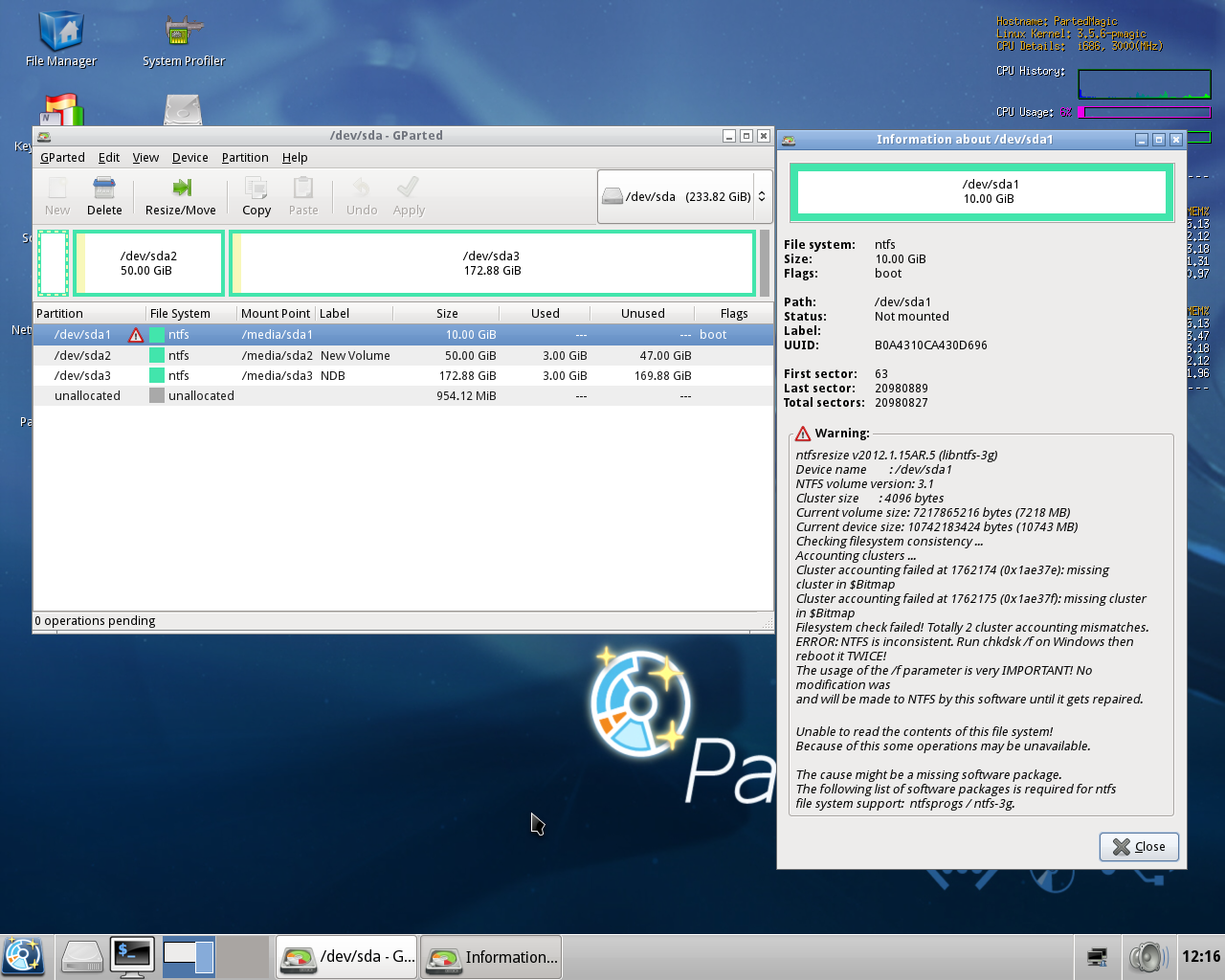

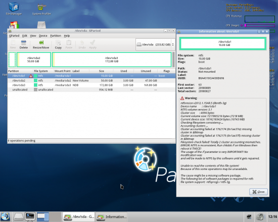

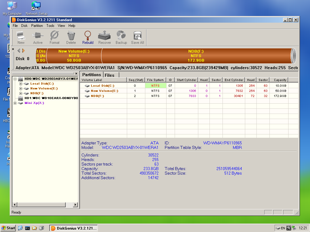

Update:
Here's what I managed to find out, my previous findings seem to be wrong:
seems that the HDD contains a hidden partition - which is used by the OS to start (I presume) - that's why doing a LiveCD of it won't work - it doesn't clone the hidden one. Here go the screens containing all information I could find:
File comment: Gparted
GParted info.

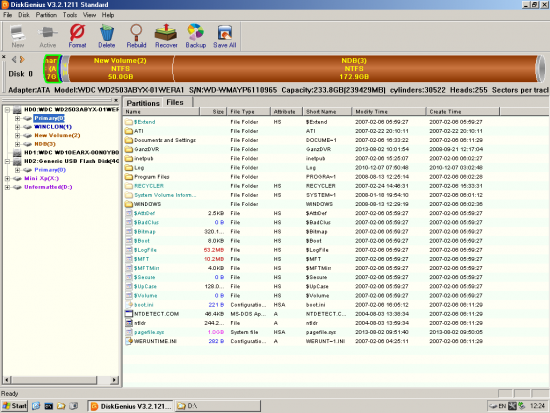

File comment: DiskGenius, HDD without any alterations.
HDD 'as is' - no changes yet.

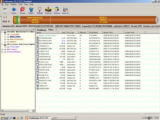

File comment: Scanned for partitions, found hidden restore (?) partition.
HDD scanned for partitions, WINCLON found - I suppose it's meant to serve as a restore of sorts - or a copy-protection.
File comment: partition content
contents
the autoexec.bat inside it contains:
@echo off
path=C:\
rem CTM-ES
SHSUCDX /D:CD0001
C:\DosClon.exe
Now... is there any reasonable way to make Clonezilla LiveCD out of the whole HDD using some tricks? When I unhid the partition, mounted it, saved the GPT the WIN XPe failed to run - presumably due to changing paths etc.

My take on the situation is that there were originally 4 MBR partitions. The first was a 7GB NTFS partition and the second was a 3GB FAT FreeDOS partition.
At some later time the second partition was deleted and the first partition extended in order to merge the two, thus creating a single 10GB partition. This process affected the partition table in sector 0. However, the NTFS volume was not reformatted, so it remained at its original size.
So now we have the original 7GB NTFS volume inside the merged 10GB partition. The original FreeDOS volume remains intact because the NTFS volume has not encroached upon it.
The file system error reported by GParted identifies two clusters, 1762174 and 1762175, which occur at or near the end of the volume.
1762174 clusters x 4096 bytes per cluster = 7217864704 bytes
Size of NTFS volume = 7217865216 bytes
ISTM that there may be some kind of anomaly at the very end of the NTFS volume, just prior to the FreeDOS volume. I would use a disc editor to search for and examine the aforementioned clusters, and I would also locate the FreeDOS boot sector.
As for the cloning problem, I suspect that you are trying to create a "logical" clone rather than a "raw" image. The latter is a sector-by-sector image which pays no attention to the data within each sector, whereas the former copies the actual files and therefore requires that the file system be intact. It appears that Clonezilla and GParted have analysed the file systems and uncovered some kind of integrity issue which understandably prevents them from proceeding.
