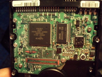

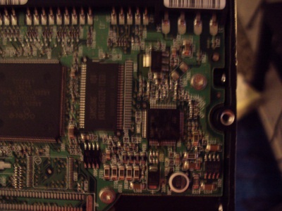

Hi all,
After some researching how to recover my data for my hard drive, I came across this forum, I hope someone can verify where the TVS and is removing it will allow me to retrieve my data.

Your board clearly has burned motor controller chip.
You will have to replace whole board.
Check your messages.

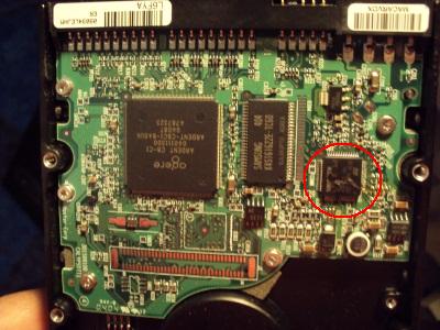

Your SMOOTH/MOTOR Chip is burnt/melted... You need a replacement PCB at least!!!!

Thanks, i saw that melted part but was hoping for the easy way out.
