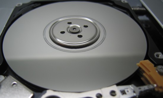

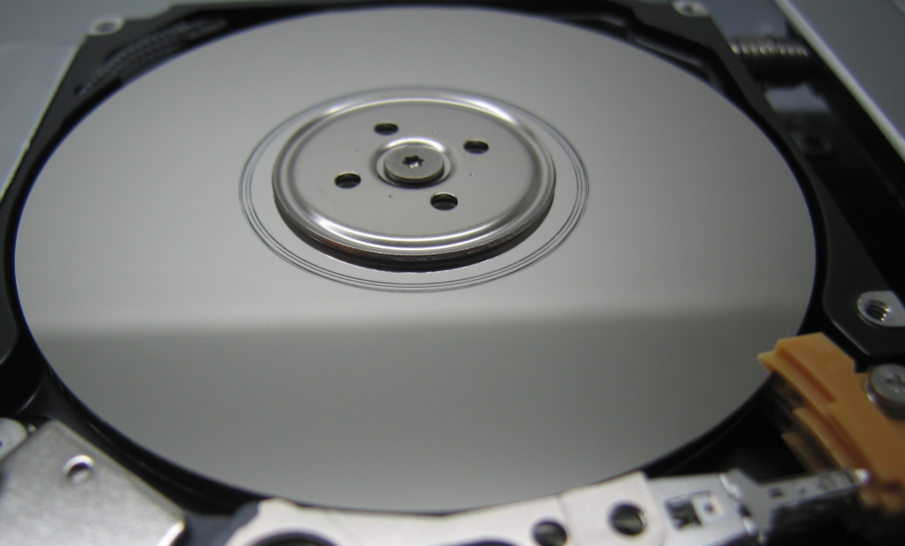

Hi to all,
Have this fujitsu that clicks, open it and notice a head crash.
Change heads and have ID now.
but when cloning is a little bit slow, any suggestions for DE settings in this case.
Also i put to end in the sector 150.000.000 of (234 441647), for not go into the head crash.

whats causing it to read slow?
