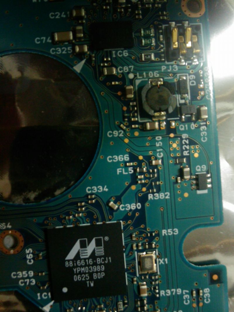

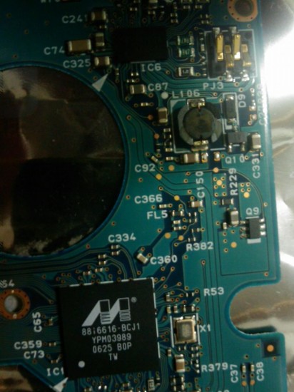

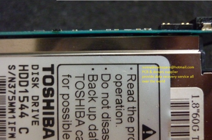

So here is the worry: I have never done a BGA rom swap. See photo, i am guessing its IC6. I Have a Hakko hot air rework station, full nozzle set and good hands, but at best I can see this helping me remove. No idea how to replace. Any ideas?
- Am i right thinking that IC6 has the additives?
- Any offers to do the romswap? please PM me.
_ Anyone had any luck with non-IR swaps on these smaller BGA chips?
Thanks! :wink:

I bet it is dead heads.
Yes you will need a BGA chip remover to swap the adaptives. Doing a heads swap will be much easier to try.

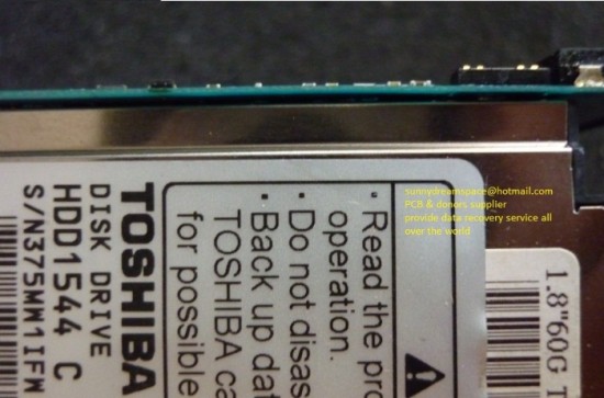

hi,

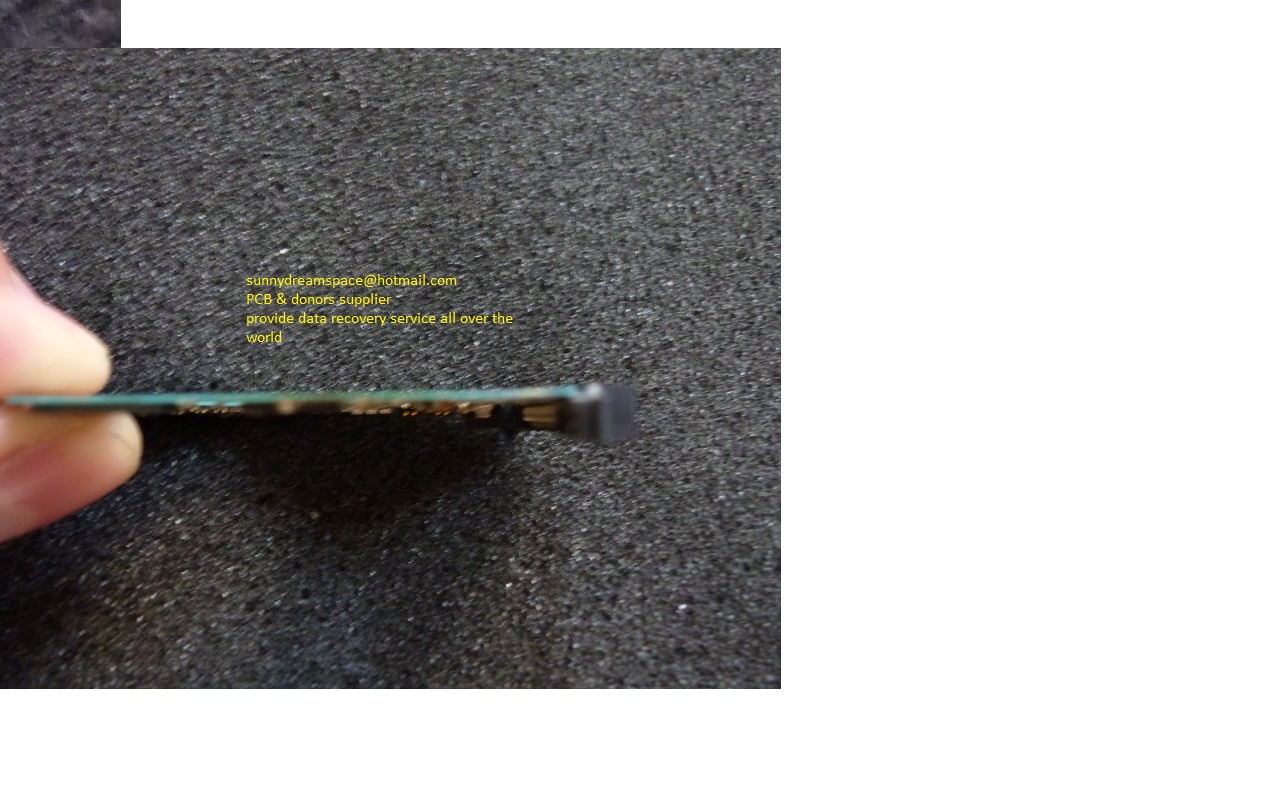

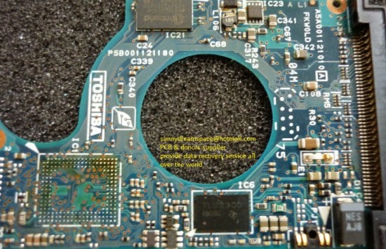

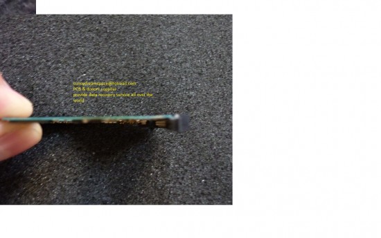

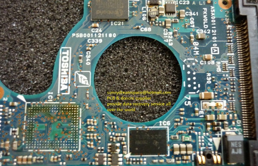

i can handle this kind of chip swap. it no easy work even you had expensive BGA rework station. and it very thin as A4 paper. it may have chance transfiguration & broken when you hot up. good luck

It's IC1
It is unlikely PCB problem
Make sure SN from ID matches with the drive's SN on the lid
You can do it w/o IR but it's PITA anyway.
This is how you do such re-work w/o IR
http://ra9mgk.narod.ru/other/bga/index.html

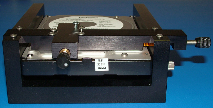

OK Mediaman
I'll show you mine if you show me yours . . .
:D

does it work?
 Post subject: Re: TOSHIBA MK6034GSX BGA Rom worries/doubts
PostPosted: December 17th, 2009, 9:41
Joined: June 8th, 2006, 19:44
Posts: 3144
Location: Atlanta, GA

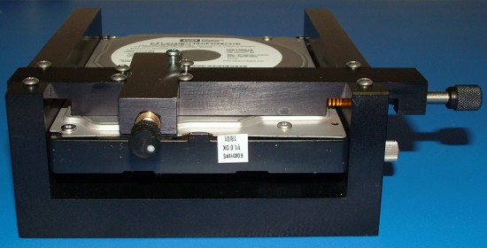

It is a prototype and is undergoing further development & refinement.
I gave it to another DR shop to try and they said it was the most effective tool that they had seen for that purpose.
I have not tested it extensively, but it does "work". It provides a precise way to adjust the zenith and azimuth of the head stack bearing post. It is usually a tedious process.
I don't know that I will sell it because if it is not used correctly, it can damage the heads and platters (through over-adjustment). Don't want that on my conscience . . .
