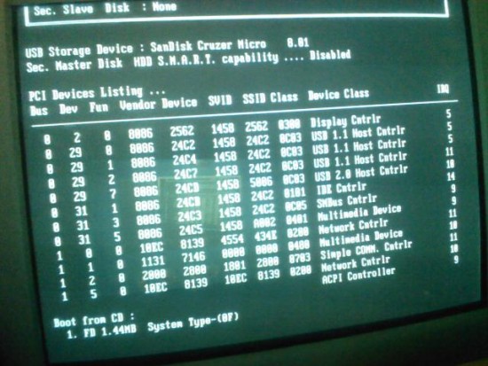

i tried with other computer , i attached my hard disk as secondary and start that system but that system xp hangs on boot screen and the left to right graph moving and moving.
when i try to boot it from cd it hangs .. i am uploading a snap . in this snap i try to boot it with 98 bootable cd
but it stop there and my cpu red light is on and keyboard is working.
please take a look

The only times I have seen that behaviour is when the booting OS is trying to mount the ntfs partition on the problem drive, and is hanging due to ntfs logfile corruption.
That might explian why XP wont boot
But shouldnt affect Win98
and would normally suggest booting Win98 or similar and use a disk editor to tempoarily zap the filesystem-type entries in the partition table on the problem drive
But you cant do that

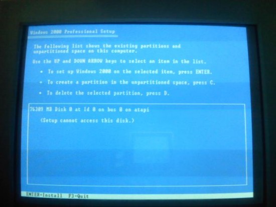

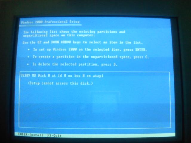

see the snap
when i insert the cd of win 2000 that move few steps and show my hard disk size but also shows:
<setup cannot access this disk>
but please xsoliman tel me how i can go in ... mens i can't do any thing until i got the control of the hard disk...
you are saying "run a scanning tool like Restorer2000" and "rebuild its partition table entry and ntfsboot sector"
how can i do these.
my cd is not booting, my bootable pendrive also not booting, win 2000 run but also says cannot access disk, if i attach other computer then that computer freeze on booting screen in processing.
so give me a way from where i start??

Its starting to sound like the disk has a physical problem and is hanging or taking a very long time to respond when anything tries to access or query it
Will the system boot from an MS-DOS floppy disk ok, or dies it still hang then?
If you can get MS-DOS up, you can try to access the problem disk with Norton Utilities or similar, or with MHDD
Edit: looks like you did try to boot from a testdisk for dos and it still wouldnt boot
Edit2: The boot from CD to XP setup shows it sees a drive 76309MB, but cant read the first sector
The drive is either damaged or has locked itself with an ATA password
Try booting from a MHDD bootable floppy and see what it shows and if F4, F4 can scan the disk ok

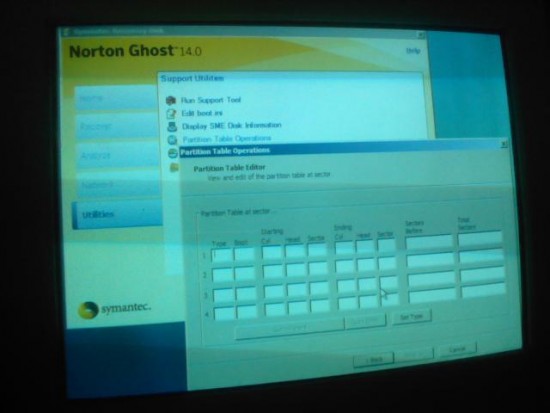

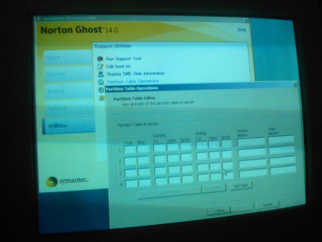

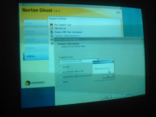

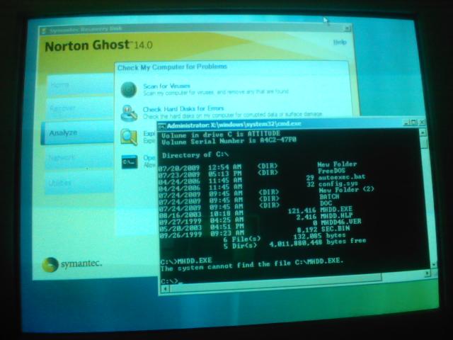

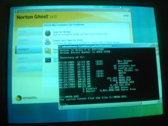

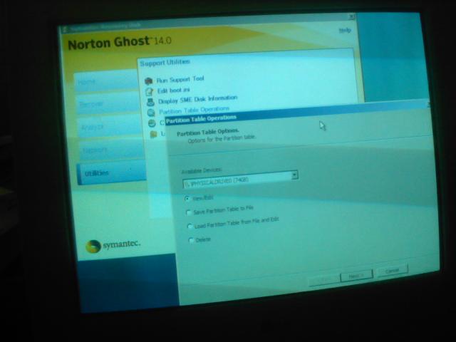

Norton Ghost:

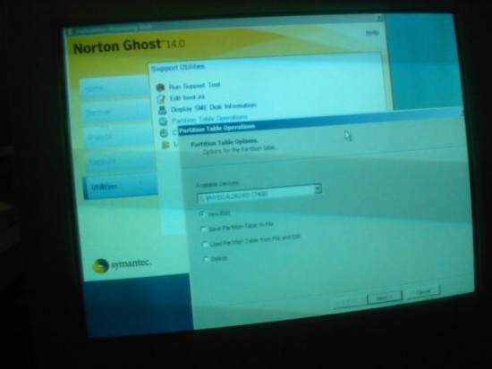

now please take a look.. i use Norton ghost 14 recovery disk that provide me some functions. i try them but still not able to rebuild/repair the partition table. there are some snaps please take a look.
it shows attached devices like.. cd rom, pen drive and it show x:\ drive of 28mb free of 30.8mb. In x:\drive it show dir and files like windows have. i think these all are virtual loaded from cd or temp loaded in RAM from cd.
...I try to use command prompt and try to run MHDD from command prompt but it show error ( as shown in snap). it shows same error on running of any file.. but it run internal dos commands.

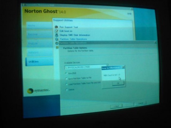

...In partition table options i try to delete the current partition table, it show:
Device 0
***Select the finish button to delete all partitions table data from to the device noted above
When i press finish it show "operation was not successfull"

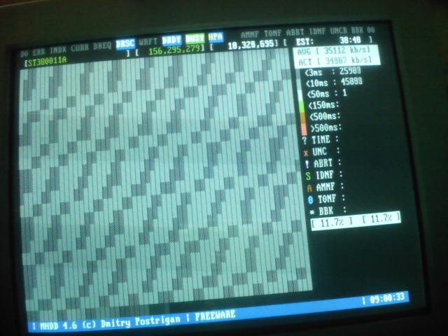

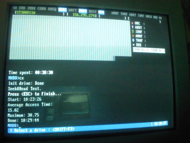

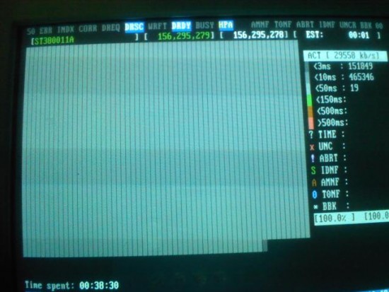

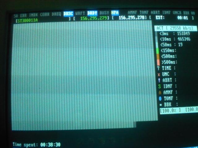

MHDD:
and then i create a MHDD bootable cd. and try to boot it. but it stop in the bigging like bootable 98 cd stop(as i shows 98 bootable cd snap same MHDD stops at same point) cursor is blinking and red light is ON and keyboard is working.

kindly take again a deep look in all these problems... and give me suggestions what i ll do next...

 Post subject: Re: A tricky Partition recovery job ..help me
PostPosted: July 24th, 2009, 4:11
Joined: May 6th, 2009, 5:28
Posts: 116
Location: Somewhere near UK
Hi jsingh,
You should get a computer that can run MHDD, first.
Thus should run off bootable CD, or preferably new working drive
as primary master with MS-DOS as BOOT OS and MHDD installed.
Then get MHDD to run and then connect any other working drive to secondary
jumpered as master or single. Then get used to MHDD using scan command.
Then connect you faulty drive, jumpered as master to the secondary cable
and report here.
Until the above has been done please stop TRYING anything else, and chill bud.

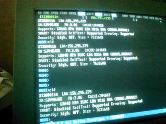

PostPosted: July 24th, 2009, 7:34
Joined: May 16th, 2009, 9:32
Posts: 325
Location: UNited Kingdom
In fact it sounds worse than that, as nothing can read physical sector 0
and strongly suggests a physical problem with the drive
(or somehow ata password protected)
Strange the bootable MHDD wont start
One test would be to start the MHDD CD with the drive ide cable disconnected, then hot plug the cable after MHDD is up
[and ensuring drive set as master and that cdrom wasnt master on the came cable]
Shift-F3 to see if it sees the drive (it should)
select it
EID to see info about it
CX to see it it can read sectors for seek speed test
F4, F4 to see if it can read the sectors, especially the first one
Warning - hot plugging is not recommended, but in this case is worth a try

The description indicates that nothing can read physical sector 0
but its not 100% confirmed
The boot from CD to XP setup shows it sees a drive 76309MB, but cant read the first sector "<setup cannot access this disk>" where it would be reading the partition table

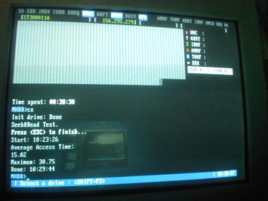

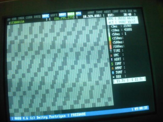

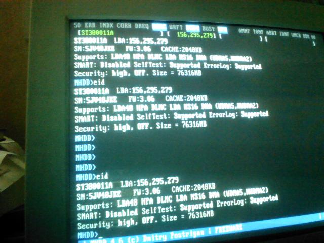

yes xsoliman i did as you say and now i feel it ll work :)
Shift-F3 detect the drive
with F4 it start scan and after a long process it ends
EID shows info
CX shows.. seek speed test result
i update all the snaps please take a look and advice me what is next step to do...
and BlackST i believe in hard work... not in shortcuts... but i want a point from where i ll able to start and that start point is MHDD.
BlackST wrote:
the OP is searching for a one-click solution that DOES NOT EXIST
and i do not understand please explain it ....

File comment: starting scanning with F4
File comment: ending scanning with F4
File comment: EID result
File comment: CX result
PostPosted: July 24th, 2009, 14:05
Posts: 325
Thats good as it shows the sectors, including block 0 can be read ok
Strange the XP setup couldnt read it
Now need to exit from MHDD, back to DOS, and find and ude some disk sector editor (eg NU7) to read the first sector and 63rd sector (usually) of the drive
Plus the experience to know how to interpret them
Or could hot-plug the drive into a working XP system and rescan for hardware changes, which might pick up the added disk
and run restorer2000 or R-Studio on it
