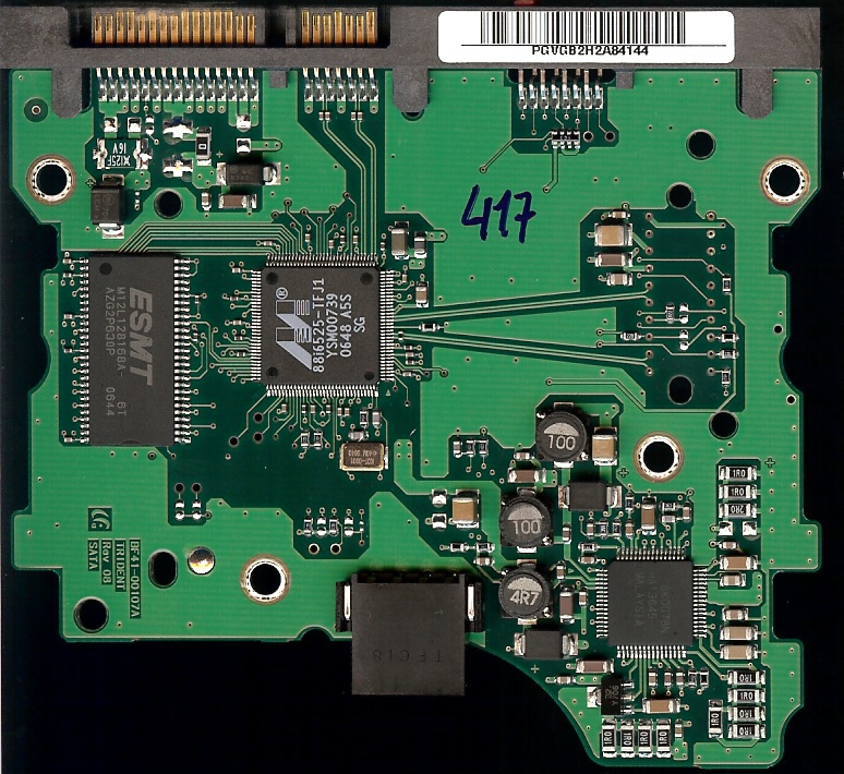

Hi to all,
anyone know what is this :
SPW 1.5G LinkOk!SpnOk
spd: 0000 0000 0000
ADC: 0002
DAC: 9A8E
H: +00000
Unlatch Tk: 00016268
Unlatch Done
ENG>SRV>
SvoTbl Loaded
BD
P&W Rty!BITmp=0033
them stays BSY,
softreset do nothing ...
ZeBong

If not clicking, looks like SA/MC problem.

it cliks like head problem them it stops and stays BSY.

PCB is not original

try hotswap. see if you access SA.

I vote for non original pcb.

if not original pcb, hot swap is only way to get data unless you get very lucky :P

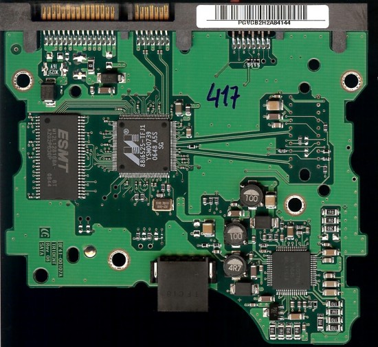

Do not have a donor disk like this in stock so i can not see if the PCB is the same
I made a scanner of the PCB that i have in the disk.
If someone have some time , can please check it, or also scanner / photo of the PCB from a HD401LJ.
Thanks in advanced
