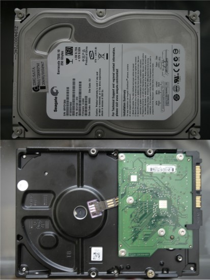

Obviously I am not a HDD Guru, I am merely an enduser seeking enough knowledge to have the proper repairs performed on my HDD. The guy at the computer shop was very dismissive and said I would have to send the drive to a laboratory for recovery and it would cost a few thousand dollars. This isn't acceptable to me since he didn't even look inside the computer (iMac)...
I am *not* expecting to become a professional for this one drive. Nor will I attempt to open the HDD in my home.
This drive seems to have died and I have no usable back-up. I'm kicking myself now... but I need to try to recover this data... if it is going to cost $1,000+ USD I am going to have to wait until I can save that money. But in the meantime I would like to diagnose the malfunction or at least eliminate some possibilities.
Can anyone give me a link to a walkthrough on diagnosis? I searched for such a thing on this forum and the one link that appeared to be relevant was broken...
The only information I have on the status of the drive is that it spins-and-clicks over and over.
edit* - Thank you in advance. Even if your only advice is to pay a pro to diagnose it! :) Lucas

It would help if you describe in detail what you was doing when it failed, what happened to it, what exactly is the drive doing when powered eg spinning, buzzing, clicking, normal sounds or completely dead. You will need to use your ears.

It could be a firmware failure or bad head(s) / damaged media.
You can't diagnose the FW problem without special gear. That same gear will also indicate if the heads have failed or not.
If you need & value your data, I wouldn't experiment with this drive.

The majority of the time this symptom is caused by bad heads and/or damaged media surfaces. Unfortunately for you, it will have to be looked at by a pro.

heads or CE LOG error
or can not read servo

no,
you will need expensive tools for that.

No, its pretty much time to send it in.
