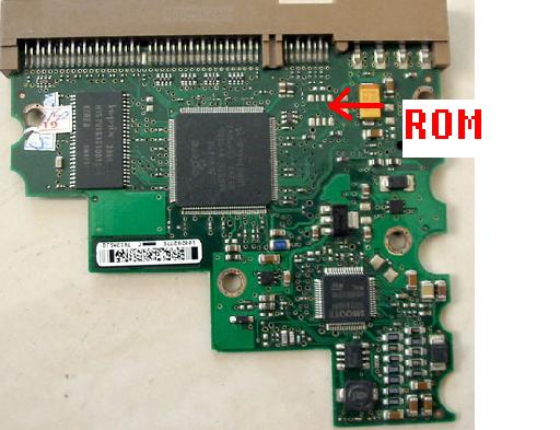

here is ref pic. your PCB may be shape close as this one. and ROM chip model most is:25XXXX

The man is right, that's the chip.
If the PCB has the same main chip and you move the ROM over, then the PCB will work.
Assuming the PCB is the only problem, of course.

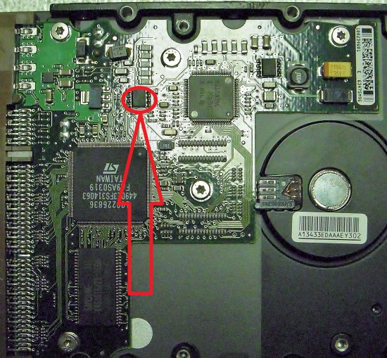

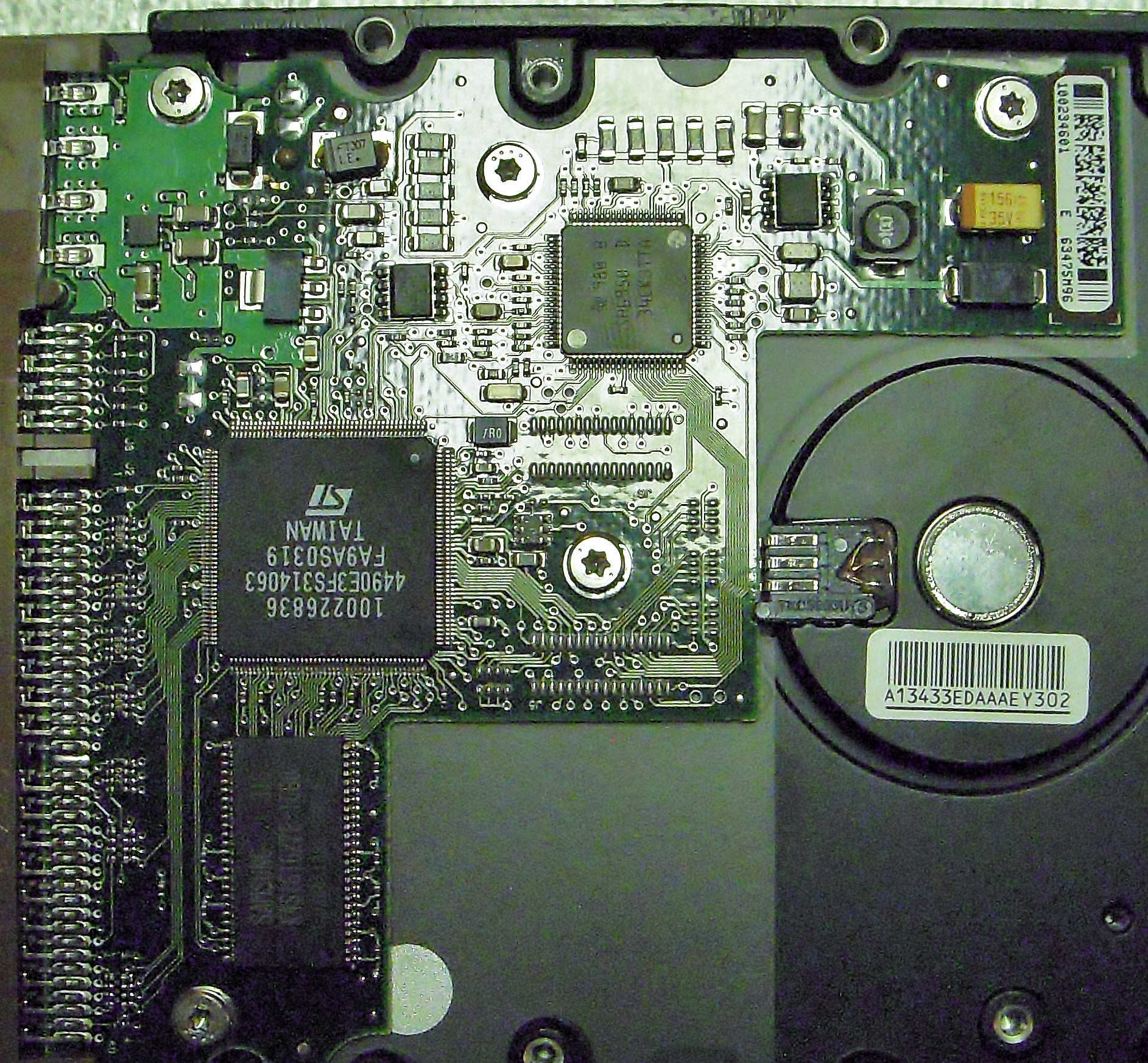

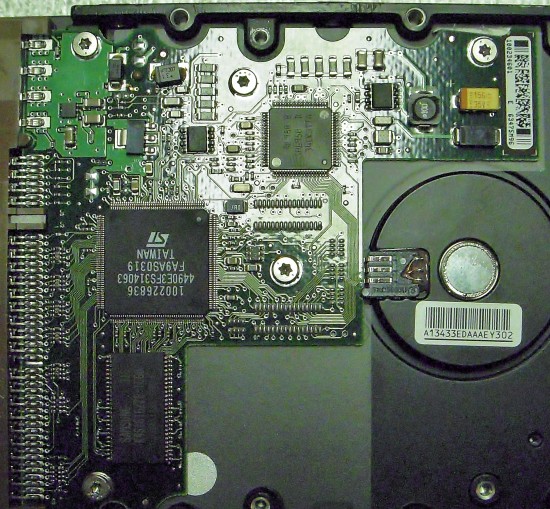

Here is a pic of the BadPCB - it's a little different than the one posted....
File comment: Bad PCB

In your photo why is the component close to the left hand top corner out of position? What has been going on?
Also you don't need 2 threads on the same topic so you could post a message in the other and direct peeps to this one.

1 item in the picture looks funny... Did you try to remove it on your own?????

nope - I have not attempted to do any work on the PCB - I see what you mean - that one chip is crooked

I see the diode that is crooked and I think the factory's QA would have let this out. (It is a Seagate after all)
The ROM is probably the 8 pin chip "southwest" of the crooked diode. Can't read the marks in the photo, so double check. The other 8 pin chip - on the right - is obviously not a ROM.

hi,
here you are.
