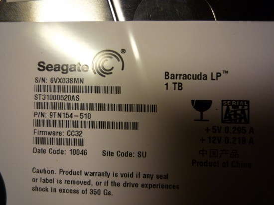

Hi Dabr,
From what you describe sounds like the 7200.11 Firmware problem.. Could you photo the label on the drive just to confirm ?

Thank you for the optimistic votes!
Here it goes. Its ST31000520AS with firmware CC32

The disk does not seem to be among these ones at least:
http://news.cnet.com/seagate-fixes-7200 ... it-doesnt/

I have checked and it seems like this disc is not among those that are affected with firmware problem.
