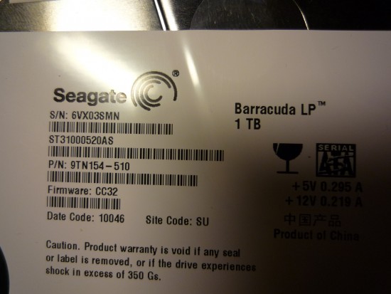

Hi Dabr,
From what you describe sounds like the 7200.11 Firmware problem.. Could you photo the label on the drive just to confirm ?
I vote : Yes :)
https://www.mjm.co.uk/
 Post subject: Re: LaCie Grand UDB 1TB not recognized
PostPosted: December 18th, 2009, 7:10
Joined: December 17th, 2009, 22:02
Posts: 9
Location: Europe
Thank you for the optimistic votes!
Here it goes. Its ST31000520AS with firmware CC32

The disk does not seem to be among these ones at least:
http://news.cnet.com/seagate-fixes-7200 ... it-doesnt/
PostPosted: December 18th, 2009, 8:13
Posts: 9
Location: Europe
I have checked and it seems like this disc is not among those that are affected with firmware problem.
Come back to you later today when I plugged it to a desktop.
PostPosted: December 18th, 2009, 17:52
Posts: 9
Location: Europe
Its fixed, bought a new 3,5" case and its working again!
