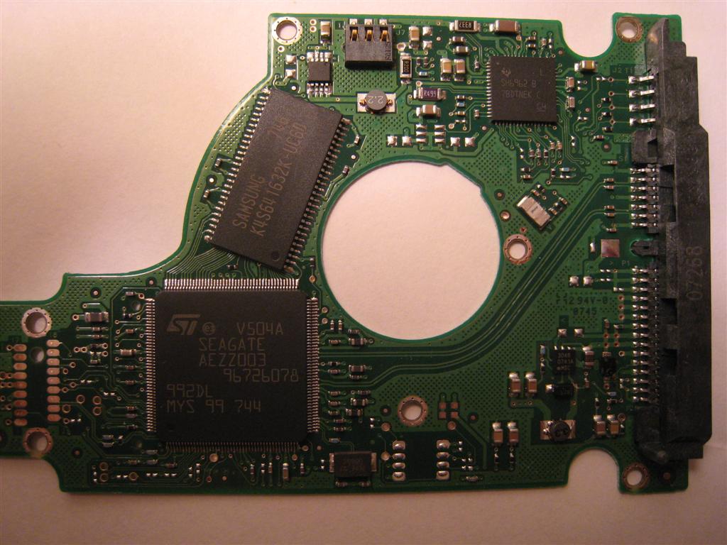

I have a laptop drive that got the polarity reversed. Can I simply replace the PCB with one of type and identical firmware to recover?

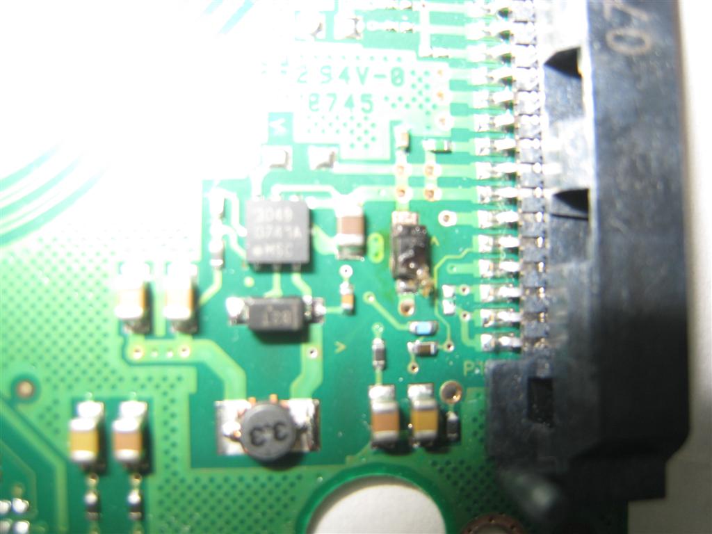

If your drive has a TVS protection diode, then it may be that all you need to do is to desolder it or snip it out with side cutters. Hopefully it will have sacrificed itself by going short circuit and thereby protecting the rest of the electronics.
If you have difficulty identifying the diode, post a photo, or visit Seagate's forums.

I added a couple of pics of the damage
Here are the specs:
Seagate momentus 160gb
ST9160821AS
fw:3CDE
Date Code 08231
Site WU
Yes, that's the culprit. If you remove it, then hopefully your drive will power up. Just be careful with your PSU, as your drive will no longer be protected.
For continued protection, a replacement 5V TVS diode, p/n SMAJ5.0A, can be obtained from Farnell, Mouser, Digikey.

Removed the diode and voila problem solved!
Imaged and replaced the drive.
