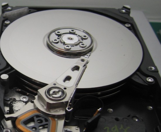

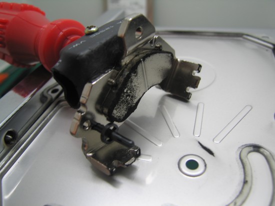

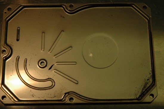

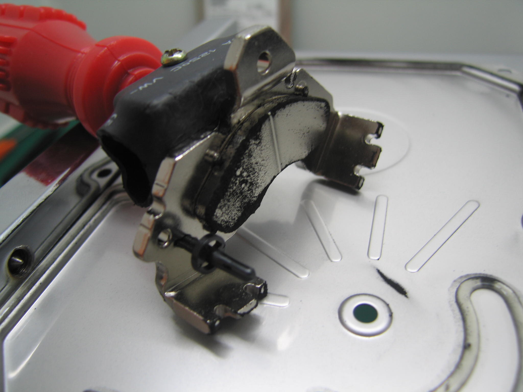

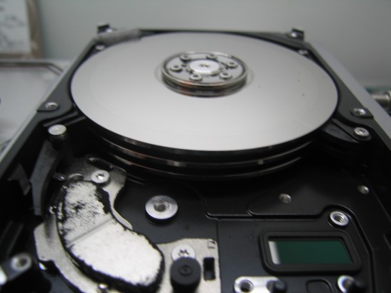

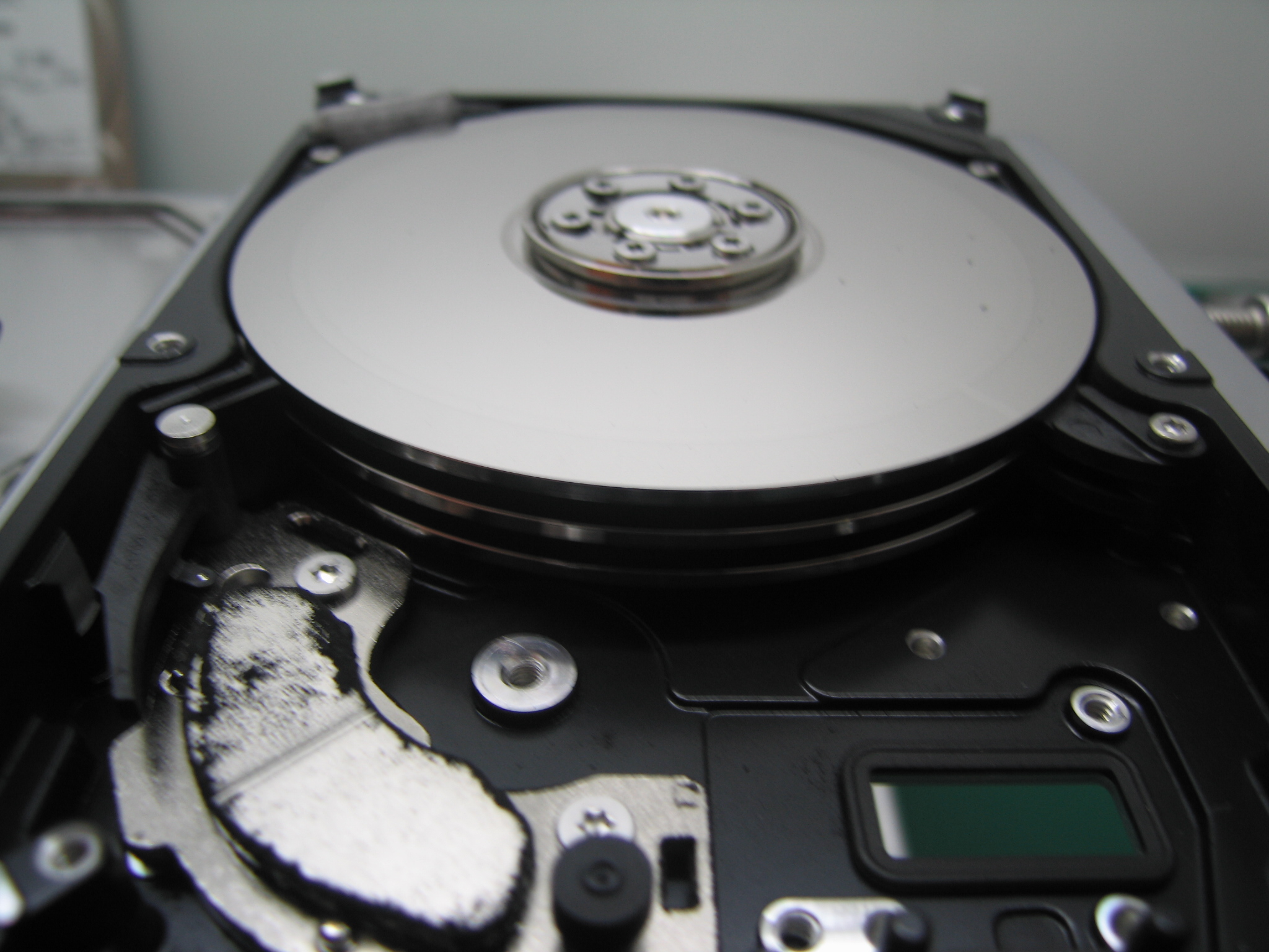

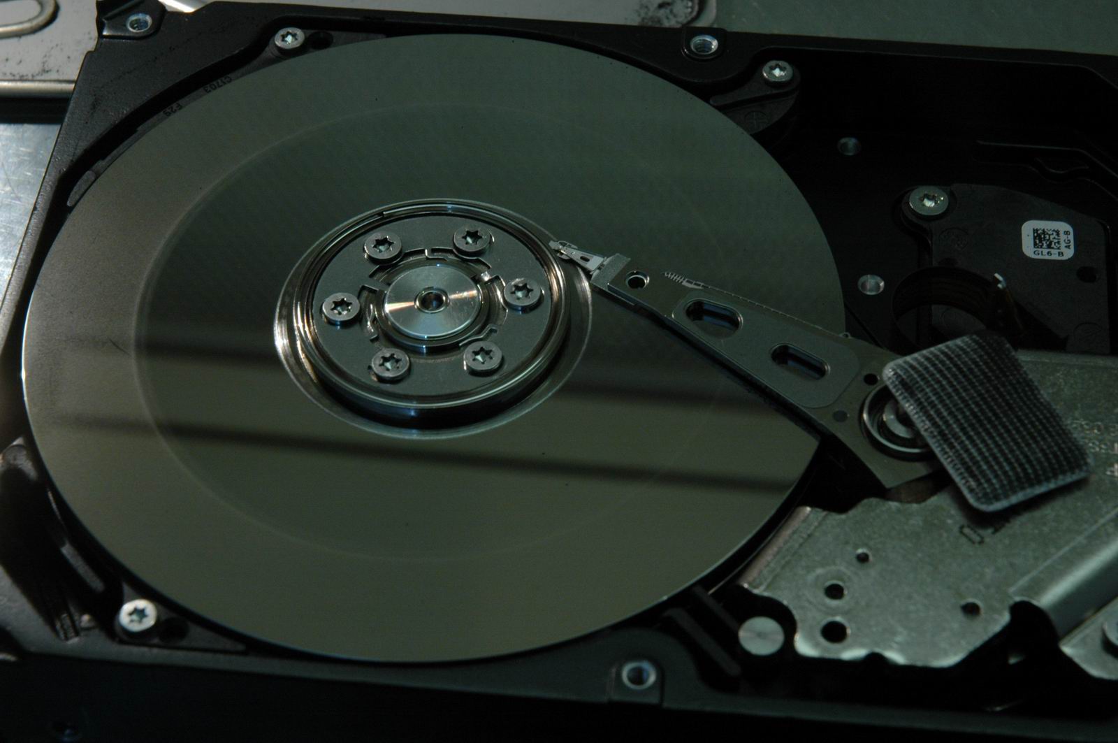

Hi to all,
Just to share this case:
Have disk disk with a head crash:
I clean the 3 platters, all they have a head crash in the PARK ZONE.

 Post subject: Re: Seagate 7200.10 - 500Gb Head Crash
PostPosted: November 20th, 2009, 12:41
Joined: June 8th, 2006, 19:44
Posts: 3144
Location: Atlanta, GA
can you retrieve the data?
PostPosted: November 20th, 2009, 15:18
Posts: 1421
Location: EUROPE
Will try it next week.
Just waiting for the heads. :)

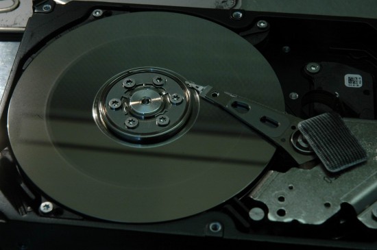

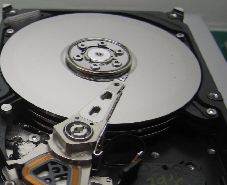

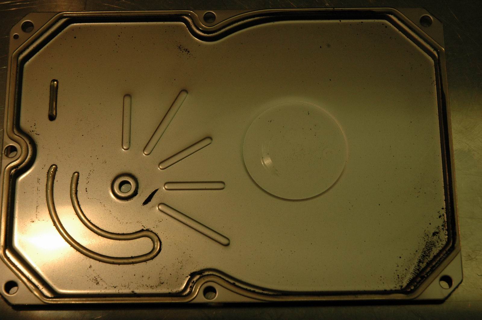

PostPosted: November 21st, 2009, 13:32
Posts: 4826
This one was recovered:
had about a half milimeter deep groove on the parking zone :)
So it can be done, heads up!
PostPosted: November 21st, 2009, 14:34
Posts: 1421
Location: EUROPE
Good work pepe,
yes when i look at my case and see that went to other DR company and they did not want to take a try in the recovery they say can not do it.
So i will give a try :)
This case is from a raid 0
ZeBong
" Россия еще раз"
PostPosted: November 22nd, 2009, 5:12
Joined: November 9th, 2006, 22:36
Posts: 344
Hi Pepe
just curious to know how much data was recovered from the drive, looking at the outer end of the platter there is alot of scratches.
did you have to replace multiple sets of heads in the process.
thank you
PostPosted: November 22nd, 2009, 6:59
Joined: July 13th, 2007, 1:17
Posts: 149
Sorry I am a skeptic on this one, not buying it. :D
PostPosted: November 22nd, 2009, 13:29
Posts: 3144
Wow, if you can recover meaningful data from this drive, I'm going to have to bin all that I thought I knew about head crashes and data recovery . . . .
Good luck. You're gonna need it!
PostPosted: November 23rd, 2009, 4:22
Posts: 2984
I have had a few cases with scratches and grooves in parking zone, after head change data is accessible but the longer drive is powered and being accessed the worse the media gets. Eventually entire platter looks like the one in your image.
Im guessing data recovery from it in the condition it is in now is next to impossible...
PostPosted: November 23rd, 2009, 9:24
Joined: July 8th, 2006, 6:18
Posts: 222
How do you prevent the heads from being driven into the scratched area? Starting the drive with the heads parked somewhere else on the surface couldn't be solution, could it?
PostPosted: November 23rd, 2009, 9:44
Posts: 1466
Location: Europe, Hungary
There is software solution but only for some times, and more different HW solutiions existing for the cases.
PostPosted: November 23rd, 2009, 9:47
Posts: 1493
try modifying the limiting stop and see what happens. :wink:
Also a good idea of knowing what sectors are where on the actual platter is also good to know.
