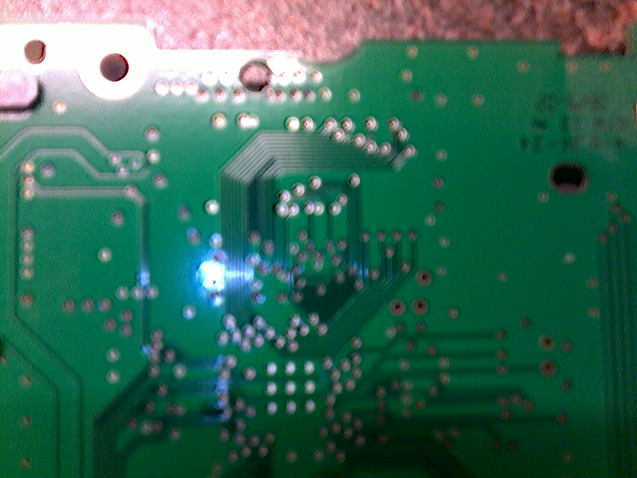

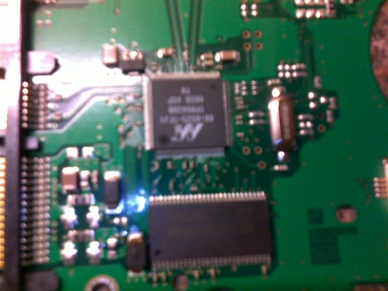

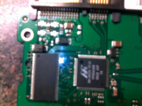

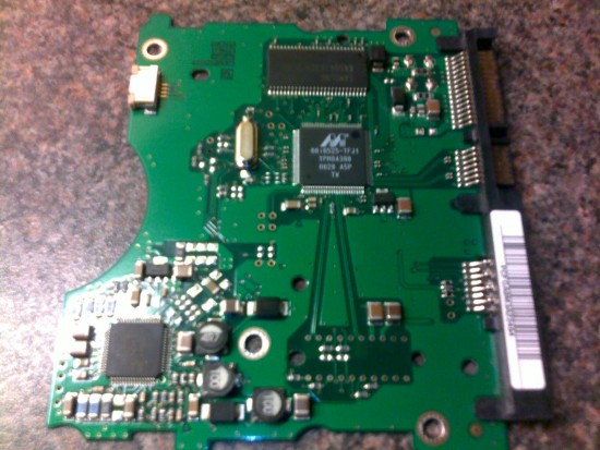

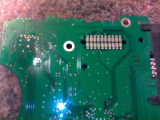

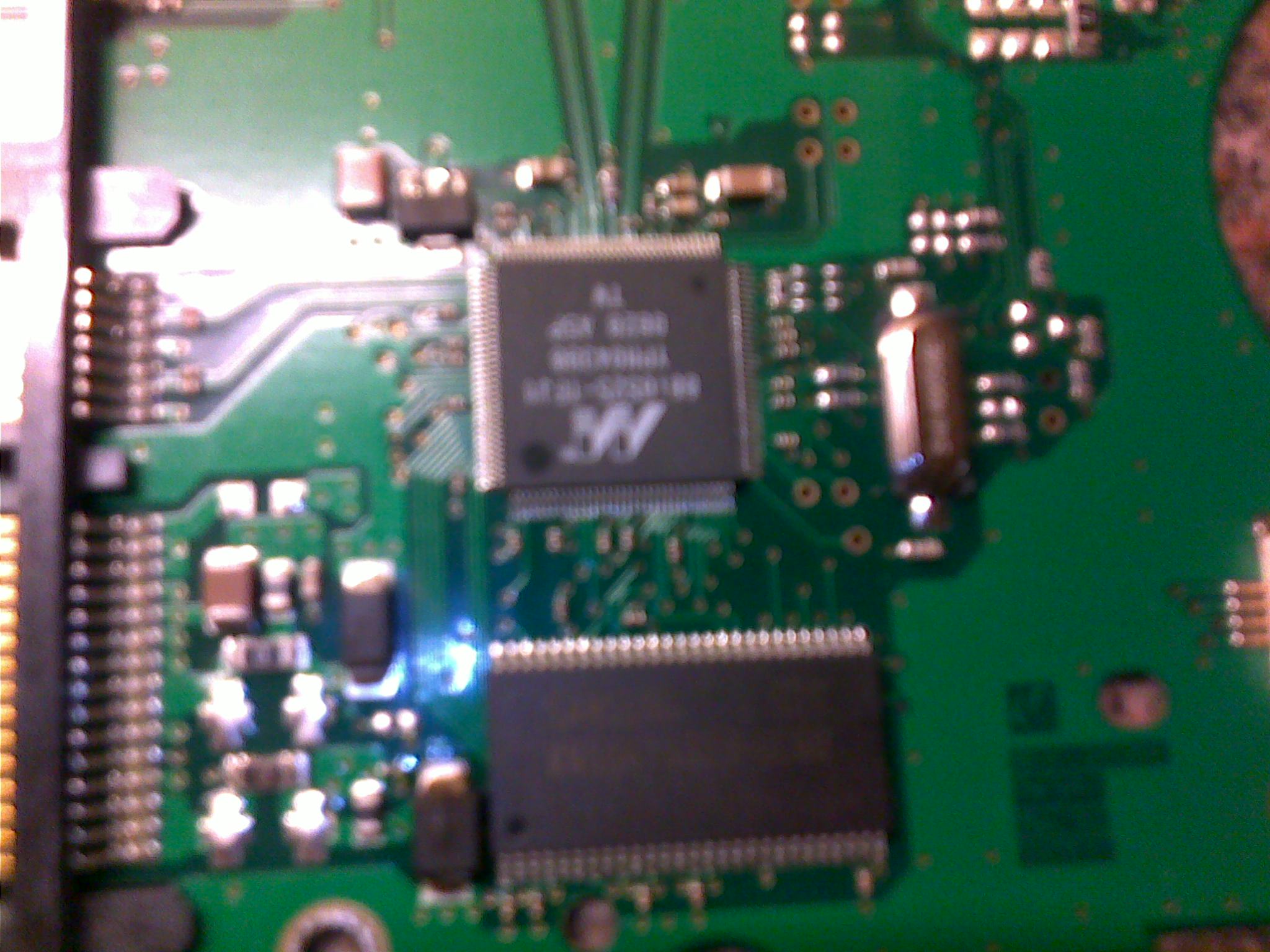

Can you upload a detailed photo of your damaged board?

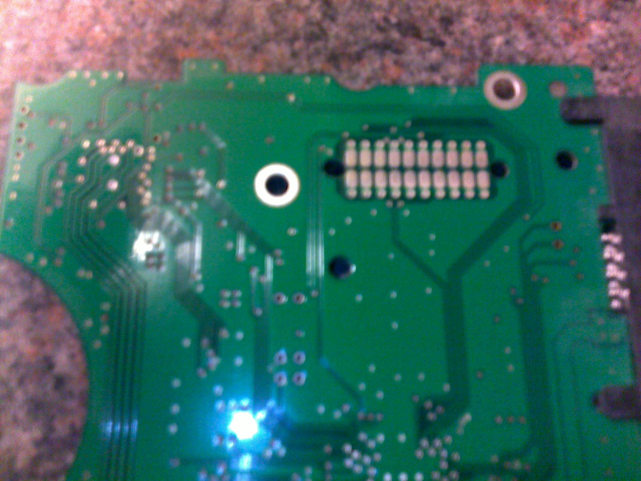

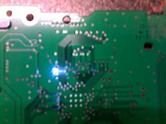

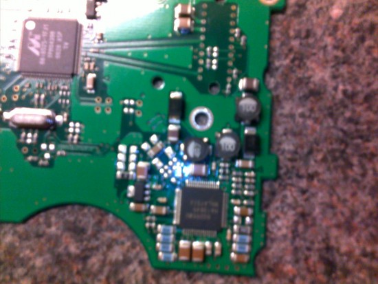

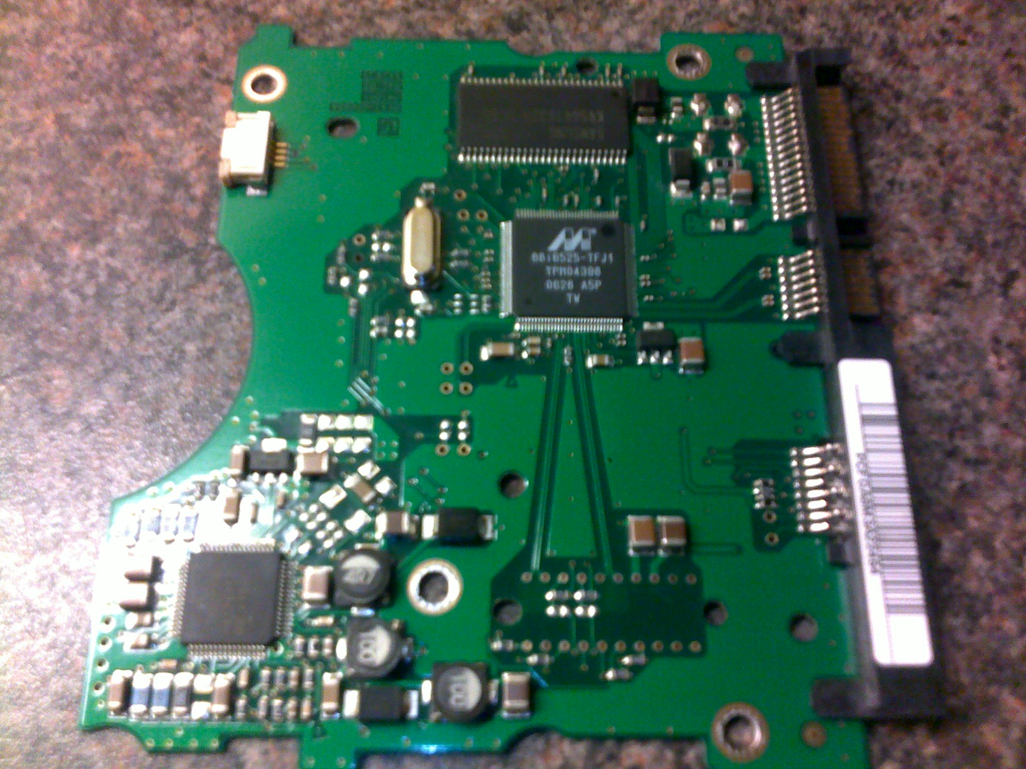

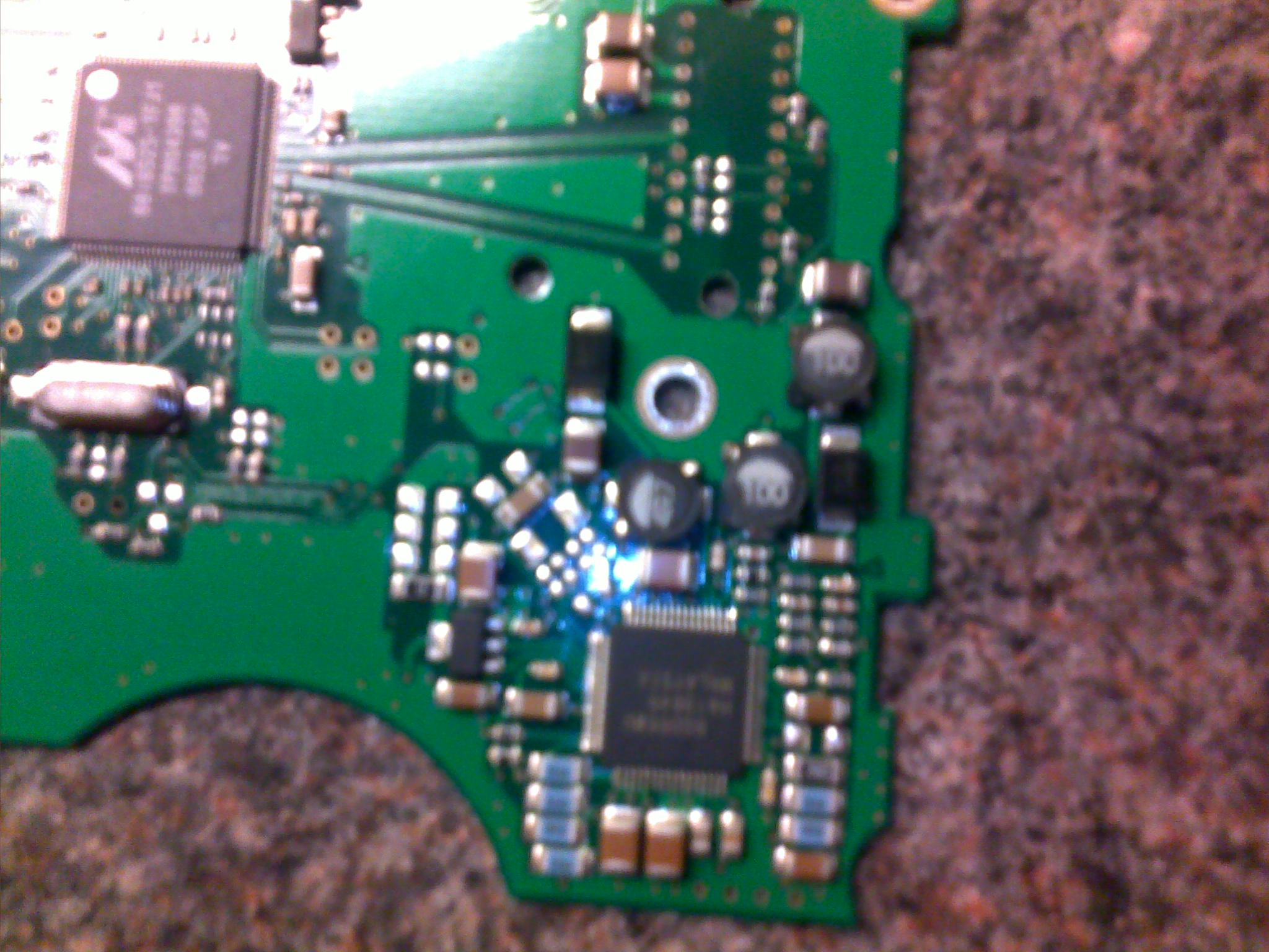

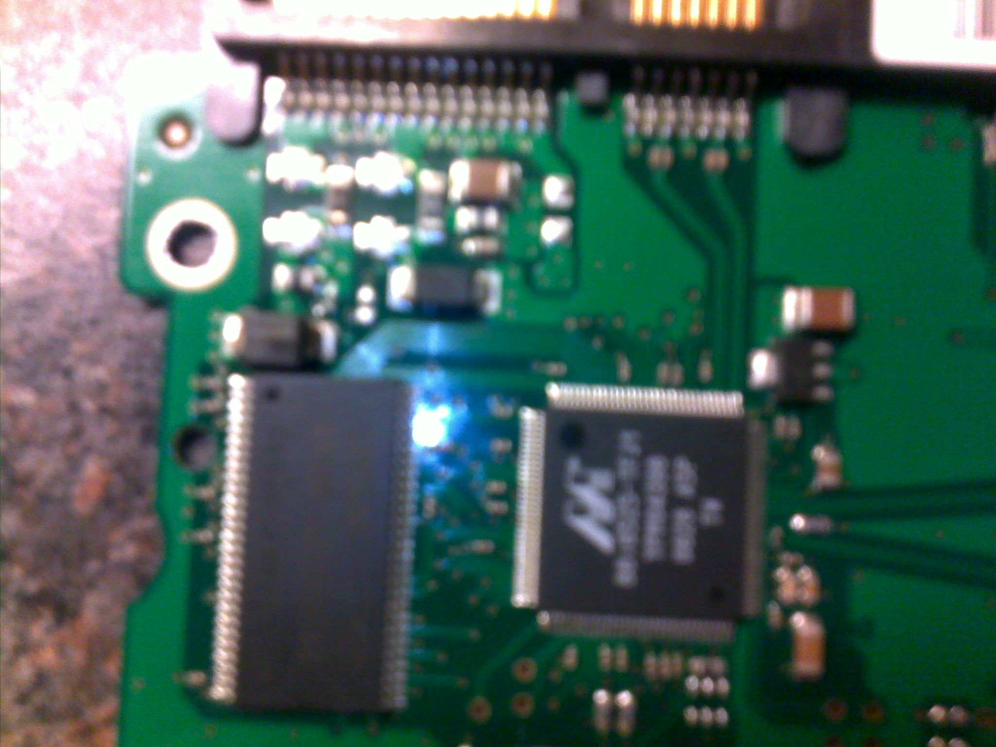

Anyway, attached are the images of the board which I believe to be broken. Sorry the Flash doesn't do it too many favours, what can you tell?

Please do not place your board on carpet! Keep it away from static.
If you have a multimeter, set it to the 200 ohms range and measure the resistances of the two TVS diodes. I'm not familiar with your board, but I suspect that the part above the top left corner of the long rectangular RAM chip in the first photo is your 12V TVS diode. The part to the right and slightly above it appears to be the 5V TVS diode. If either is shorted, ie if it measures close to zero ohms, snip it out with side cutters or desolder it. The drive will work perfectly well without it, albeit without protection on the affected supply rail. Just be absolutely sure your power supply is OK.
Your photo is quite poor, as you say, so I can't tell if there are any fuses which may have opened.

In the 5th picture down:
TVS left to the Rectangular chip (RAM/Cache) is damaged.
To confirm I would still post a better picture, but even in the blurriness I can see that it looks split/damaged.
What was the voltage amount of the adapter you plugged in? Hopefully the TVS did their job.

The TVS does indeed appear to be split.
Whats the fix.
And as I asked earlier, why with a new board would this cause the HDD not work?

The fix is to remove it.
If, for continued protection, you wish to replace it, you can use an SMBJ12A part from Farnell:
http://uk.farnell.com/stmicroelectronic ... erch=true&
Check the fuses also.
See ...
http://www.users.on.net/~fzabkar/HD160JJ_TVS_fuse.jpg
http://www.arkadasbilgisayar.com/images ... 02_PCB.jpg
The reason a board swap didn't work was because each board stores drive specific calibration data determined at the factory.

- The reading of TVS12 (the broken looking one) is 0 Ohms
- The reading of TVS5 is on average 8.1 K Ohms
- A 'bleep test' of Fuse 12 is no bleep at all
- A 'bleep test' of Fuse 5 is a long continuous bleep
- The reading of Fuse 12 is on average 1.475 M Ohms
- The reading of Fuse 5 is 0 Ohms.
What conclusions can we draw from this, and what can we look at to get the HDD running as a temp fix?

First make absolutely sure your power source is OK.
Then remove TVS12, and bridge F12 with a length of wire. Take care not to introduce any solder shorts.
In the long term, replace TVS12 with an SMBJ12A, and replace F12 with a 2A picofuse, or smt fuse if you can find one.

We are all fixed and back to normal.
