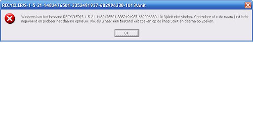

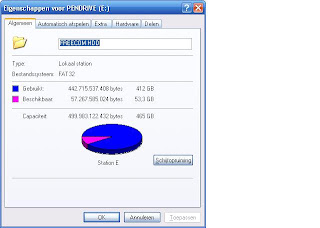

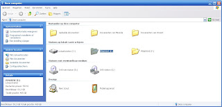

I have a strange problem with my external hard disks. All of a sudden they dont appear as hard drives anymore, but as folders named pendrive, with a fat32 file system.
This goes for both my external hdds, a medion drive n go and a freecom 500gb hdd. I know for sure both are NTFS, because I used them to store dvd movies. If I try to store a dvd now, it says files cant exceed 4gb.
I am using XP professional on a toshiba laptop.

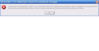

If I try to open the folder by double clicking, the following error is displayed:
Translated, it says it cannot find file RECYCLER\S.....\Anit.

If I plug either hdd in my work laptop (Lenovo T61), I get the same problem, except that I can double click the folder icon to explore the drive.
When I check the properties, it is still (correctly) called freecom hdd, eventhough it is shown as pendrive in my computer.

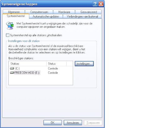

If I check system recovery settings, the hdd is displayed correctly - as a drive and with the correct name.

Anyway, both your external devices identify themselves to UVCView as "Mass Storage USB Device Interface Class", which means they should be assigned drive letters by Windows. I don't understand why they show up as Pendrives, though.
Sector Inspector finds three drives.
PHYSICALDRIVE0 is your boot drive. It has a 79.8 GB NTFS partition (type 07) and a small 263MB type 88 partition. The following URLs suggest that it may be a HP QuickPlay partition or "Linux plaintext partition table":
http://www.ozzu.com/mswindows-forum/won ... 73477.html
http://www.win.tue.nl/~aeb/partitions/p ... pes-1.html
Both the MBR and NTFS boot sector appear to contain original MS code (English).
PHYSICALDRIVE1 is your Drive-n-go. It contains a single 500GB "WIN95 OSR2 FAT32, LBA-mapped" partition, type 0C, with no MBR code, and an MSWIN4.1 FAT32 boot sector, also without code.
PHYSICALDRIVE2 is your Freecom HDD. It contains a single 500GB partition as above, type 0C, but with MS MBR code (English). The boot sector is an MSWIN4.1 FAT32, with German boot code.
So it appears to me that your are mistaken. Both external drives do indeed have FAT32 file systems.
