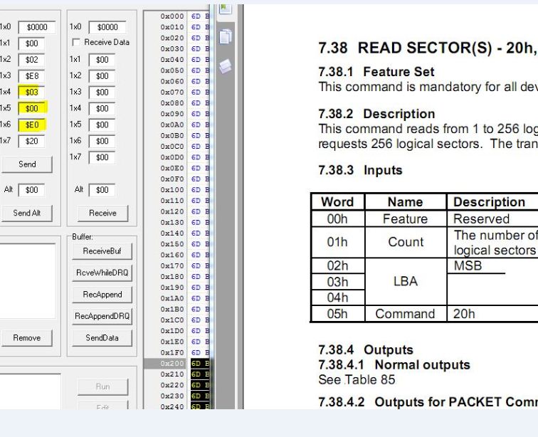

First off, I want to say thanks to all of the helpful people here. As I am reading through the ATA spec, I had a few questions I was hoping on of you all mighty gurus could help with.
Refering to the attached picture and related to the Read Sectors command, am I right by saying
that
1x2 - 1x3 is the number of sectors (744)
1x4 - 1x6 is the starting sector (196832)
Or point to a specific reference regarding the offsets?
Shawn

So as I experiment further, I am finding that x2 is the count and 3/4/5 are LBA. Sound right?

2 is length
3,4,5 and 4 bits of 6 are LBA

so x1 is specifically used for what? The words are identified as an offset from 1? where does 6 come into play? I promise this will be the last question on "this" subject. Thanks again for eveything!

x1 is the number of sectors to read.
3,4,5,6 are the start LBA
Look at the ATA specs .. They will explain the registers in all modes, CHS, LBA and LBA48

Correction - I was ahead of myself.
1 is the Features Register.. 2 is the sector count register :)
