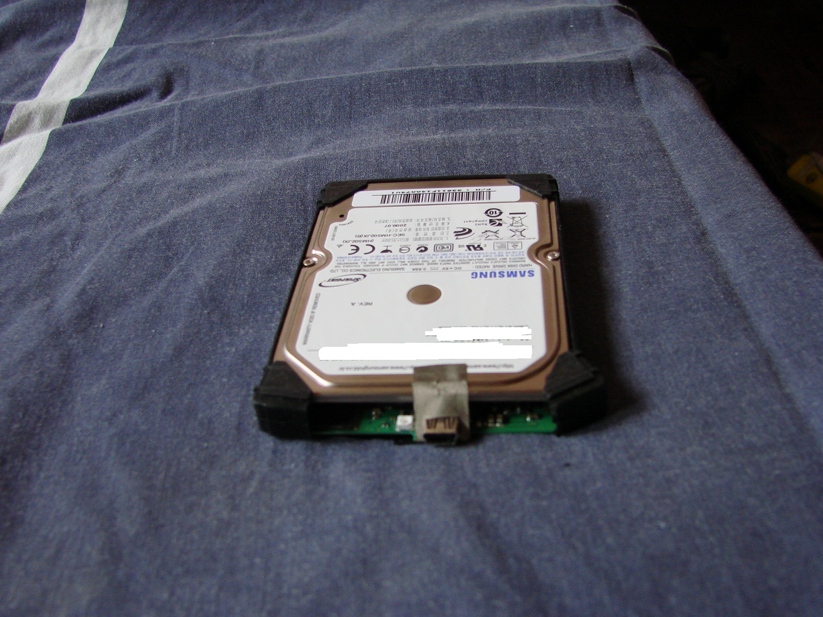

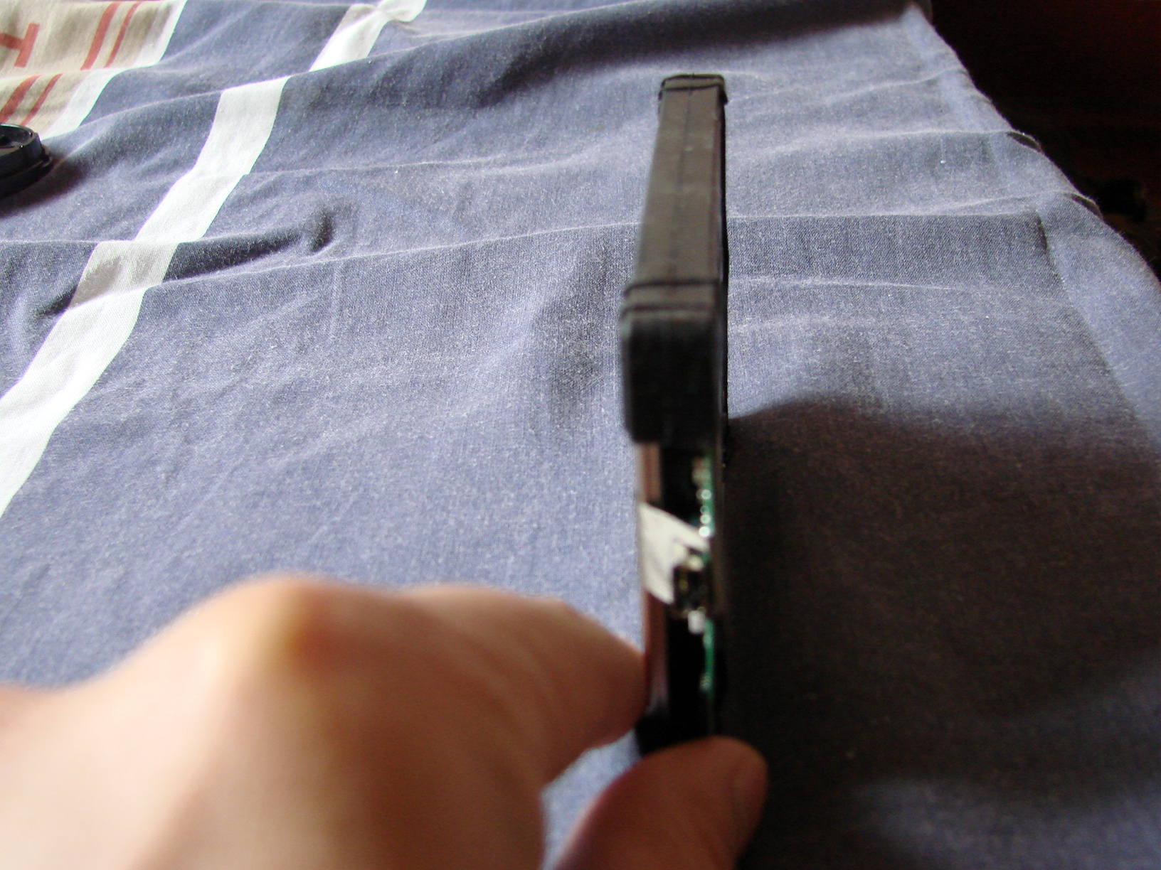

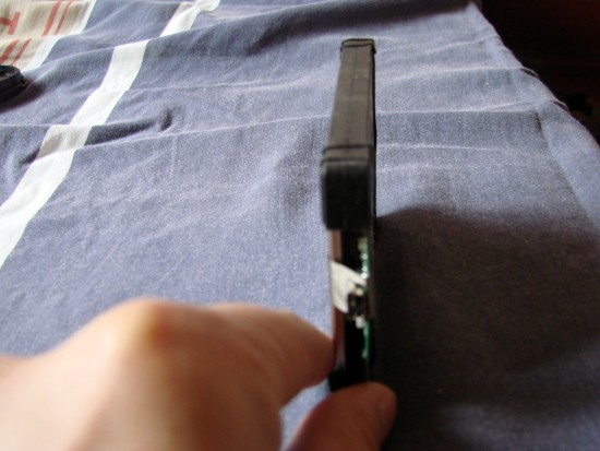

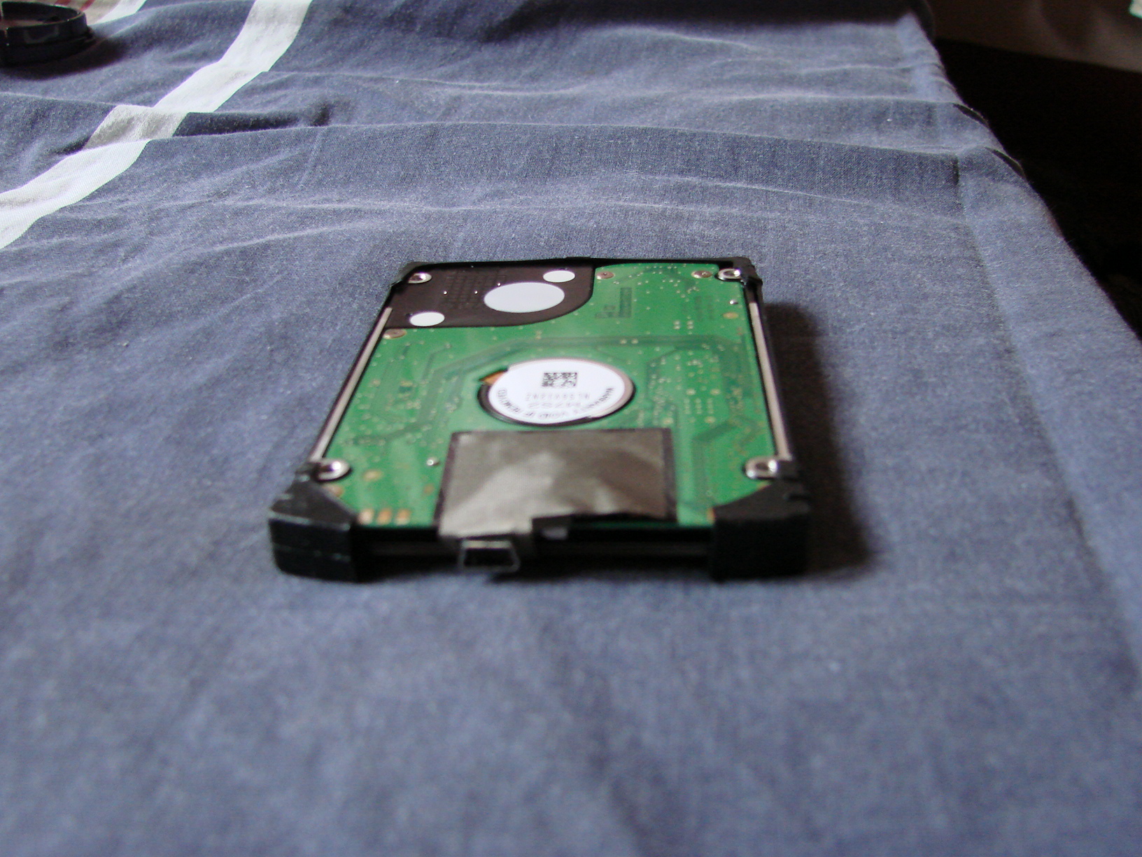

I have the same problem with techu.e_lm_70 how did you shock the device on which side was the hdd on when you gave the shock on start-up or on what position should i shock it and how hard would the shock be?So that i can try it myself.we tried to freeze the hdd but to no avail.I have to recover some very important files on it.
File comment: this side/position?
File comment: or this position/side?
File comment: this position or the other side of i?
Hi
Sorry for late reply ... I don't check this site very often ...
Anyhow ... as somebody reply before ... be advised that you can make more mess then recovery in this action ... so ... it is up to you ... in my case I did not care much about louse the warranty ... and I did know that it would have been complicated and expensive for me find a different way to recover data ...
So ... this is exactly what I did ... honestly I dont remember the exact direction I did use for "shock" my HD .. but this is how I did:
- I was keeping it in one hand, and immediately after plug the usb for power it up ... I did move the hand with my HD to hit my other hand that was still ... making around 20-30cm movement with my hand with the HD on it ... so the shock was not too hard
- The movement direction was keeping the HD flat ... so the show was only in the horizontal direction ... you don't want to shock the HD up/down ... you just want it to move horizontal ... in the same direction that the head of the HD is allowed to move
So In case the above skema direction help ... this is the direction of the movement ...
Good luck
e_lm_70
ps: I'm using my HD since then without any problem ... not a single sector was find damage ... now I just take care more to don't make it to move at all while I'm using it.

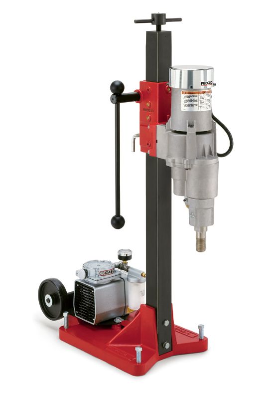

 Post subject: Re: Samsung s2 portable 500gb dead?
PostPosted: April 7th, 2010, 16:49
Posts: 872
Location: Dublin
Try one of these badboys...
Data Recovery Ireland
PostPosted: April 7th, 2010, 16:59
Joined: April 6th, 2010, 22:04
Posts: 8
Location: London
hehe...
is it possible to buy just the head for a drill?
PostPosted: April 7th, 2010, 17:13
Posts: 872
Location: Dublin
seriously though, you won't be able to DIY a spindle repair unless you want to spend money on custom tooling. Even then, your chances would be low. Either forget it or send it to a pro, but your efforts thus far will have doubled the cost of recovery - and voided your warranty.
