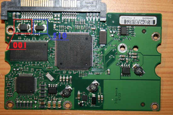

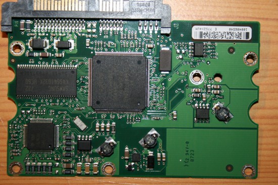

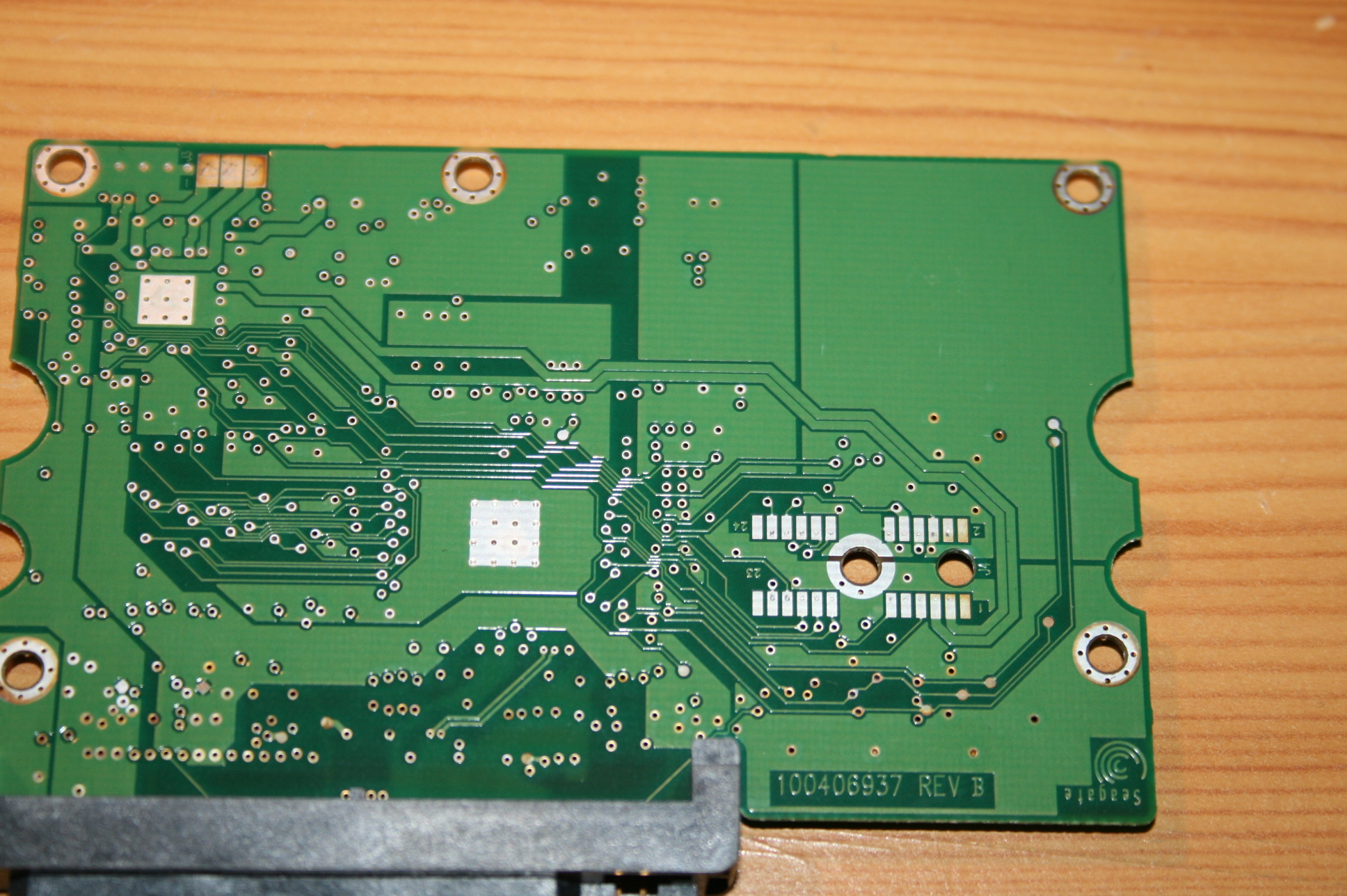

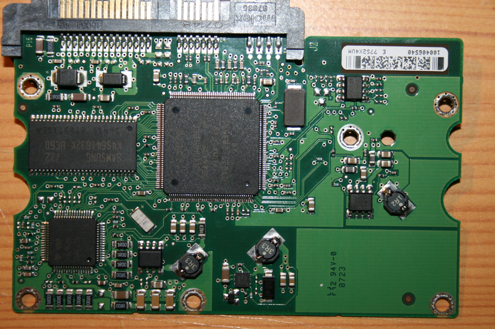

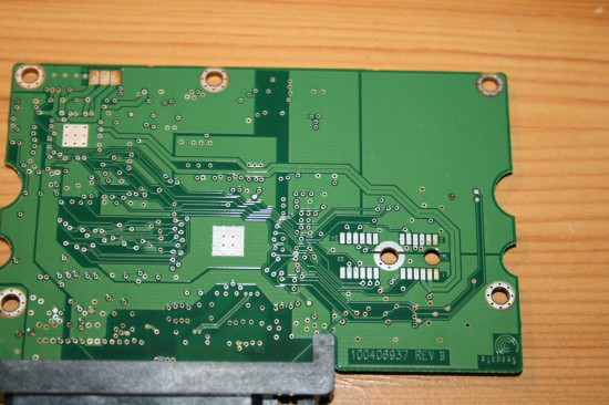

I made some photos of the PCB, because i cant find any burned or molten diodes nor resistors!
maybe you guys can point me the points out whom are to test ??? like i found on the Backside Pic a place on the upper right, that looks like it got really hot??
THANKS i.a.

bottom picture, tvs are on the top left beneath the power connector. check with multimeter if their are shortened. you can also plug in a sata power adapter cable (from normal 4 pin power to sata and measure between ground and 5/12 V if there is a shortage).

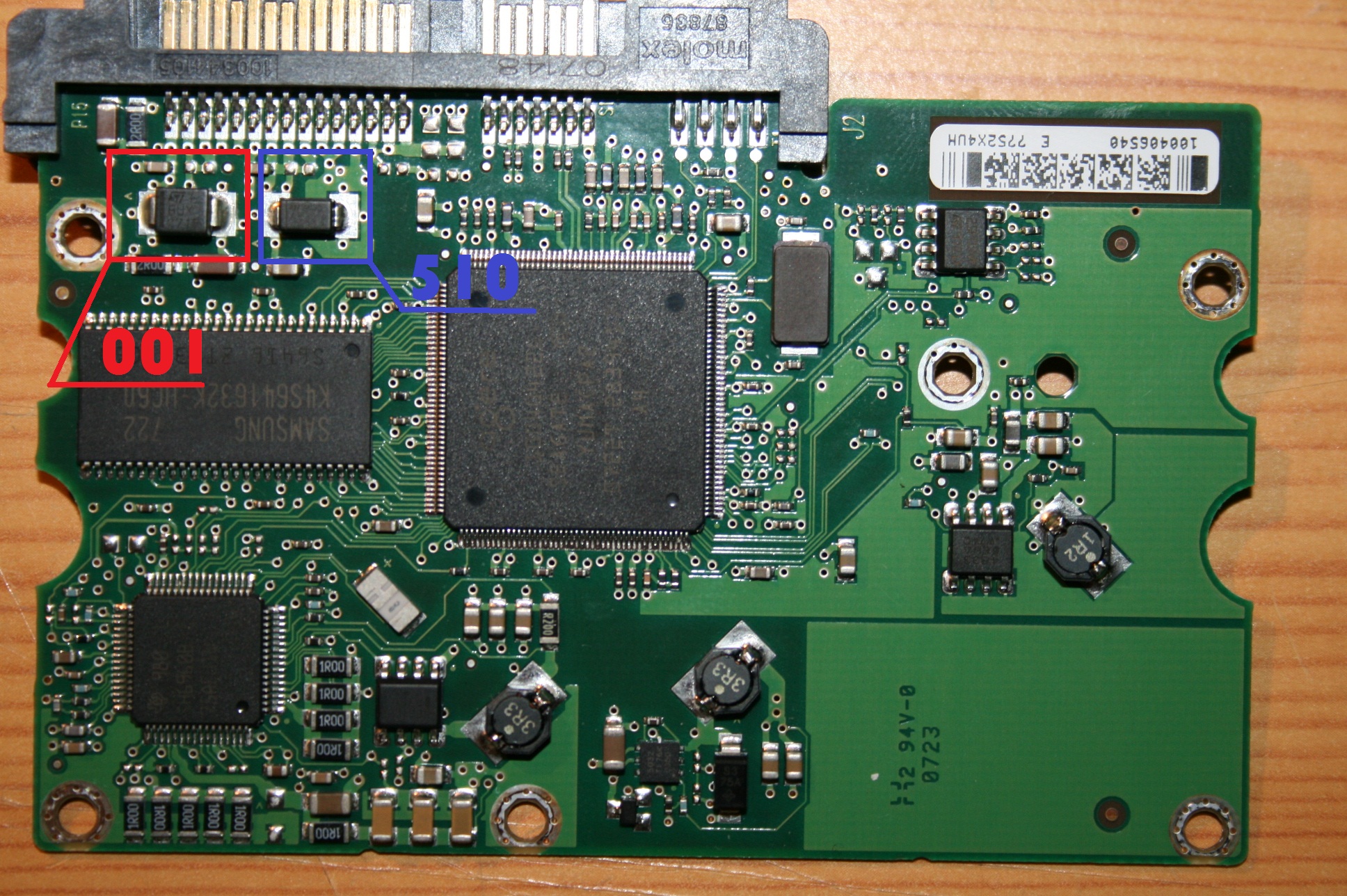

OK... Thx again for the helpful hints...
I hope i did the right messuring with the Multimeter :?
So i turned the wheel of the Mm to the Diode sign and pluged the red into V&mA and the black to COM... ( Pic )
The results are shown on the PCB Picture... The left one is 001 (mA???) and the right one shows 510... constantly !
I hope i measured right and again hope you guys can help me once again... :|
Thanks a lot...
Fuddster
Thanks a lot...
Fuddster
The left one (12V TVS diode) is shorted. This is usually what happens when you plug a 19V laptop adapter into a 12V external HD.
Desolder the faulty diode, or cut it out with side cutters. Just remember you will no longer have any protection on the 12V rail.
