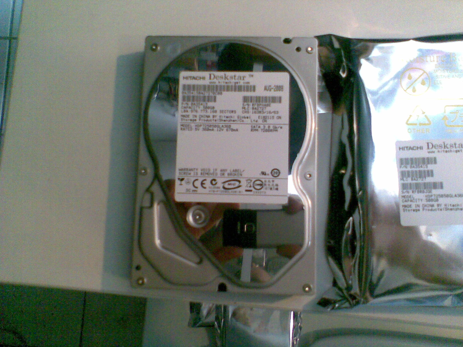

What do you think?
I have checked, there is no screw under the lid! :shock:
Janos

you mean under the sticker?
I noticed it too on GLA drives
Maybe they have their own way to check opened drive or maybe they don't care anymore
I'll try to ask Hitachi guy maybe he knows

Yes, i mean the sticker, just missed the word, sorry.
The opening is important for as as well, not only the manufacturer!
How do we knowing anymore the drive was opened, or not? :shock:
Janos

If somebody ask me, i think, this is only a mess when the sticker was designed, but anyway, it is really strange, and interesting.
There is no vacum in the drive, and the seal checking is clearly not enough for testing the opening.
The only problem for me is when one drive arrives for dr.
If the drive was opened, usually, i will ask the customer for a little preliminary price, caused by possible artifical problems...
But in this way, what can i do? :shock:
If i start the drive without opening, this is too high risk.
If i open the drive in all cases, and check, this is not a free task in my lab, and possibly the customer wont pay this after a bad news...
But this is unfair for paying all the cases on this family when arrives... :|

Almost all drives we get have some sticker covering the "heads-screw", in most cases the sticker covers this one. As soon as this sticker is not there, we check the screws under a magnifying glass for traces/scratches and we look at the side between the cover and the casing if we can see any damages to the rubber sealing. These marks (certainly combined) make clear that the drive has previously been opened. This means in our company that we go for an internal check in our cleanroom to see if there are any damages.
We had it several times a customer (or other recover "expert") attemted to open the drive by jamming a screwdriver or another sharp tool between cover and casing and in this way make some nice scratches on the platter. Our customers get a nice report out of these jobs, including pictures and explanation why they have been fools not to come to us first.
This external check is combined with smelling for burned chips (not always visibly burned), and after that the multimeter comes and the rest of the diagnosis-process. My advise: As soon as you even slightly suspect that a drive might have been opened, go for an internal check. Nothing is lost, just a little time. But it saves you a lot of troubles in the rest of the DR-process.
