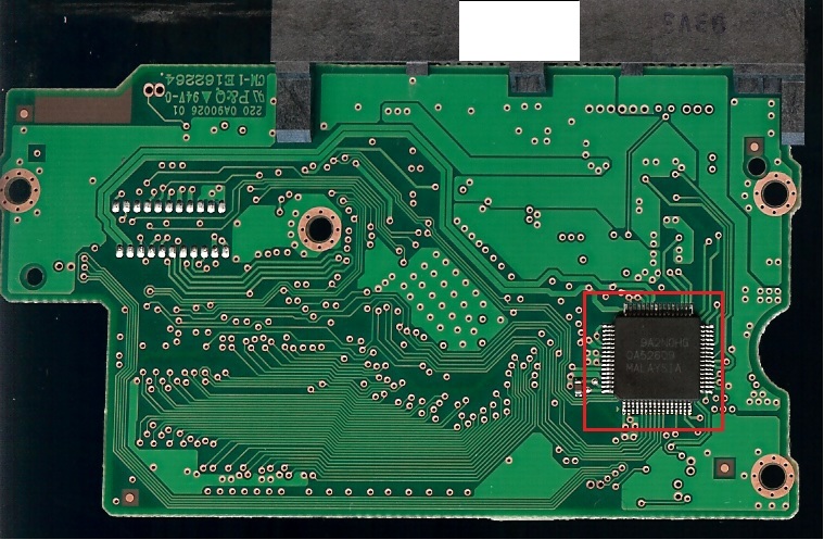

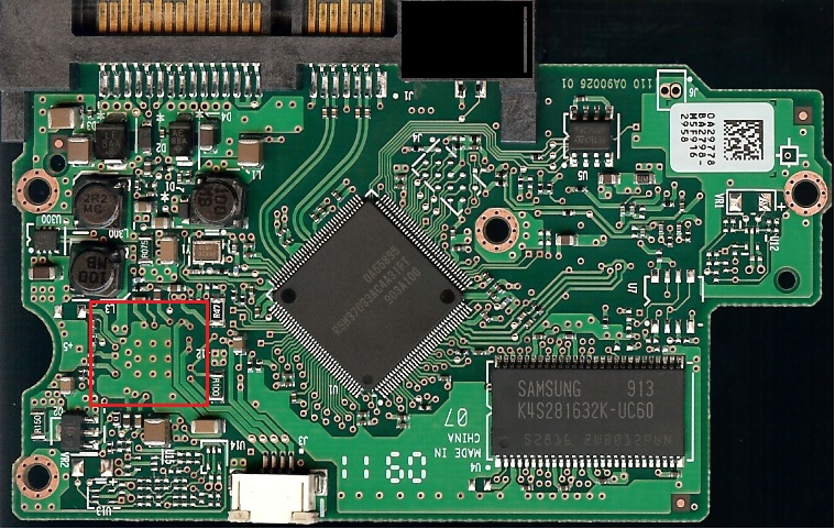

Have this disk that the first it looks like a motor stuck.
When i open it i see that the motor was not stuck, them i give power with the disk open and help the spindle to spin.
Close the lid , take to the UDMA and try to power it it spin but no ID.
I notice that the PCB was a little "HOT" in the red box in the pictures.
Any help will be great.

I have seen similar but in .11 1.5TB seagate.
The spindle is damaged and requires more power to spin than the pcb was designed.
If the damage lets the axis to vibrate enough than the eccentricity is the additional problem.
If the vibration is too much the heads can damage as well.

I could resolve the PCB problem, the spindle was ok, now the disk spin and i could get ID.
I am cloning head 0 1 2 , head 3 is making some noises, will try it lather.

Zebong we i had check this family HDP with head crash at the middle of platters be carefull
