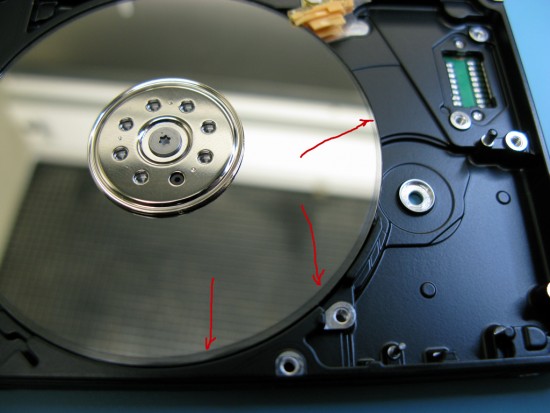

Hi Guys
I have a Hitachi HTS723232L9SA60 with H3 damage and scratch the outter edge of the platter (see attached).
Just wondering any chance of recovering the data, thinking of head exchange with new donor drive......but not sure if the damage area has SA.
Thanks.
 Post subject: Re: Platter damage on HTS723232L9SA60
PostPosted: January 6th, 2010, 2:07
Posts: 1336
Hello TerraNova,
I think SA is somewhere in the middle of this drive. Maybe someone else can confirm this for you.
PostPosted: January 6th, 2010, 2:16
Joined: February 1st, 2008, 17:01
Posts: 208
Location: Europe Greece
Nothing to do SA Area there.
no bad head before that , bad height yes!
XRONIS
T3 Professional Data Recovery
http://www.t3-recovery.com
PostPosted: January 6th, 2010, 5:32
Posts: 1493
Looks like parking zone has caused problem. Heads might be ok?
PostPosted: January 6th, 2010, 5:44
Posts: 1898
Location: In your hard drive.
I'm guessing this lost #3 head and got stuck between the platter and head ramp?
PostPosted: January 6th, 2010, 8:27
Posts: 1241
Location: inside ROM
H3 virtually grinded off, no more h3 :D , what do you guys think, head exchange will work?
Ramp is ok, H3 gone, the rest of the heads are ok.
PostPosted: January 6th, 2010, 9:33
Posts: 1493
head exchange should work. might have to clean platters though!
PostPosted: January 6th, 2010, 10:27
Joined: April 10th, 2007, 9:53
Posts: 335
Had a similar problem with a WD. Those heads just seem to pop off every once in a while for no reason. The head got jammed under the parking ramp and scored the platter. It was a good recovery though once all the debris was cleaned out and the heads replaced. The area where the scoring has occured holds no data, and as long as the new heads stay off of it, you should be fine. Let us know how it goes.
PostPosted: January 6th, 2010, 23:28
Posts: 1241
Thank you guys for helping out, managed to recover most crucial data.
I made a limitter to prevent head from moving to the damage area and some tweaking in DE.
PostPosted: January 7th, 2010, 19:05
Posts: 1898
If you look at the picture you can clearly see that the damage was to the unused area under the plastic head ramp. This hd lost a head and got stuck at the ramp in my opinion. The heads are so small its easily lost or overlooked. :shock:

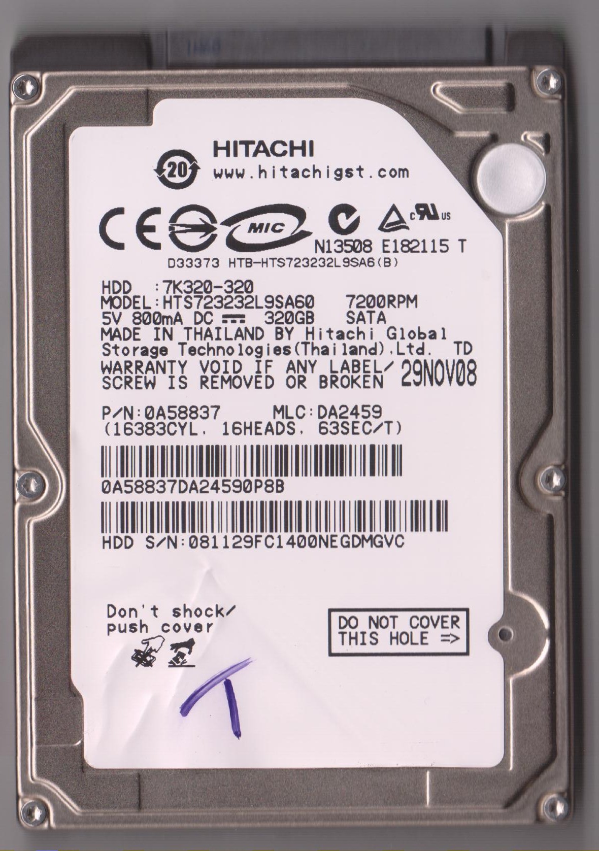

Please Help
Hello Guys I have Problem With HTS723232L9SA60
i need head
My hard Disk is
HDD 7K320-320
Model : HTS723232L9SA60 7200RPM
P/N : 0A58837
MLC : DA2459
29NOV08
I am searching For New One to recoverd My data
email me Taha_Srouji at hotmail
Send by Westron Union the Money
Please Help me
