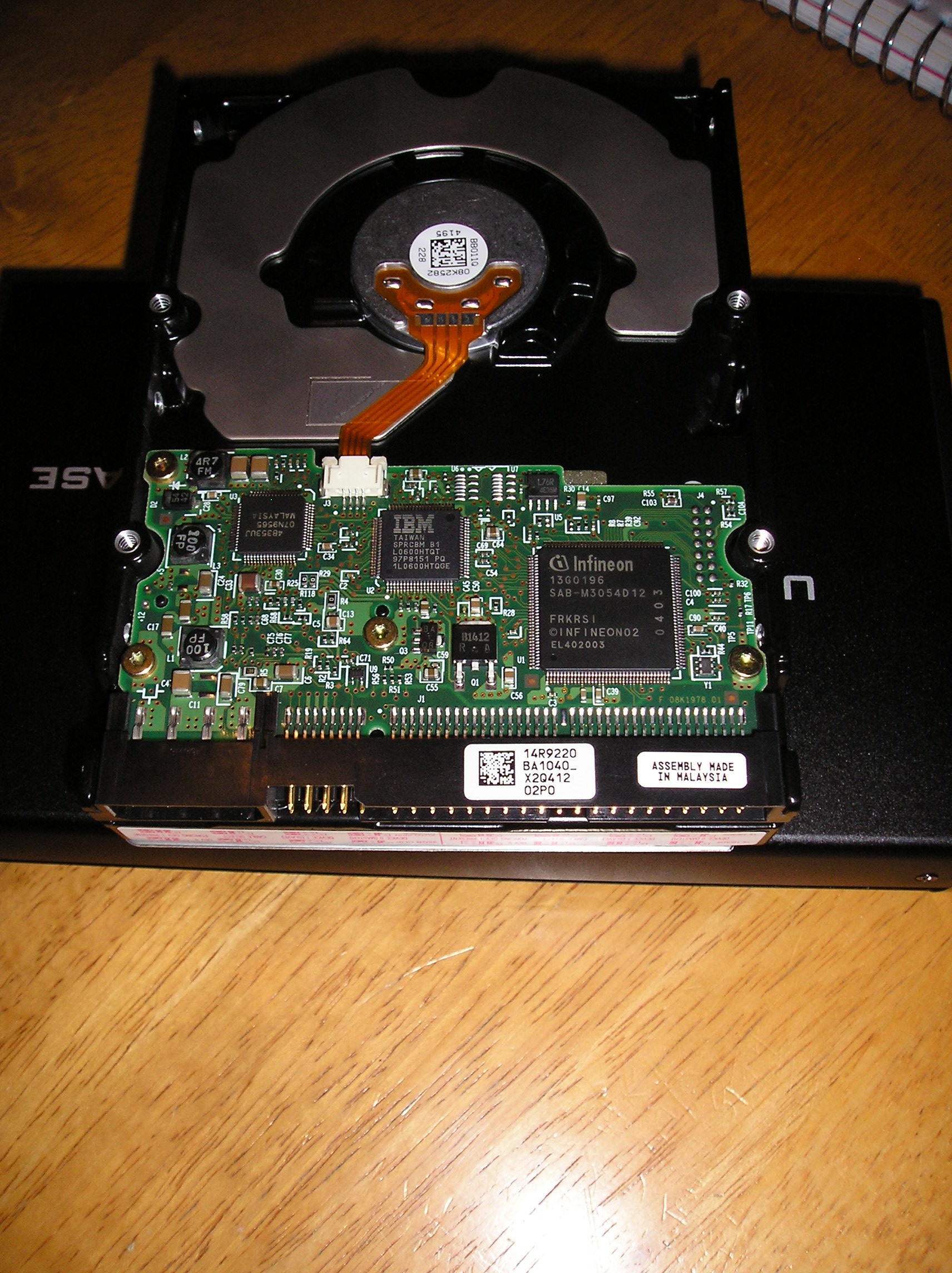

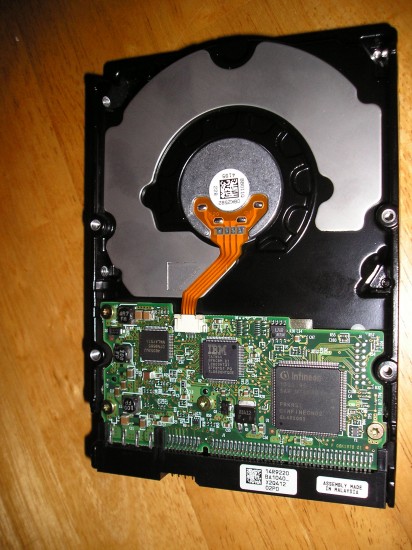

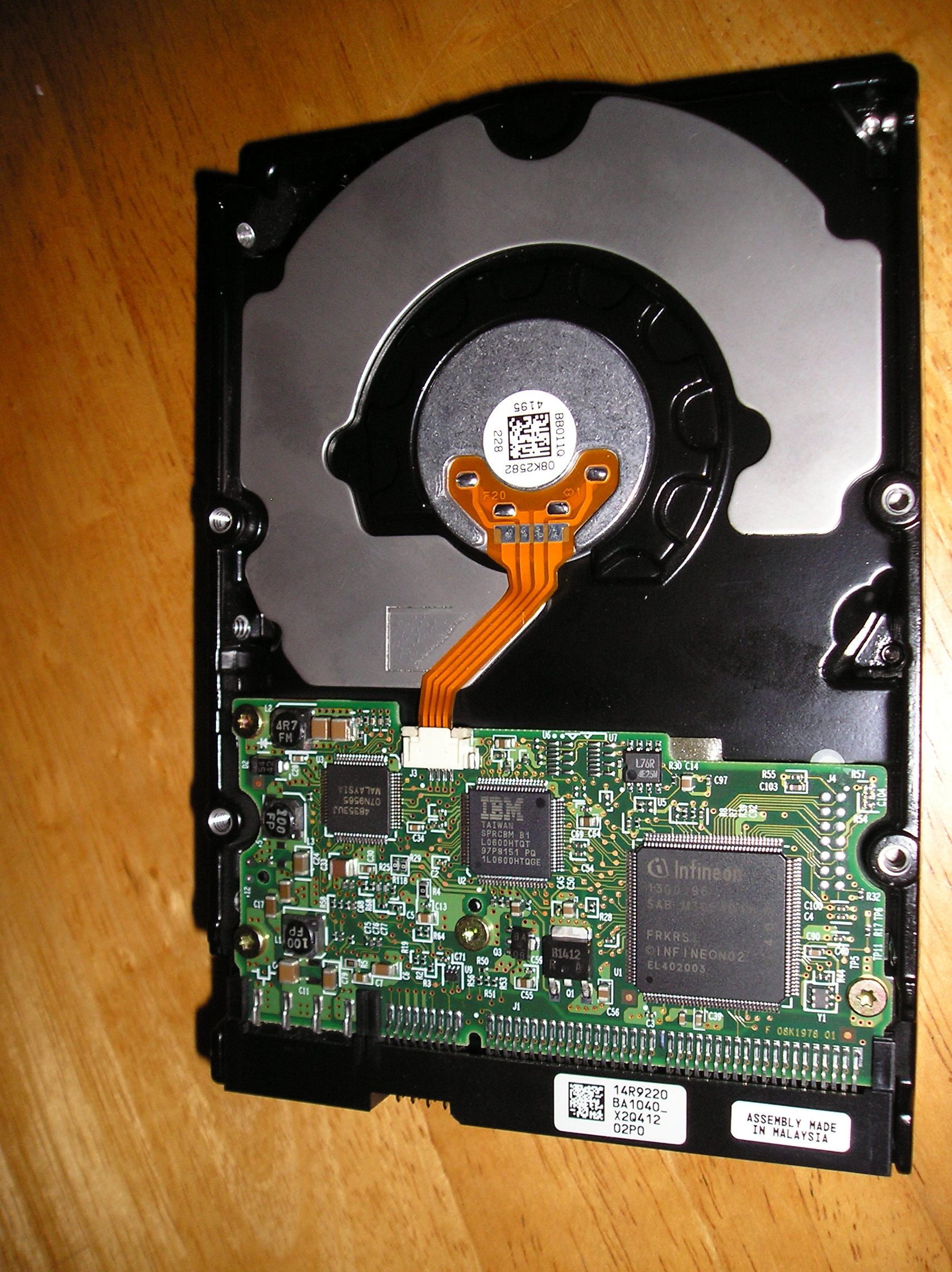

OK - a day later....here are some photos of my hard drive.

I'm no DR guy, but it seems to me that a PCB swap will probably work, as long as you transfer the 8-pin serial EEPROM chip at U5 (L76R) from patient to donor.
However, if this were my drive, I would check the onboard supply voltages, and I would verify continuity in the motor windings.
There are three zero-ohm links (R25, R29, R4) that arouse my curiosity, too.

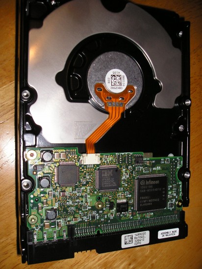

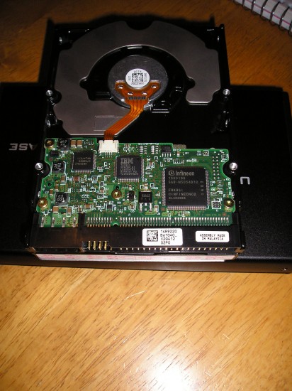

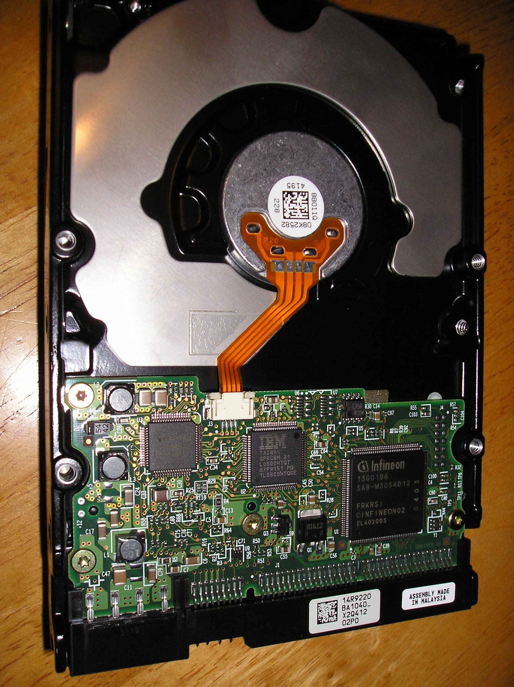

foster182 wrote:
Hey there, this is kind of off topic.
but i am trying to find one of these hd's because i blew a chip on the pcb on mine a while back.
Upload a detailed photo of the component side of the PCB.

That's the motor control chip. I was hoping to see something repairable. :-(
