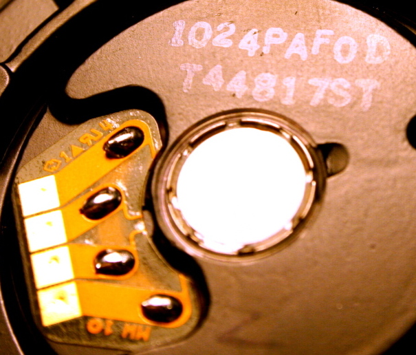

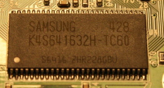

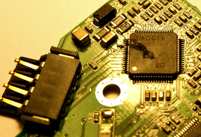

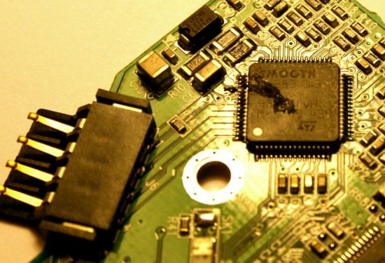

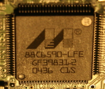

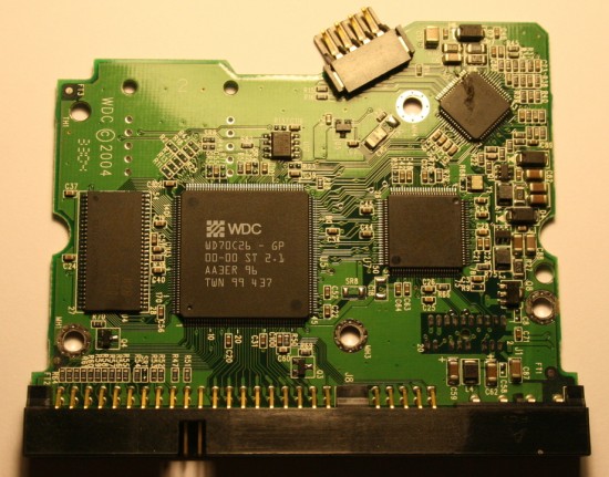

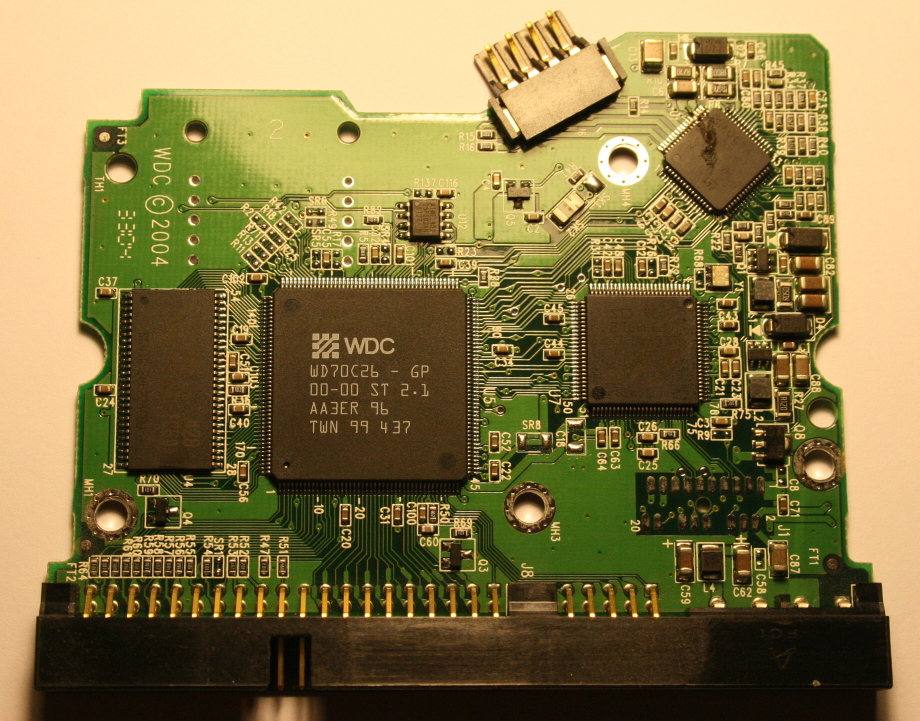

Here we go again, finally managed to shot a few picts of the deceased (ok... critical condition) HD.
Take a look at the burnt motor controller, typical, it blew a leg out of the chip ! ! ! but the PCB trace still intact.
II'll check the diodes to see if the sacrifice themselves to protect.
if so, I'll replace them with donor diodes w the same specs from other donor WD HD.
But... the big question stills... did the other IC's survive, how to tell.
The motor IC drive ... question: is it generic for a series of WD HD's, if it is,
could it be swapped (for another with the same numbers) ..
again from a WD HD donor?..
too many questions together.. lets see one at the time.
.. now the picts

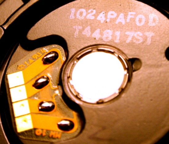

A question that comes to my mind is if the motor itself suffered damage from the high current that blew the IC ???
How to test the motor, is only a set of coils that can be tested measuring resistance, or has it some more internal electronics.??

File comment: Now the toasted, literally blown IC that looks suspiciously close to the motor, so it will be the motor driver IC, many PCB traces connecting to it.
File comment: Motor connector & ID markings?
File comment: Other IC, not the main processor... that one can b e seen clearly in the board picture.
File comment: memory IC..? ? type ?

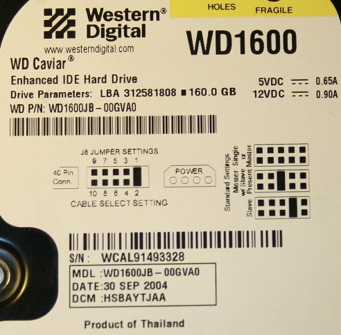

File comment: Main HD label

Sorry, I misread your first post. I thought you had interchanged the +12V and +5V rails.
Anyway, I'm only an observer at these forums, but it appears to me that there are no protection diodes on your PCB, at least not near the power socket where you would normally expect to find them.
The motor is a three phase DC motor. I believe its speed is detected by sensing the back EMF of the windings. The 4 pins connect to the 3 phases plus common.
Here is a datasheet for a first generation SMOOTH controller (L7250):
http://www.datasheetcatalog.org/datashe ... Xyuswx.pdf
http://wandrew.regruppa.ru/PCInfo/TechDoc/L7250(Smooth).pdf
The application circuit may give you an insight into the motor's construction.
When you swap the PCB, you may need to transplant the serial EEPROM (U12, AT25F1024 ?) from patient to donor.
http://www.atmel.com/dyn/resources/prod ... oc1440.pdf
 Post subject: Re: can a WD1600JB-00GVA0 be repaired with a PC swap ?
PostPosted: January 10th, 2010, 22:43
Joined: February 17th, 2009, 13:01
Posts: 111
Location: Bogotá, D.C.
Desoldering U12 from patient PCB and soldering to Donor PCB.. simple

Just be careful not to overheat the U12, as you could lose ROM contents if heated too much. Also be weary of too much heat on the PCB as you can warp layers
