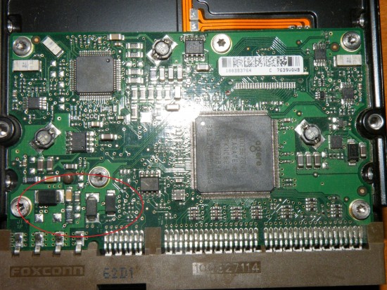

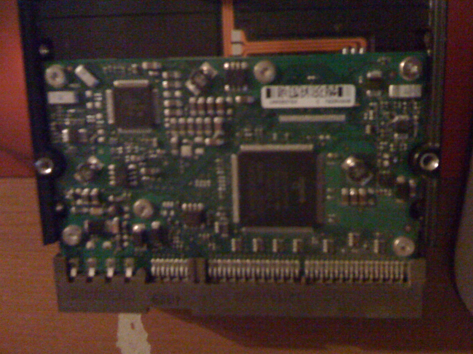

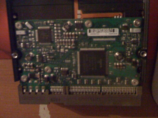

I'm looking for a PCB main board for a:
Barracuda 7200.9
500 Gbytes
Model: ST3500641A
Firmware: 3.AAH
Any help would be apreciated.
Here's a picture of the main board.

Could you retake a bit better pics??? Need to be able to see the numbers on the PCB. The label and the 9 digit number and the numbers on the chip!!!
 Post subject: Re: Need Help with Seagate Barracuda 7200.9 500 Gbytes - dead
PostPosted: January 18th, 2010, 17:14
Posts: 17341
pinoyxprss wrote:
I'm looking for a PCB main board for a Barracuda 7200.9
What's the symptom?
What did you do, if anything, to damage the original board?

pinoyxprss wrote:
when I plug it in PC, my PC won't turn on, I hear a little fizzing sound like your frying something for a second and it would stop so I turn off the power supply and turn back on to try again and it does the exact same thing.
Your HD has a short circuit, probably on the +12V input.
If you have a multimeter, set it to the 200 ohms range and measure the resistances of the two TVS diodes near the power connector. If one measures zero ohms, then desolder it or snip it out with side cutters. The drive will run quite happily without it, albeit without protection on the affected supply rail. Just be sure your power supply can be trusted.
See the following article for help in identifying the components:
http://hddscan.com/doc/HDD_from_inside.html

pinoyxprss wrote:
The NAS has extended warranty and I don't wan't to damage the PCD so i can send it in, I just need another PCB so I can get my stuff out of the drive. The NAS is dead too so I have to send it in regardless.
A straight PCB swap may not work.
You will probably need to transplant the 8-pin serial EEPROM chip from patient to donor. It stores calibration data determined at the factory.
The easiest thing to do is to desolder one side of the TVS diode and lift it away from the pad. Then retrieve your data, and resolder the diode.

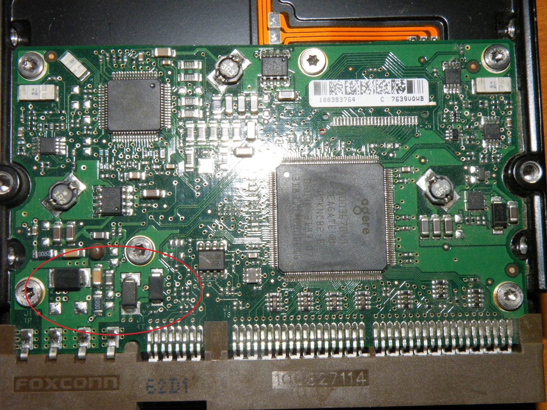

fzabkar
I was looking at the link you posted and i'm a little confuse.. the link shows 2 TVS and mine looks like it has three.. I checked with multimeter at 200OHM and the biggest one on the left is showing .5 and the other two are showing numbers then back to zero.
PostPosted: January 31st, 2010, 18:50
Joined: January 30th, 2010, 16:23
Posts: 31
Location: Bavaria
pinoyxprss wrote:
fzabkar
Those diodes are connected between a voltage source and GND. And in case of overvoltage, they short that very voltage supply to GND to save the rest of the circuit.
That means to find the TVS that actually burnt through, just check resistances to ground of both solder contacts on each TVS. Each TVS is soldered in on both ends, i.e. 2 solder contacts per TVS. Now the shorted ones will show a resistance near ZERO (for example 0.7) Ohms to GND on both ends and the ones that are still OK will show near ZERO Ohms on one and MUCH higher resistance numbers on the other end. ;)
PostPosted: January 31st, 2010, 19:37
Posts: 17341
pinoyxprss wrote:
fzabkar
Remove the one on the left. I'm not sure what the third part is, but it could be a capacitor.
If you can read the markings on the parts, let us know.

Location: CA, USA
the one on the left says AF53 PT..the one in middle doesnt have anything.. one on the right says 23L58..i attached the picture of the board..i think i forgot last time
PostPosted: January 31st, 2010, 20:44
Posts: 17341
Sorry, I can't find a datasheet for those marking codes. Anyway, the part on the left appears to made by Fairchild who do make SMBJ series (600W) TVS diodes. Remove it and you should hopefully be OK.
Good luck.

Ok, clipped that IC, it worked, only problem is windows won't read the format the HDD is on...the NAS is also shot...its a Maxtor Fusion 500gb .. is there any way of extracting the files or having windows read the disk?
