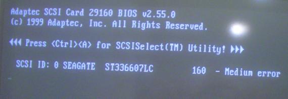

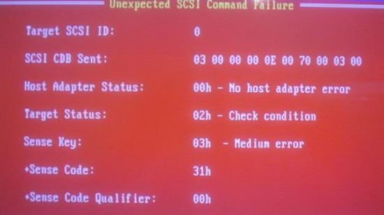

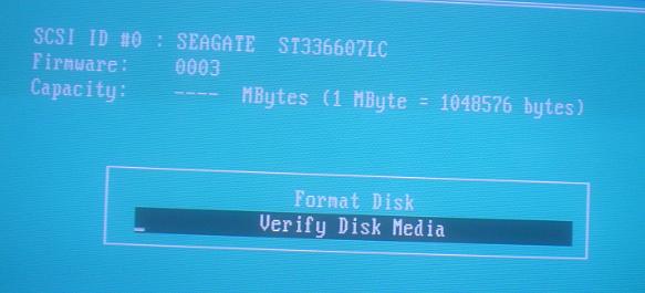

 Post subject: ST336607LC
PostPosted: January 22nd, 2010, 8:28
Posts: 1060
ERRORS..

Probably translator

Yep same syntomphs, of translator problems 03 31 00
