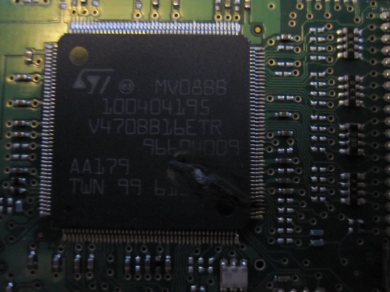

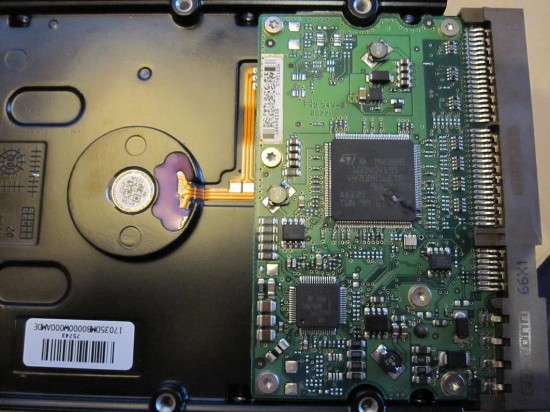

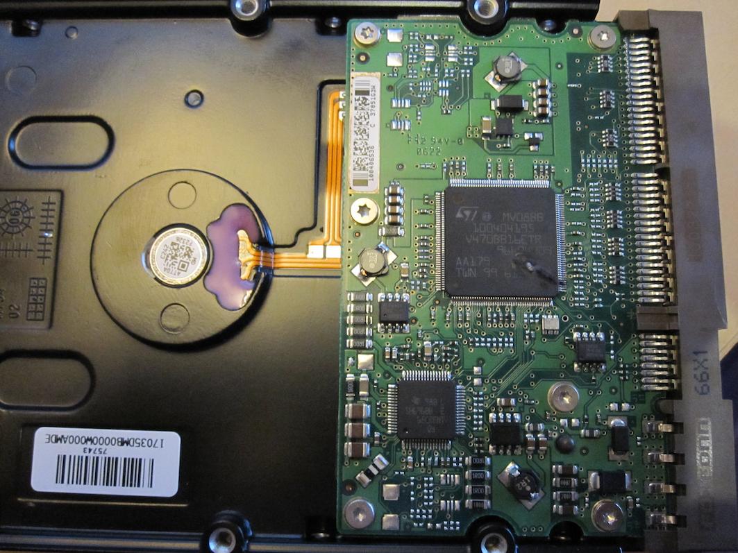

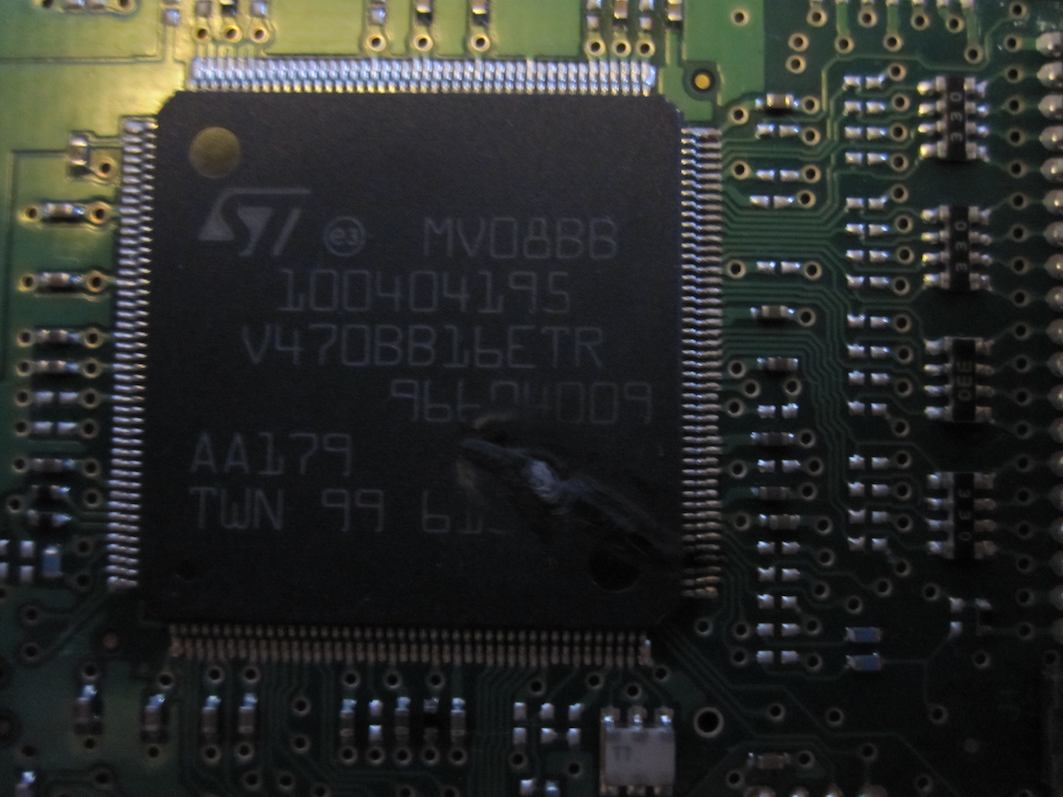

Forgive me for being a newbie, but I have a Seagate Barracuda 7200.10 320gb, which stopped spinning recently. When I opened it up I noticed that what looks like the main chip has burnt out.
The chip is marked down as:-
ST(logo) MV08BB
100404195
V470BB16ETR
96604009
AA179
TWN 99 6??
I have included a couple of photos.
Is the chip the real problem (that is, if that chip is gone one the disk wouldn't spin?)
Is it possible to get a replacement chip and solder it in? Or get a new board? If so, where is the best place to get this?
I only really want to be able to get the data off, I'm not bothered about a full repair.

 Post subject: Re: Seagate Barracuda 7200.10 320gb Main Chip Burnt Out
PostPosted: January 23rd, 2010, 17:01
Posts: 1721
that is the motor controller IC chip. Yes this will cause your drive not to spin up
Iorana Haraharaini
PostPosted: January 23rd, 2010, 17:58
Posts: 4854
No, that is the microprocessor ASIC.
Apart from that probably other components and maybe the preamp is also damaged.
PostPosted: January 23rd, 2010, 22:41
Posts: 1151
funny answer. it's MCU chip! 8) i have this PCB in stock. please contact me by email or MSN messenger if need it.
data recovery service[/b]
PostPosted: January 24th, 2010, 5:28
I can help with a recovery in UK, should be reasonable price if the drives not been tinkered with.
PM me if interested.
PostPosted: January 24th, 2010, 14:59
Posts: 2288
Location: In ur HDD !
Its rare to see this chip burn .
PostPosted: January 24th, 2010, 15:02
Yes it is, usually it's the motor chip that burns.
Maybe the pins got shorted by mis-handling whilst powered-on?
PostPosted: January 25th, 2010, 19:43
Posts: 4854
I think it was used in a removable rack and either it got shorted inside, or was plugged to the wrong socket...
