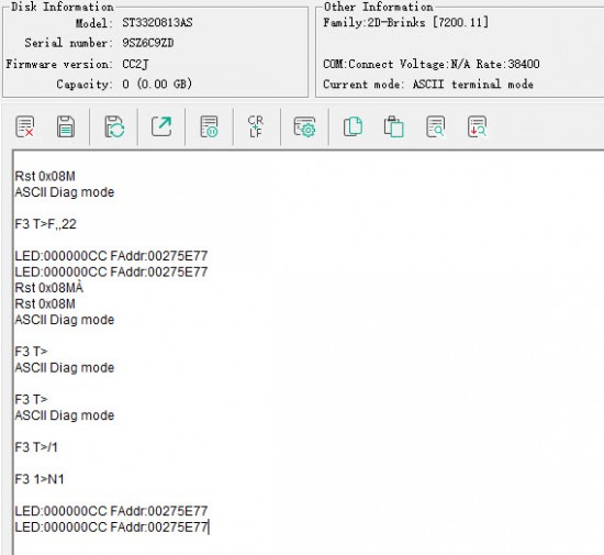

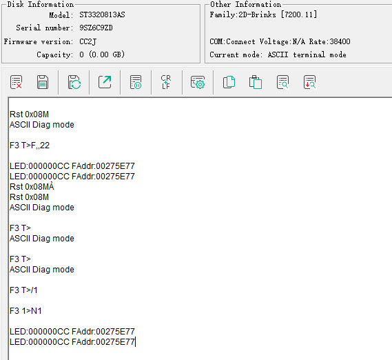

Same Issue with me , DRD DSC
But any command given to terminal give LED error
Tried Reading Sys Files through ATA/Serial , Gives LED error as well

Wow, a .11 BSY bug! Haven't seen one for years! Those were the days!
As far as I remember, the DIY approach was:
- Isolate PCB from HDD with a business card
- Power on the drive
- F3 T>/2Z
- Remove the card and screw the screws
- F3 2> U
- F3 2> /Tm0,6,2,,,,,22
In some rare occassions SMART reset was needed (/1N1) and some people said clear g-list also needed but I don't find it a good idea without proper checks.
DON'T TRY THIS ON ANYTHING OTHER THAN .11!! Trying it on a .12 will give you partial access problem and the translator will have to be re-created with nrg list into account!

In fact, that command can give partial access on .11 as well (like my very first .11 case).

And after F3 2>U read system files or modules?
Before F3 T>Tm0.....
 Post subject: Re: Seagate 7200.11 ST3320613as wont initialize showing 0-
PostPosted: March 20th, 2024, 15:29
Posts: 1754
Location: Verona, Italy
If i remember well, on some of this 7200.11 it is needed to insulate motor instead HDA.
On some others, it is needed to completely remove pcb from hdd.
