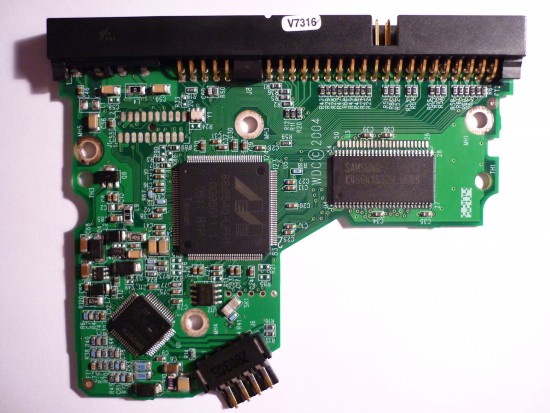

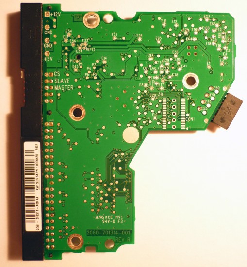

Hello everybody!
This is my first post in this forum but I already read some threads here to look for a solution to my problem. It helped a lot and I could find good information about how replacing a PCB and what you have to look for when analysing for the fried parts of it.

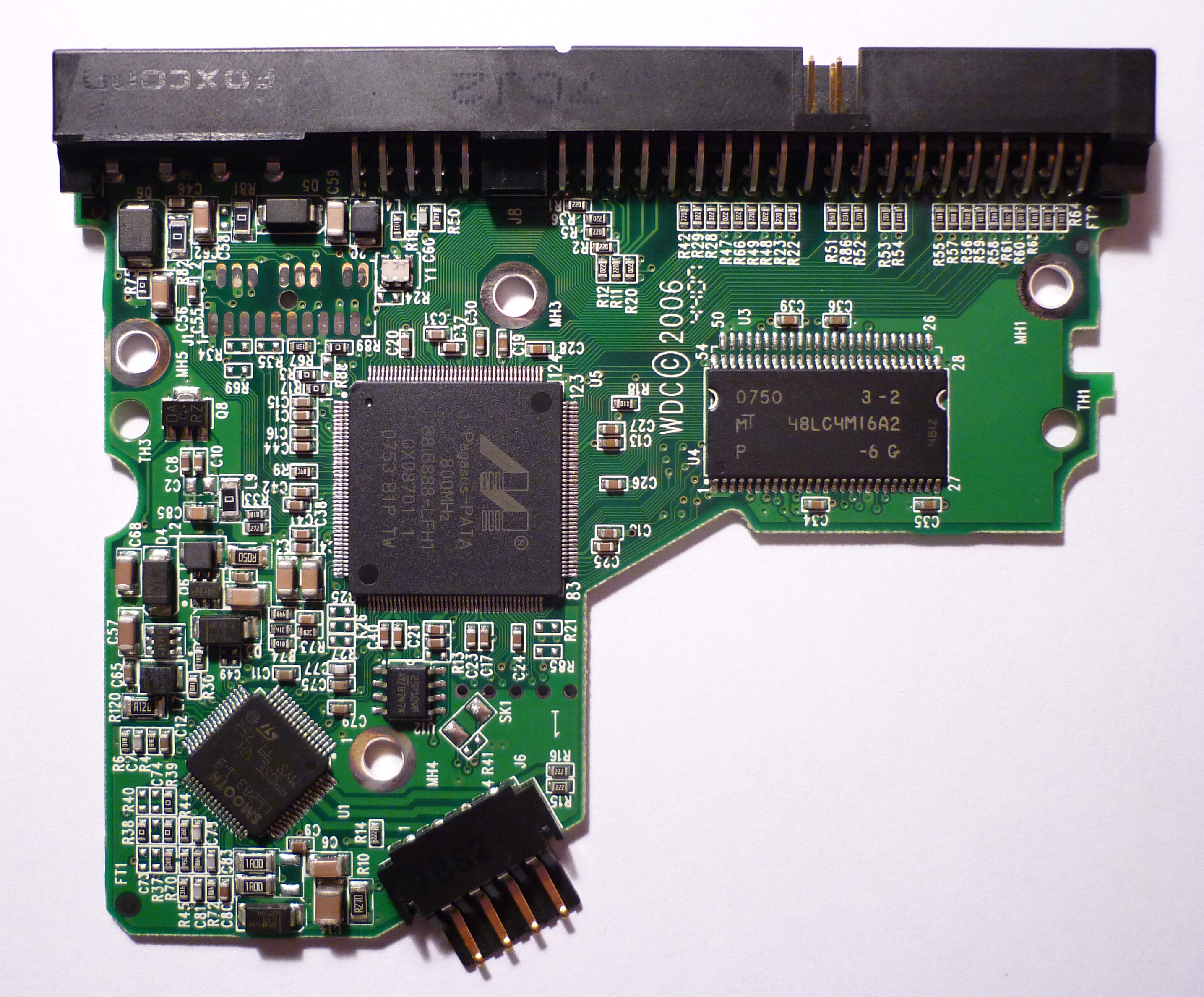

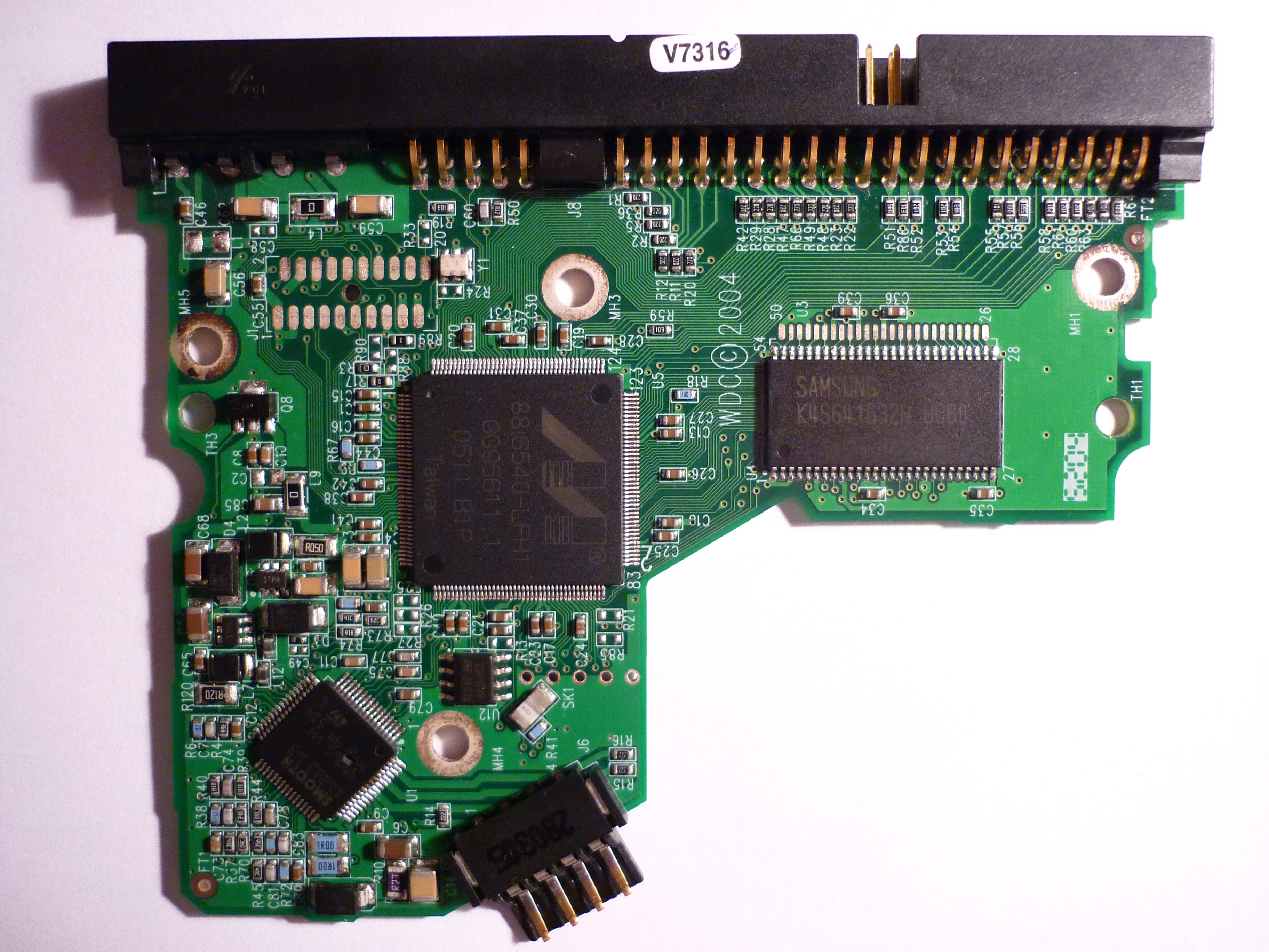

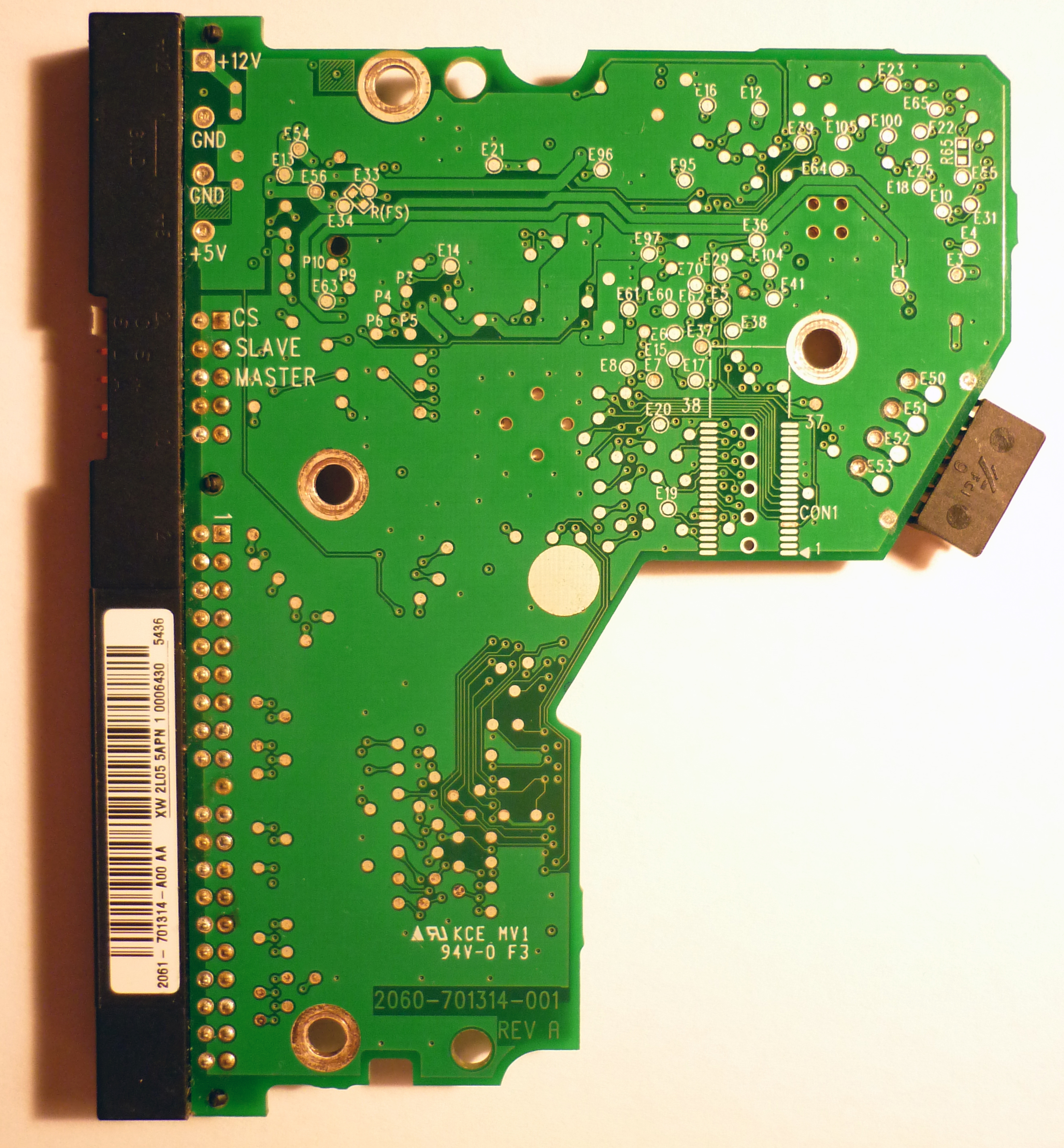

To my problem. My old external 300GB, 3.5" Western Digital WD3000JB-00KFA0 IDE apparently took some damage in its enclosure and the pcb fried. This was some years ago, drive MFR is MAY 2005, and at this time I had no idea of how to look at a HDD for finding a DIY repair solution. As I didn't have the money to get it repaired by a professional, I put the drive in a box for years and discovered it again some days ago.
So I took off the PCB, the overall look of it seems fine to me except for the SMOOTH-chip. It has a big burning hole in it's middle and some of the pins are of a slight brown colour. My first attempt was to look for the same drive to get a matching PCB, this didn't work for me because here in Germany even in 2007, when the PCB fried, there was no such drive on the internet. I searched some sites recently but there a all in Hong Kong, Malaysia or the US. No option for me and the PCB's are quite overpriced.
After this I went to a store which sells old hardware and told them what I was searching for. The didn't have a drive matching my PCB number (2060-701314-001 REV A) but a newer 40GB WD400JB-00JJC0 from FEB 2008 (PCB from 2006! No. 2060-701292-002 REV A) which has my Smooth-chip on it. I bought it for 10 euro and as I was aware of the fact that this pcb will not work in my drive only by chancing the PCB and the EEPROM from U12. My hope was to transplant the Smooth to my fried drive's pcb and get it running again.
What are the chances it's only the smooth chip that fried in my drive and it's going to function again after this operation?
Before I start to solder, is there a slight chance of getting the donor pcb working in my failed drive?
Here are the specs and some pictures of the patient and donor drive for you to look at.
Patient:
WD3000JB-00KFA0
DATE: 07 MAY 2005
DCM: DSBACAJCH
PCB Number 2060-701314-001 REV A
MCU 88i6540-LFH1 (9***G VH > can't read this because of the burned chip, but does not seem to matter)
SMOOTH L6283 1.3
SAMSUNG K4S641632H-UC60

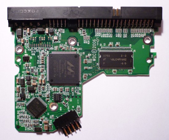

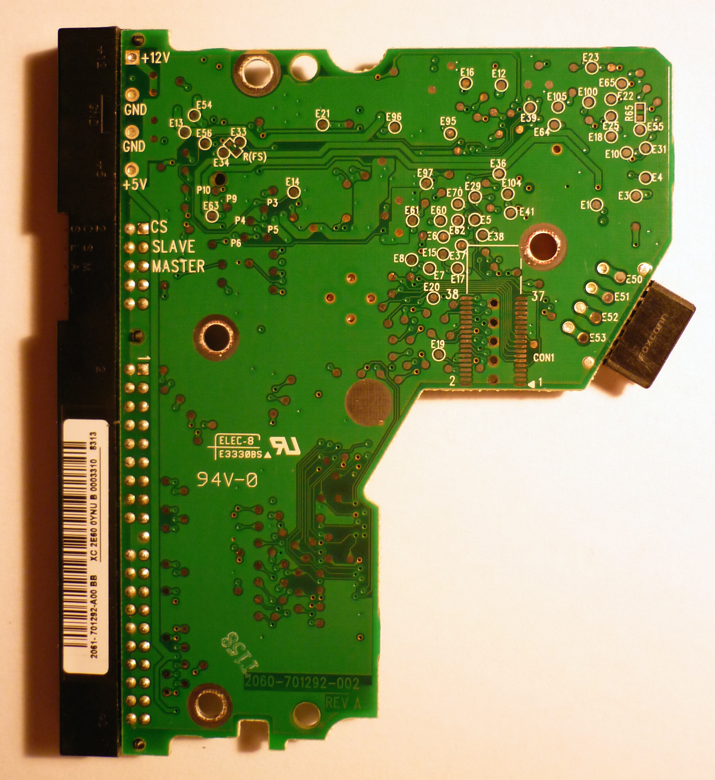

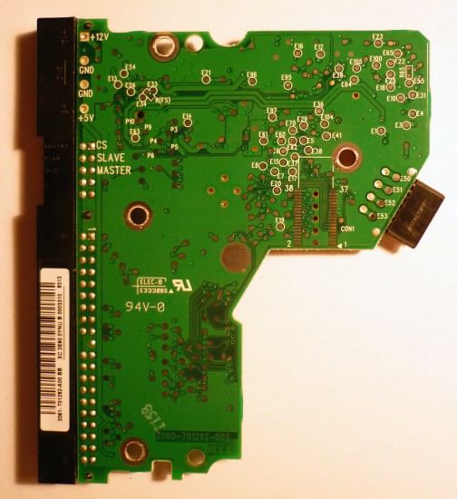

Donor:
WD400JB-00JJC0
DATE: 13 FEB 2008
DCM: DBBANTJCHN
PCB Number 2060-701292-002 REV A
MCU 88i6888-LFH1
SMOOTH L6283 1.3 (990SE VH)

 Post subject: Re: WD3000JB-00KAF0 PCB replacement
PostPosted: February 26th, 2013, 18:14
Joined: May 21st, 2007, 16:10
Posts: 1592
Location: Gothenburg/ Sweden
Spildit wrote:
I trully don't think it would work even if you swap ROM, but to be honest i don't think you will be able to swap SMOOTH chip also ..... It doesn't hurt to try, if you are able to swap SMOOTH, then you would be able to swap ROM without any issue just to test .....
If he swap SMOOTH, why should he then swap the ROM chip for?!?
I would say that you will have a better chance to success if you find a similar Pcb and swap ROM, rather then swap SMOOTH.
http://www.rescue-it.se
PostPosted: February 26th, 2013, 18:23
Posts: 927
Location: uk
Sorry to say but even if you manage to find a good pcb and swap the rom you will most likely find the drive will show all the signs of a damaged preamp as well (spin up, click click click and then spin down). Success is likely to be only 50 50% or worse.
PostPosted: February 27th, 2013, 4:50
Posts: 3551
I think swapping the SMOOTH chip is a waste of time. (but you never know).
I'd go for this http://www.ebay.de/itm/WD3200JB-WD3000J ... 4ac1a6e4a5
for 45 euros you get a compatible PCB, swap the U12 IC over and get your data.
(assuming preamp is ok).
Good luck!

I haven't had the time to do the smooth transfer to my drive's pcb but I replaced some QFP chips on older harddrives without much trouble. As for changing the pcb to a new one: the data on my harddrive is old and not of a value that would justify a 45€ replacement pcb. So I will stick to my two possibilities: 1) changing the rom to donor pcb and try it (chances are low because of the MCU not matching and the head-contacts on pcb show less pins than on my patient harddrive), 2) swap the smooth chip and let it run.
Two questions remain. Can anybody check the pictures of my patient pcb to look for some other obvious damages than the one on the smooth chip?
I couldn't find others, I already checked the TVS on (on Q3 & Q6 I think?!) but not sure about the values it should have.
Are there other possibilities of measure some components on the pcb to get an idea of what could be damaged?

if you use this donor pcb for your hdd, you will notice 2 things
1- donor pcb will get OVER HEATED - most probably will burn in less than a min.
2- this WILL NOT WORK
good luck
PostPosted: February 27th, 2013, 13:06
Posts: 2858
Carcassonne
Since you are from Germany (where i just came from few days back) and i really have a huge respect for the German Muscle (cars)
whatever is the case, back to the main subject which is yours here
this damn pcb 701314, is one of the Stupid pcb`s they manufactured
in fact, i have many cases before with the same pcb, and in order to get the data from it, i used 2 or 3 pcb`s
they Die Quick, coz the PCB gets over-heated quick no matter what cooling fan you use
and somewhere on the middle while copying your data from it, it will either DIE (pcb i mean) or Spinning resets (sounds like power off/on again)
so, i suggest really that you seek Pro. help specially on this model
otherwise, you will end up paying 5x the price for other problems which might happen.
and Good Luck again my friend
PostPosted: February 28th, 2013, 10:25
Posts: 927
Location: uk
I understand what you want to do but it does seem if you are trying to 'hit the hammer with the nail'. I don't think a pro would attempt this if data is at stake!
If you attempt to swap over the Smooth ic and you are successfull that would be great but what if on power up the unknown damage to other components on the pcb cause preamp damage when previously it was in working condition. Remember to replace the preamp would mean opening the drive and replacing the head stack.
I think your first step would be to find out if the preamp is damaged or not. And the only way you can test that is with a known good pcb. For a pcb replacement on this model you don't have to match the drive model number, just the pcb number.
